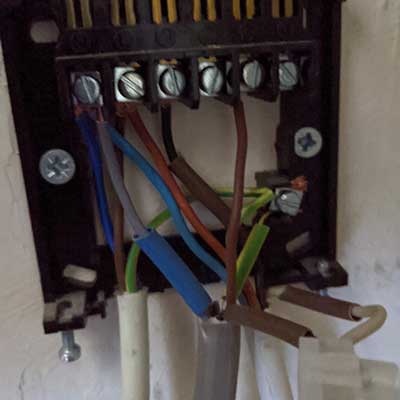

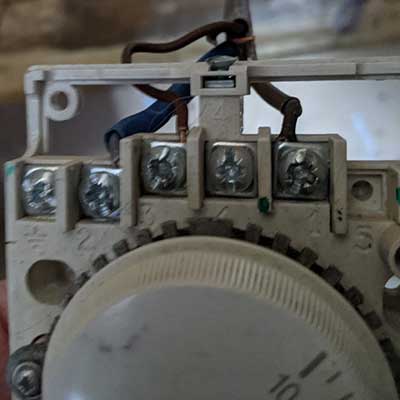

Right the first image is the old thermostat wiring
Terminal 2 = Grey Wire with blue shield goes to Neutral on the LP111 Board
Terminal 3 = Black Wire goes to Terminal 3 of LP111 Board Referenced (On)
Terminal 1 Black Wire with Brown Shield Goes is connected to a chock block that goes to a White wire with brown shield going straight to the boiler

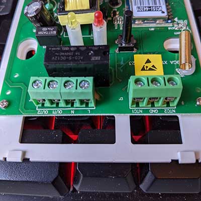

And this is the image of the Duostat
Correct me if I am wrong but I believe I connect the Live and neutral of the lp111 to the live and neutral of the Duostat

post pics of the duostat and the receiver you are trying to install, there are many different ones
Mount the receiver by the LP111.
Disconnect the old thermostat and make wires safe both ends.
Connect L in programmer to L in receiver, N in programmer to N in receiver, link L to out 1, connect the wire (to boiler?) in the connector to out 2.
Mount transmitter on wall where thermostat was and insert batteries.
Image 3 is the receiver (Is the duostat image important???)

I have 2 wires going to the boiler
1= Black with Brown Sleeve that currently sits on Terminal 3 of LP111 Called COM
2= White Wire with Brown Sleeve coming from thermostat going into the chock block
And what happens/do I need to do with the brown wire coming from the thermostat to Peg 5 (Image 2) of LP111 which is called ON
