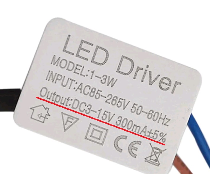

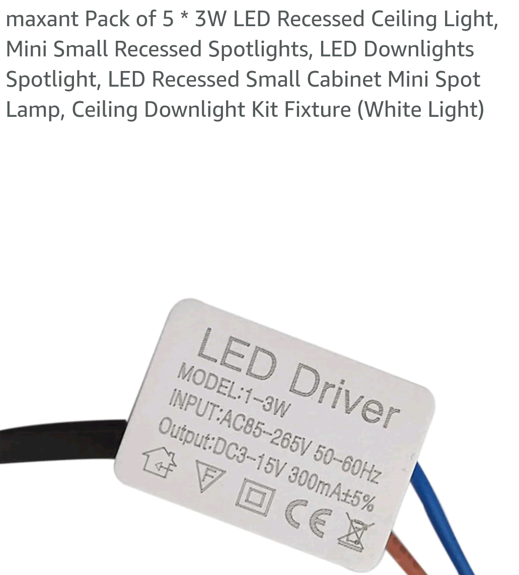

I'm wiring the ceiling in my shed/treehouse with led lights.

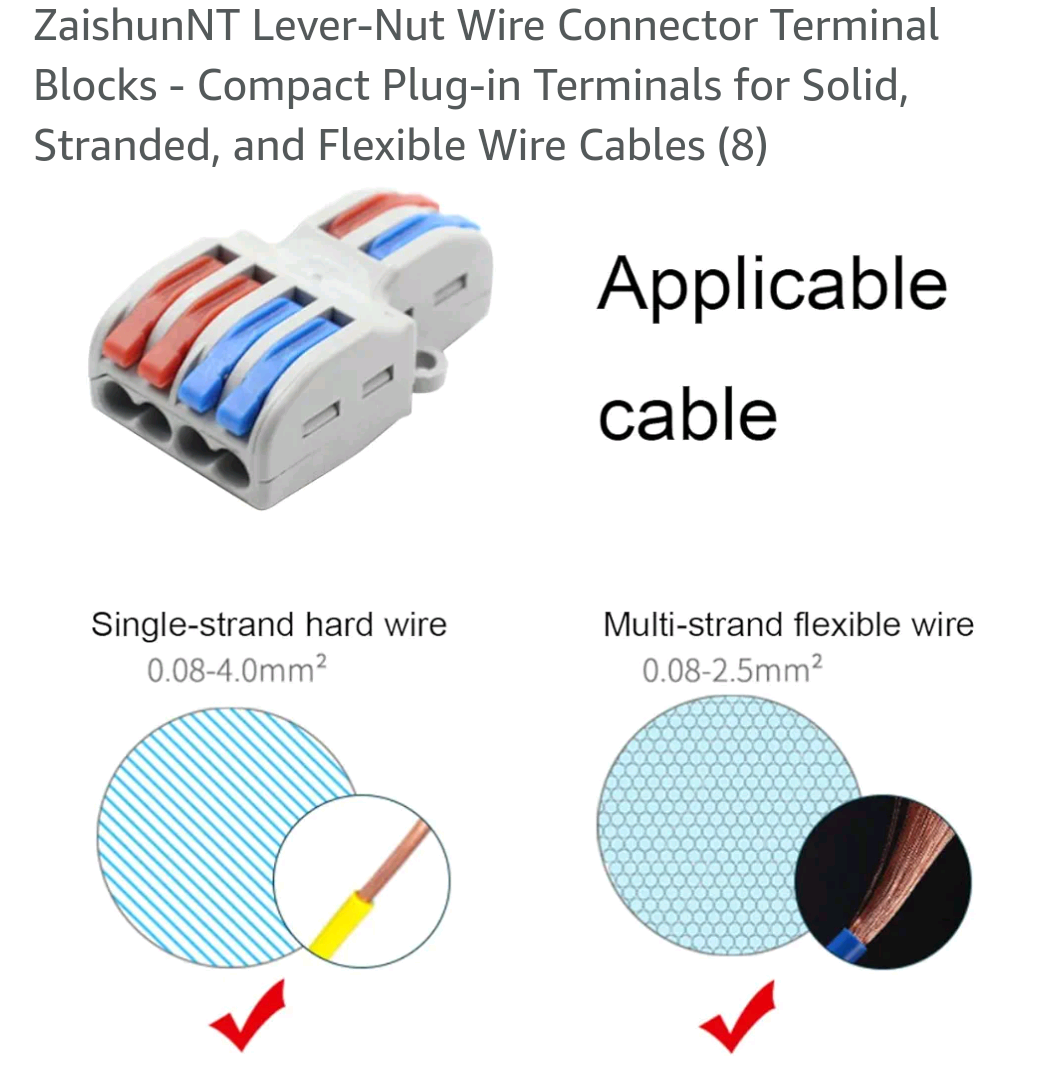

I'm wondering if I can join 4 led lights up in a circuit by just using splitters. They are all the same; 1 input and 2 outputs.
So after the first AC input I want to continue the AC power by splitting off and feeding each light in the ring of 4. So each splitter will have 1 AC in and coming out there will be 1 pair of wires to a light and the other pair continuing to feed the next splitter.
Does that sound ok?
I'll wrap with electrical tape when finished. They're only low power lights, 3w 300mA , each with a drop down transformer to DC.

For mains wiring, all connections must be inside an enclosure with no internal conductors on show (ie the outer cable sheath must fully enter the enclosure). So, those mickey mouse chinese connectors must be inside a box. You cannot wrap them in that sticky tape (that comes off after a season of frosts and sunshine).
I worry abouit the picture of the LED driver that seems to show the inners of a mains cable. That driver will also need to go in a box.

* I've just ordered some junctions boxes to house the connectors.

This driver will attempt to force 300mA through whatever is connected to it's output. It will alter the voltage on it's output to achived that 300mA current with a rated maximum of 15 Volts
5 white LEDs connected in series will require more than than 15 Volts ( typically a white LED require 3.2 Volts )
This driver may be rated at 3-15 Volts when in fact it can produce the 16 Volts or more needed to drive 300 mA through 5 LEDs and the resistance of the cable carrying the 300 mA
thanks but i'm not sure what that means?
i'm keeping one back as a spare so only connected 4 of these lights.
