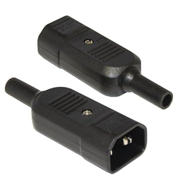

I use a 4 way extension lead, but i changed the plug for a short lead with an IEC C13 male end .
Then when i go away i just grab the relevant IEC C13 cable assembly with local plug, plug in and sorted. This means i can even use it in UK like any normal extension lead. E.G.
