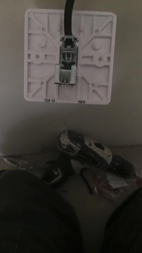

Hi Guys, just a small update, I lowered the height of the TV and used all of the suggestions here including the trunking and the brush plates, I'll post a photo later on but the room is now finished I just have to fit the TV onto the wall bracket and also fit the face plates but it's all looking great and I tested everything before the plasterer started plastering the room.
Tony
Finally completed guys, couple of photos for anyone interested.
The Ikea unit the TT is on is just temporary until we can source something more in keeping with the room.
Tony
