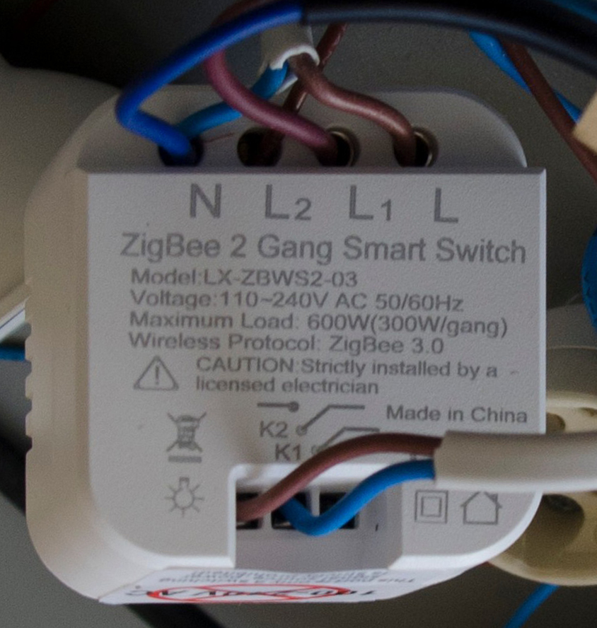

Thanks for the helpful replies. I decided to stick with the existing remote system. As I’ve converted to LED there will be no issue with the load on the remote. I therefore re-wired with a 4 core cable such that the on/off for the lighting at the remote sends current or otherwise to the light in the fans and the additional LED down lights. All seems to be working well.

Using a smart relay DSC_6061r.jpg you can even have your fan voice controlled. It has saved me a lot of wiring.
