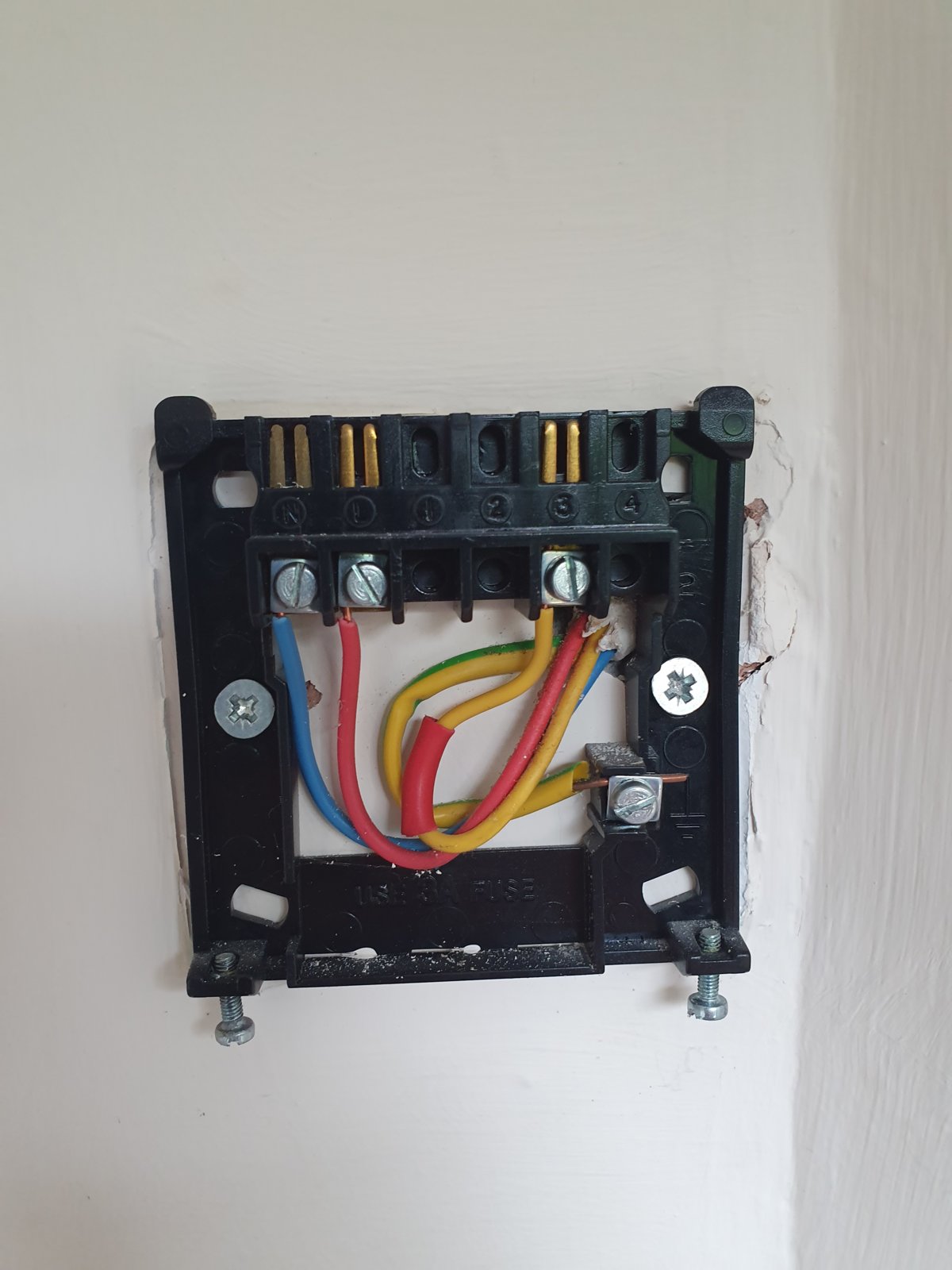

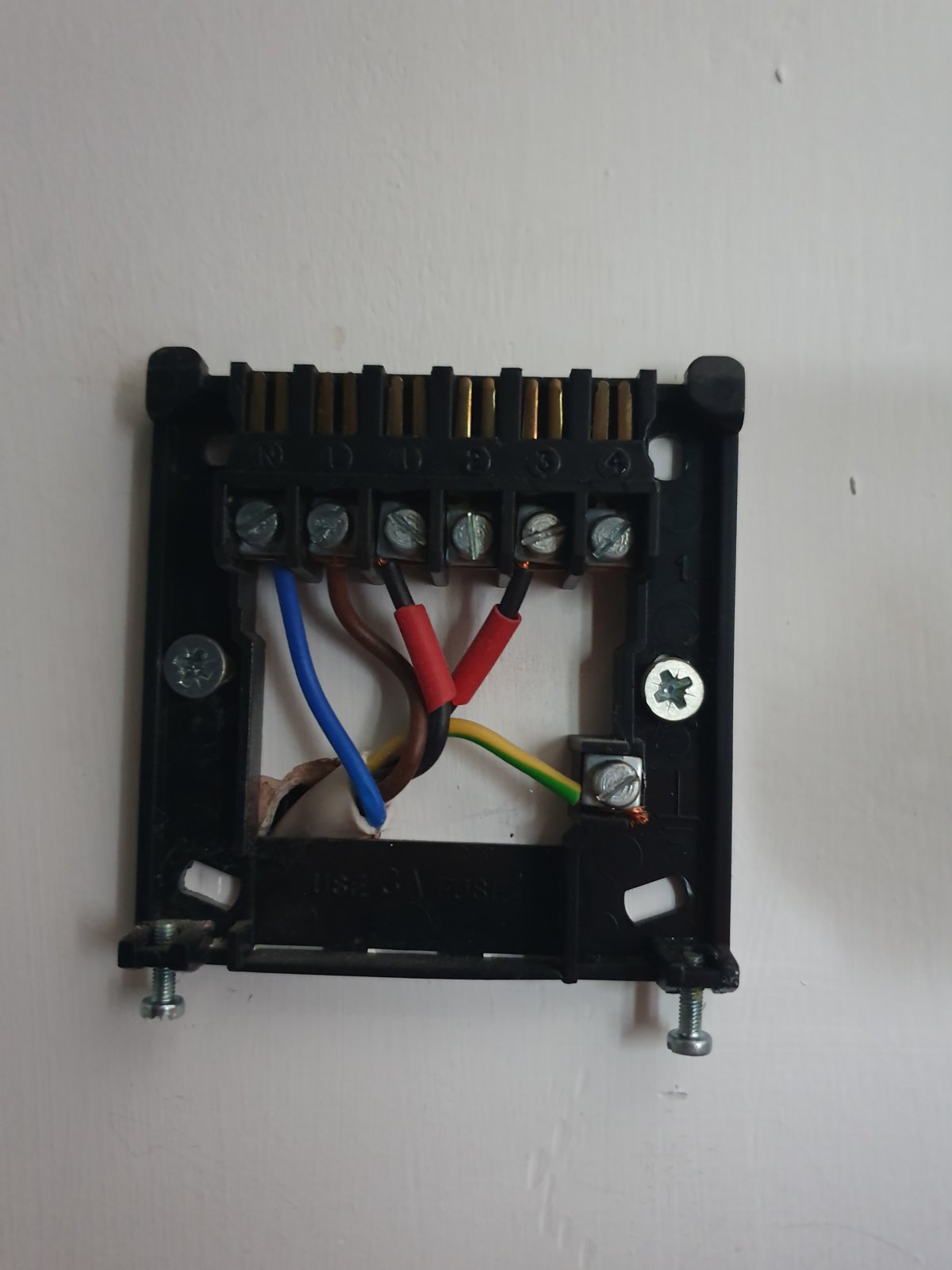

Just moved into my new place and the stat and timer for the central heating is on the blink. The original configuration was a RS1 Stat and an EMT2 Timer (both British Gas). Both are absolutely knackered and look 15 years old minimum. The timer light flickers on and off repeatedly very quickly as well as there being an audible clicking from the stat at the same time. Eventually after about 5 mins of flickering it dies until I switch the system off and on again.
I have replaced both components with new units which both fit the standard backplate.

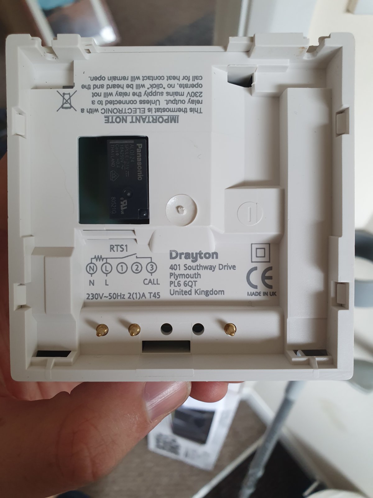

Stat: Drayton RTS1

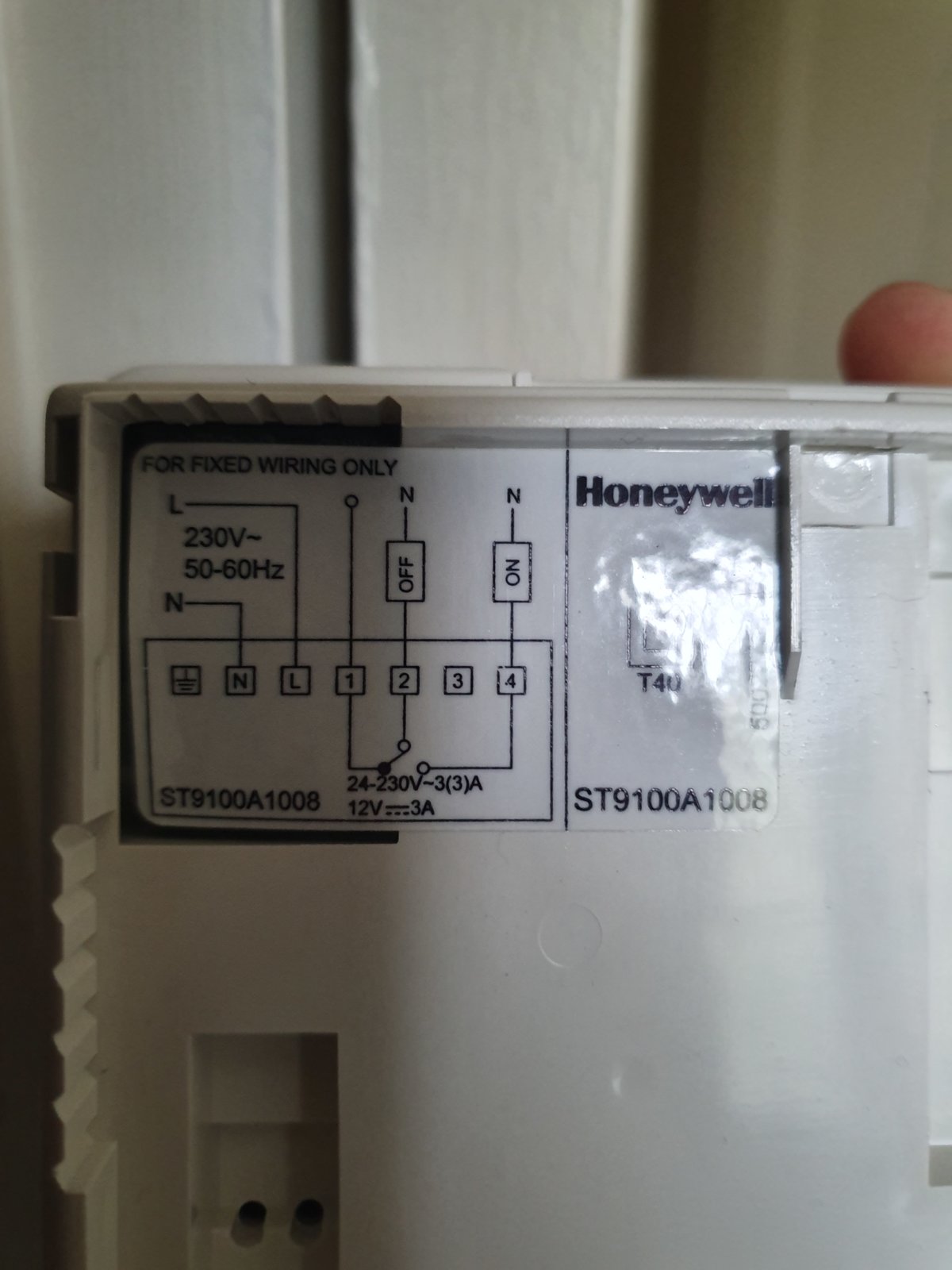

Timer: Honeywell ST9100A
Programmed the timer in and checked the stat temp was high enough to trigger the CH but nothing happens. No click from the stat at all.
I have taken photos of both component backplates to confirm if they are wired correctly... I think the previous tenants had smart systems and put the old ones back when they moved out as both units were very loosely fitted. Would anybody be able to confirm the wiring please?
Stat wiring and diagram
Timer wiring and diagram

Voilà! As you can tell, I am not one who usually messes with wiring. Thanks so much, everything is now working.
