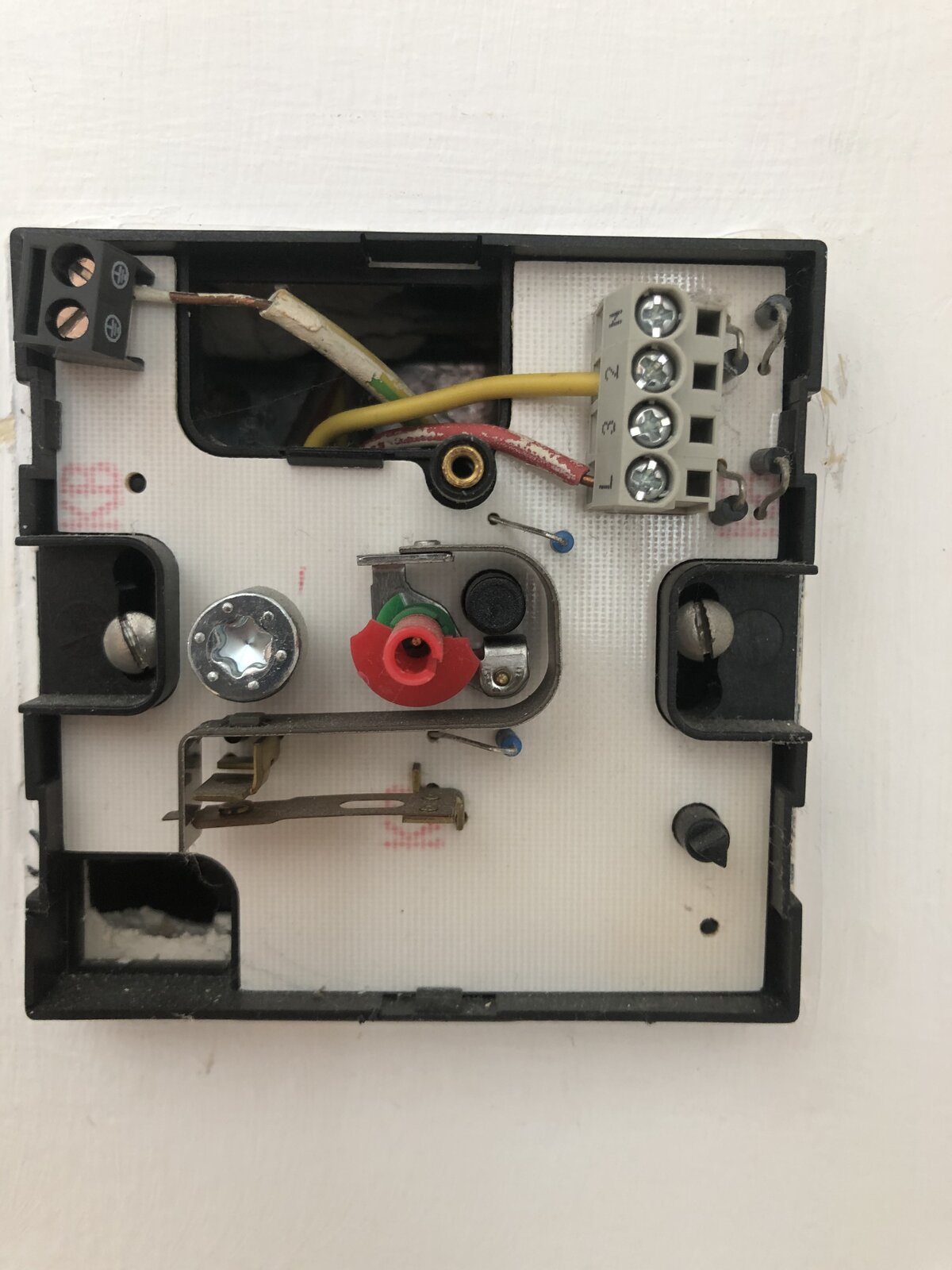

So after removing the RS2 thermostat, this is what I’ve got re wiring. I’m thinking installing a Nest e thermostat.
The earth is on the left but not sure about the other 2. I presume the red is the live but would’ve though the neutral would be in the N slot and not the 2 slot. Any help would be appreciated

Red and yellow wires in your pic , to Com and NO on nestE simple as that, isolate the earth Nest E doesnt need it but you will need it when putting the old t/stat back on

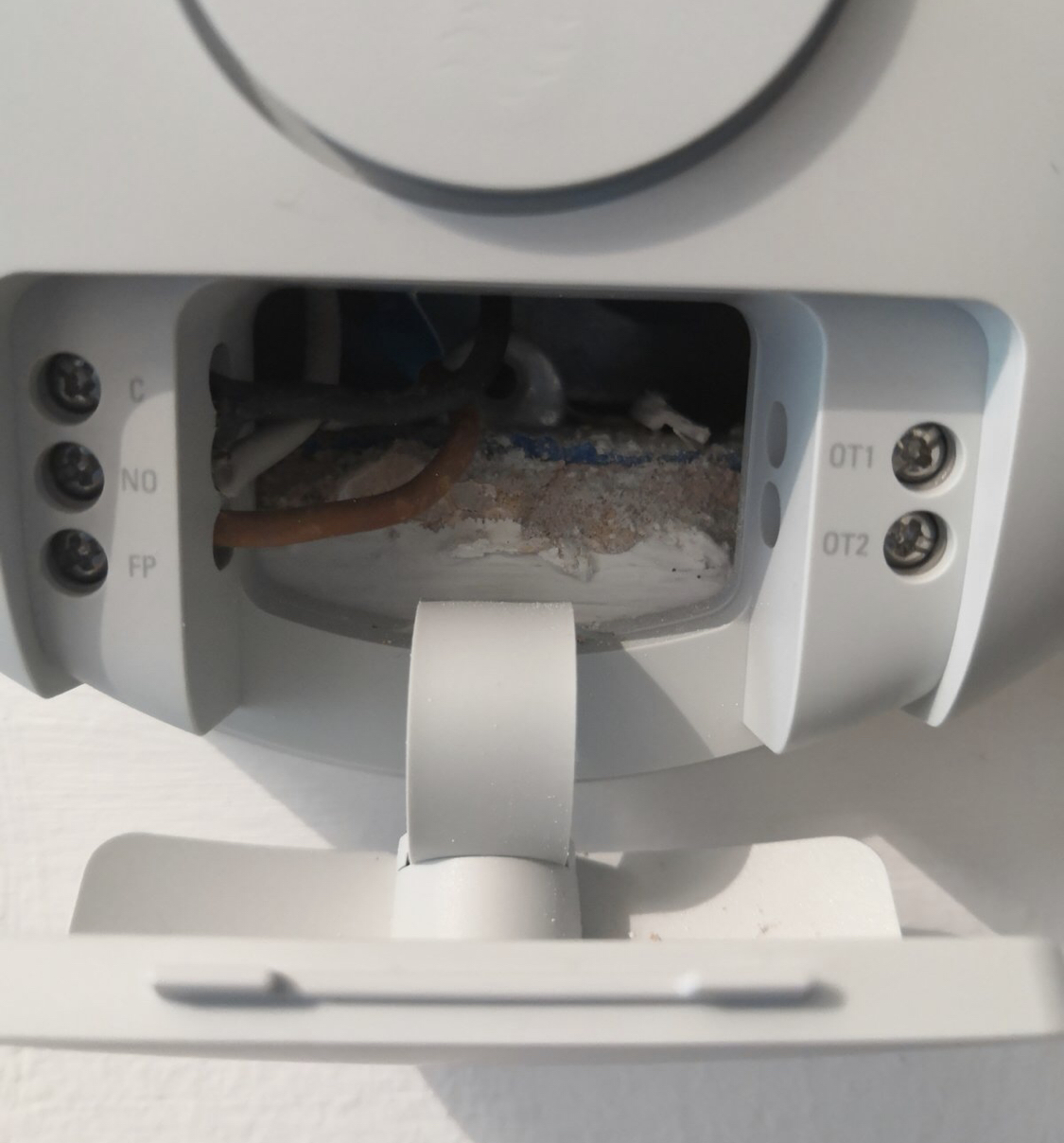

thanks. Which one goes to Com?

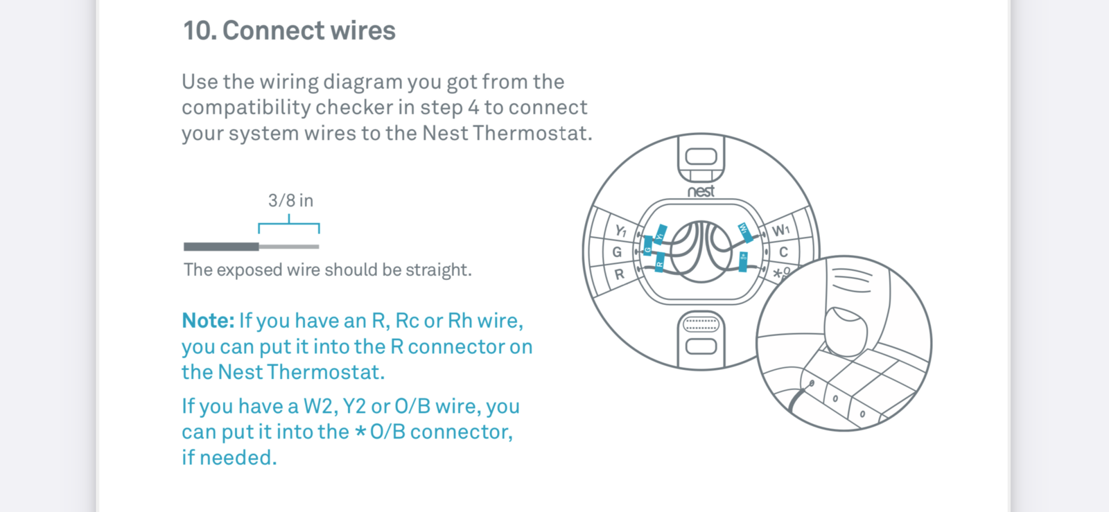

Found this online. This is the heat link rather than the actual nest thermostat.
Any idea which one to put the red into and which one for the yellow? thanks
