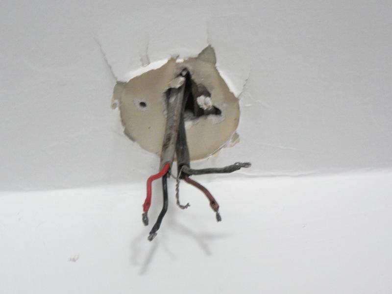

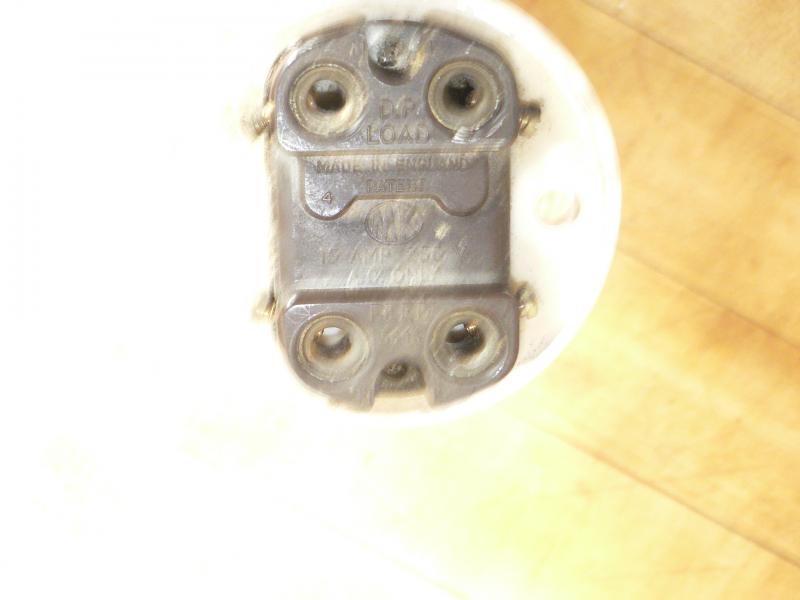

My old cord pull switch (for a light) has broken. The new one has a different set of terminals: the previous switch had two cables entering, each with live, neutral and earth, and 5 terminals: 2 live, 2 neutral and 1 earth. The new one has only 4 terminals: L1 L2 COM L and earth. I don't want to fuse the system, so which wire goes where in the new switch?

Thanks for the swift responses. Yes, it is simply a light switch (and not even in a bathroom). I hope the pictures are visible -- the upper terminals on the old switch are labelled 'LOAD' and the lower terminals are labelled 'FEED'.
In that case you can use the switch you've bought, as lights don't need double-pole switching.
But unless you have a multimeter you won't be able to confirm that red is actually the live conductor - it should be and almost certainly is, but it's not something you can just hope you're getting right.
And as Steve says, some of your existing wiring might be very dodgy.
more interesting is the signs that the screws were not making contact with the wires, rather just holding them against the back of the terminal hole.. ( screw marks are on the insulation on both red wires. )
Thanks to everyone for helpful comments: used multimeter, changed switch for double pole anyway, light works.
