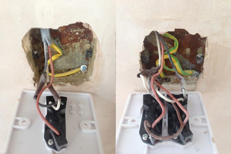

I’ve bought the LightwaveRF JSJSLW420 & JSJSLW450 to control the usual shared switch landing light scenario but I need help with the wiring and if it’s even possible…
We had a spotlight added upstairs to point to a painting, when the electrician did it there wasn’t enough space to feed another cable down to the switch so he fed it off the existing wiring (I think).
So all I want is the 1 gang dimmer downstairs to control the landing light
The 2 gang dimmer left switch upstairs to control the spot not effected the landing light
The 2 gang dimmer right switch upstairs to control the landing light.
What wires need to go where?
So as attachment:-
Left Photo = Downstairs switch
Switch to shared landing light
Wires fed from above
White to L1
Black to L2
Brown to L
Earth to box
Right photo = Upstairs switch
Left switch to spot light only controlled from this panel upstairs
Right switch to shared landing light
White to Left L2
Black to Right L2
Brown to Left L then wired back to right L1
Earth to box
Wires fed from below
White to Right L2
Black to Right L1
Brown to Right L
Earth to box
Wiring instructions for new switches
My thinking is the brown wire to L on both is my 'signal cable' as lightwave call it but which way round do the other wires go?
*edit just noticed wiring diagram was missing 'pointers' from pdf so added them
