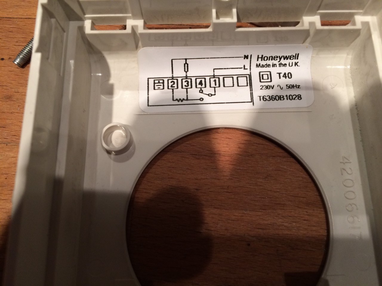

So I'm replacing my Honeywell T40 thermostat with a wireless Salus (RT310RF) version, but I just want to make sure I'm getting the wiring right.

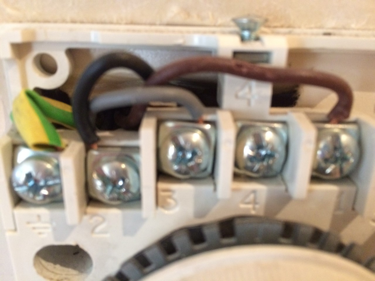

The existing wiring for the Honeywell is;
with the current wiring as below;

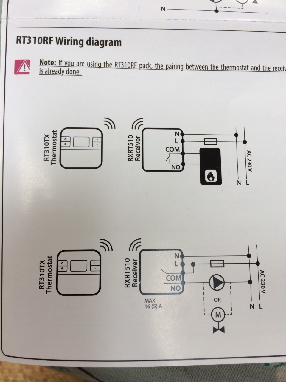

The wiring diagram for the Salus is as below;
So I'm just wondering how I would wire the Salus up, with the wires I have?
I have it in my head that on the Salus;
Black = N
Brown = L
Grey = NO
+ link from COM to L
Does this sound correct?

Ok, so I've finally got round to doing this! o_O
I wired up my Salus (RT310RF) as above, but it's not working :(
There doesn't appear to be any power getting to the unit, as the power LED is not lit (and the receiver is showing no 'signal').
Any ideas?
I changed to a digital stat. Got a local spark to do it in the end as i only needed 2 out of the 3 wires. He explain it to me and basically it's a light switch on or off as stat was run from the battery power. With you having a wireless reciever you need to power that with a constant live i guess.
