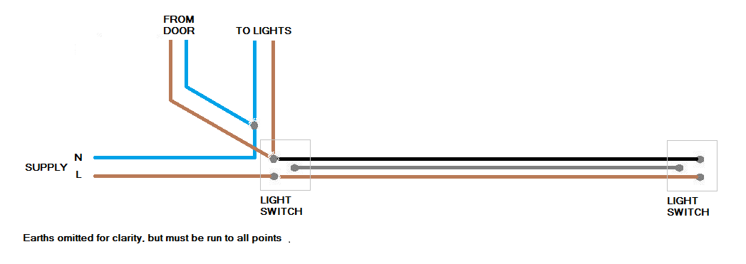

Another one about my potential garage wiring. My roller door has a courtesy light output, 230V 500W max. This isn't the exact model but it's very close http://www.linkcontrols.co.uk/files/LC-2308.pdf
I will be having 4 x 65W LED strip lights on 2 two-way switches, fed by an FCU off the same radial the roller control unit is powered by.
First question, maybe I'm being stupid but I don't have the knowledge to be sure of my own reasoning. Can I wire the courtesy light live and neutral straight to the LED strip lights? The idea being it wouldn't matter whether the lights were on or off when the door opens, they would come on anyway for 3 mins. In my mind the fact they're both fed by the same radial makes it ok but I'm not sure. Would I even need the neutral from the roller control?
Second question comes off the back of the first, presuming it is possible. It would be nice to know what is powering the lights. For example when the roller door is powering them, I could flip the switches as much as I like and wouldn't know whether I'd left them on or off until the 3 minutes is up. Is there a solution to this? Standalone neon indicators for the switches?
Maybe I'm off my rocker though and this is all BS!?

Yes.
Same circuit would be better - so that they could be isolated together.
Probably not.
If not, you could connect from the cable to one of the switches if it does not contain a neutral but it it likely will as you will be satrting from the same place for door and lights.

If you configure the switches so that the light is 'off' (even though 'on' from the door) when both switches are 'up' or 'down'.
That would require some device to avoid back feed from the door power to the switch wiring.
If looking at the switches is adequate, then probably not worth the bother.

Use one FCU - connect both the door controller and lights to the load side of it. Downside is that if the fuse blows then you lose both the door control and lights.
Another connection scheme I can think of is to use a changeover relay powered from the light output on the door controller. When not powered, it connects the lights to the switches, when powered on by the door controller, it connects the lights to their supply*. This allows door controller and lights to be on separate circuits (separate FCUs) with the relay providing isolation between them. It also means that when the lights are on due to the door controller, there's no backfeed to the light switches, so all the usual techniques (separate light not controlled by the door controller would seem to be one obvious one) should work to show whether the switches are on or off.
* Assuming the common 2-way setup with L1-L1, L2-L2, C-C, with L1 connected to L and L2 controlling the load, then the relay just switches the lights from L2 to L1 when energised. Leave at least one light directly connected to L2 and it'll show the state of the manual switches.
The backfeed is not a problem unless the suggested neon was used.
* Assuming the common 2-way setup with L1-L1, L2-L2, C-C, with L1 connected to L and L2 controlling the load, then the relay just switches the lights from L2 to L1 when energised.Leave at least one light directly connected to L2 and it'll show the state of the manual switches.
I don't see the advantage.

Similar to Simon I'd say use the output to switch a contactor and have the lights on a different circuit - that would avoid any back-feeding issues, and would mean that the lights could be used to provide light to work on the door if that was ever needed.
All makes sense apart from having an indicator on L2. If I have an indicator taking live from L2, then use a relay to connect L1 and L2, then surely L2 is energised and the indicator will be on regardless of the switches?
You missed the bit where the relay does NOT link L1 and L2. Instead of connecting the lights directly to L2, you connect them to the common of the relay contacts. With the relay off, the NC contact of the relay connects the lights to L2 on the switches so the switches work the lights normally. When the relay is on, then the NO contact connects the lights to L1 (L) so the door controller puts the lights on - BUT, L2 is still not connected to L1 other than by the switches so the switches, and any lights/indicators connected directly to them, will still work normally.
The slight downside is that unless you use a make-before-break relay, then there will be a very very short power interruption to the lights as the relay switches (if the manual switches are set to on) - but given this will be a fraction of a second, I doubt that it would be a problem.
