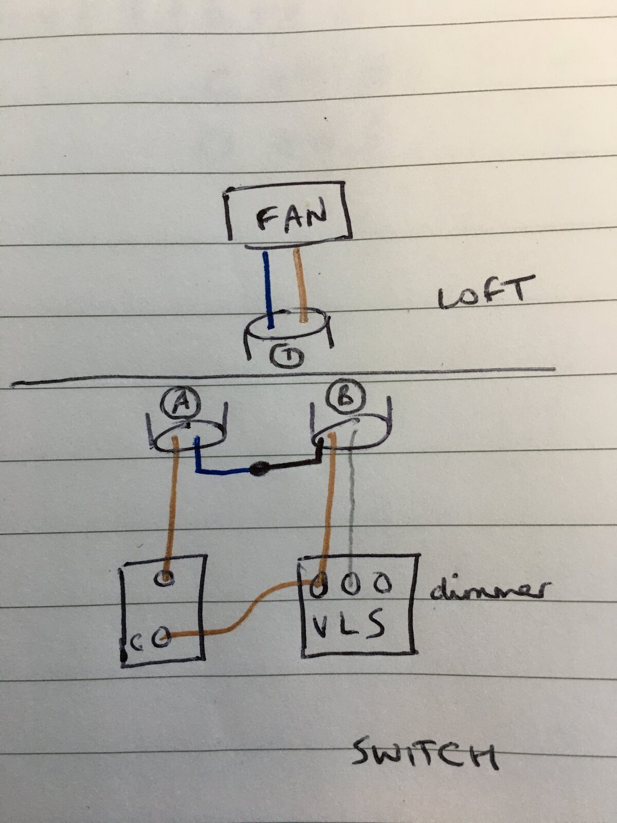

I am looking to add some smart elements to my domestic lighting. First task is to understand how things are wired. I have posted an image showing the wiring in loft and at switch and am hoping that I could get confirmation of my assumptions.
I think that:
loft wire 1 - switch wire c
loft wire 2 - switch wire a, b or indeed neither
loft wire 3 - switch wire d
Thoughts?

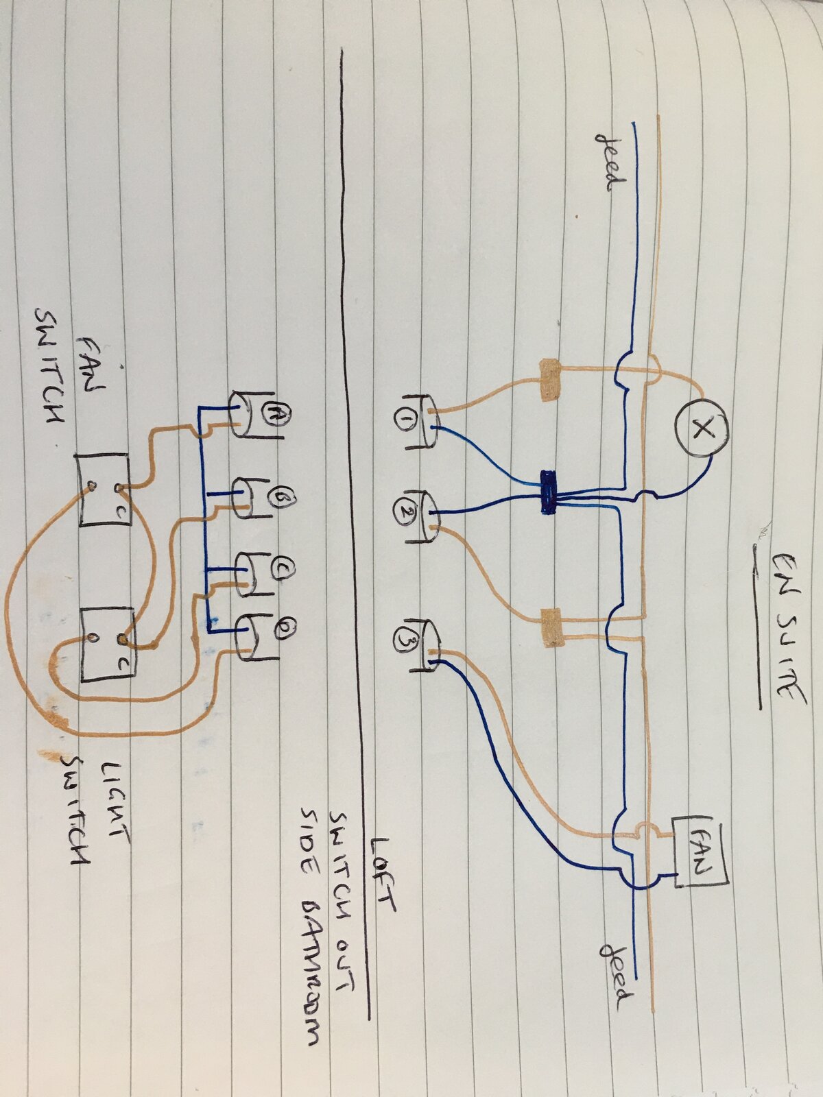

Another question if I may.
In the attached image, can someone explain why the V variable output terminal of the Danlers dimmer is connected to the adjoining fan switch common, rather than the L terminal on the dimmer switch?
Is this OK?
Thanks in advance
It doesn't matter; it is alternating current.
Not sure if it makes a difference with two-way switching.
Swap the wires if you want to.
Is this OK?
Yes, that also doesn't matter - for one way switches.
All a switch does is connect the two wires together.
The whole thing is a bit unusual, I'm guessing the fan may have been a later addition.
