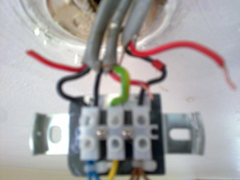

Trying to impress my girlfriend I thought I'd buy some spotlights from homebase . Everyone told me they are easy to fit :confused: . When I removed the old ceiling rose and disconnected the wires I was left with 3 mains cables coming from the ceiling. Each cable had a black(N), red(L) and an yellow/green(E). In one of the cables the black wire had a small red collar on (I believe) this is the switch. The earth in each cable is connected to one middle cable. I am now left with 3 red wires and 3 black wires(one with red band) and one earth. How do I connect thes wires to my recently bought shop spotlight which only has 3 openings on the terminal block.
Hope this makes sense, I would appreciate any help you can give me, thanks
I would use one of these:
One way or another, the black with the red sleeve goes to the L of the light.
The blacks will go to the N of the light.
The earths go to earth terminal.
The reds go together in a separate terminal.
If you have more than one light controlled by the switch, the red going to the other light will go together with the red sleeved black.
Hi Guys thanks for your help. This is were i'm up to. I now have 3 loose red wires. Can I connect these to a connector block?[/img]

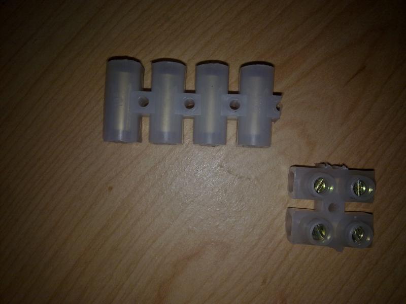

So one of those in the ceiling void to take the circuit and switch cables, with a cable running from it to the light would be useless, would it?
Care to explain why?
I would use a 15amp four terminal strip..
Presumably that would be just as useless?
Because it wouldnt be accessible without cutting a huge hole in the ceiling, that wouldn't be covered by the light.
Recessed downlight yes, prefect.

If the switch only controls one light, put all the remaining reds together in a separate piece of connector block.
Yes, put all reds in a separate connector.
Are these connectors any use? If so where do the red wires go. Do I need a 3-way connector
Cut one of those into a single connector and put all the spare reds you have into that.
