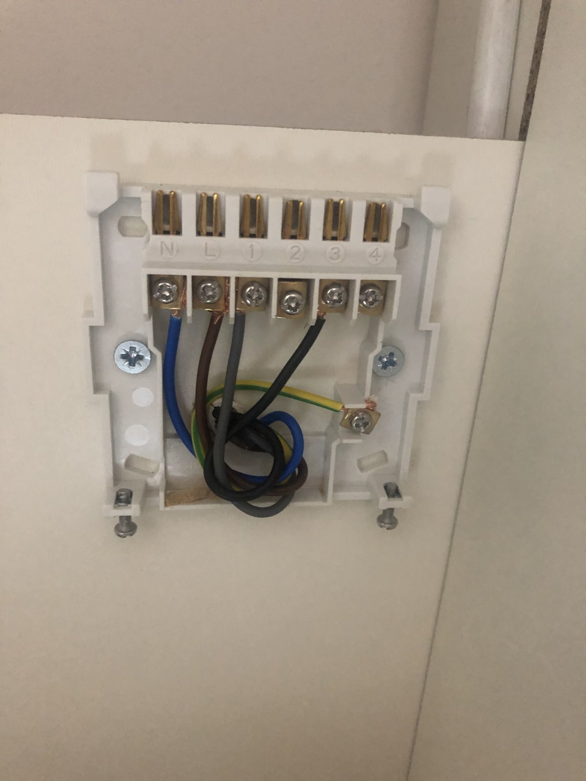

Hi,
I am wiring a new Hive system to my Ideal combi boiler. Our house has two thermostats, downstairs (that we want to use with the Hive) & upstairs (that will remain a wired thermostat).
I have wired in parallel the Hive receiver across the thermostat terminals and disconnected the old downstairs thermostat. The boiler does not put on the heating. I have T1 to 1 side of room stat connections and T3 across the other.
Any help will be appreciated.
