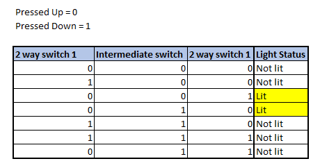

Although I made sure to wire the 3 switches (2 x 2 ways and 1 intermediate switch) the same way as they were before, it looks like I made a mistake.
The light only lits in the following 2 scenarios:
Do you think that inverting the Live and Neutral on 2 way switch 1 (ie the first of my 2 way switch) would fix the problem?

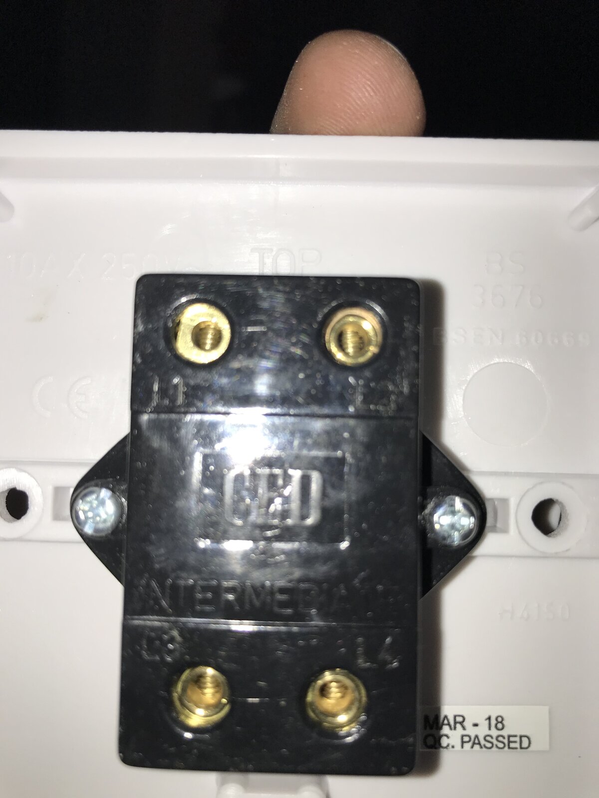

Below is the photo of the first 2 way switch:
Below is the photo of the intermediate switch:

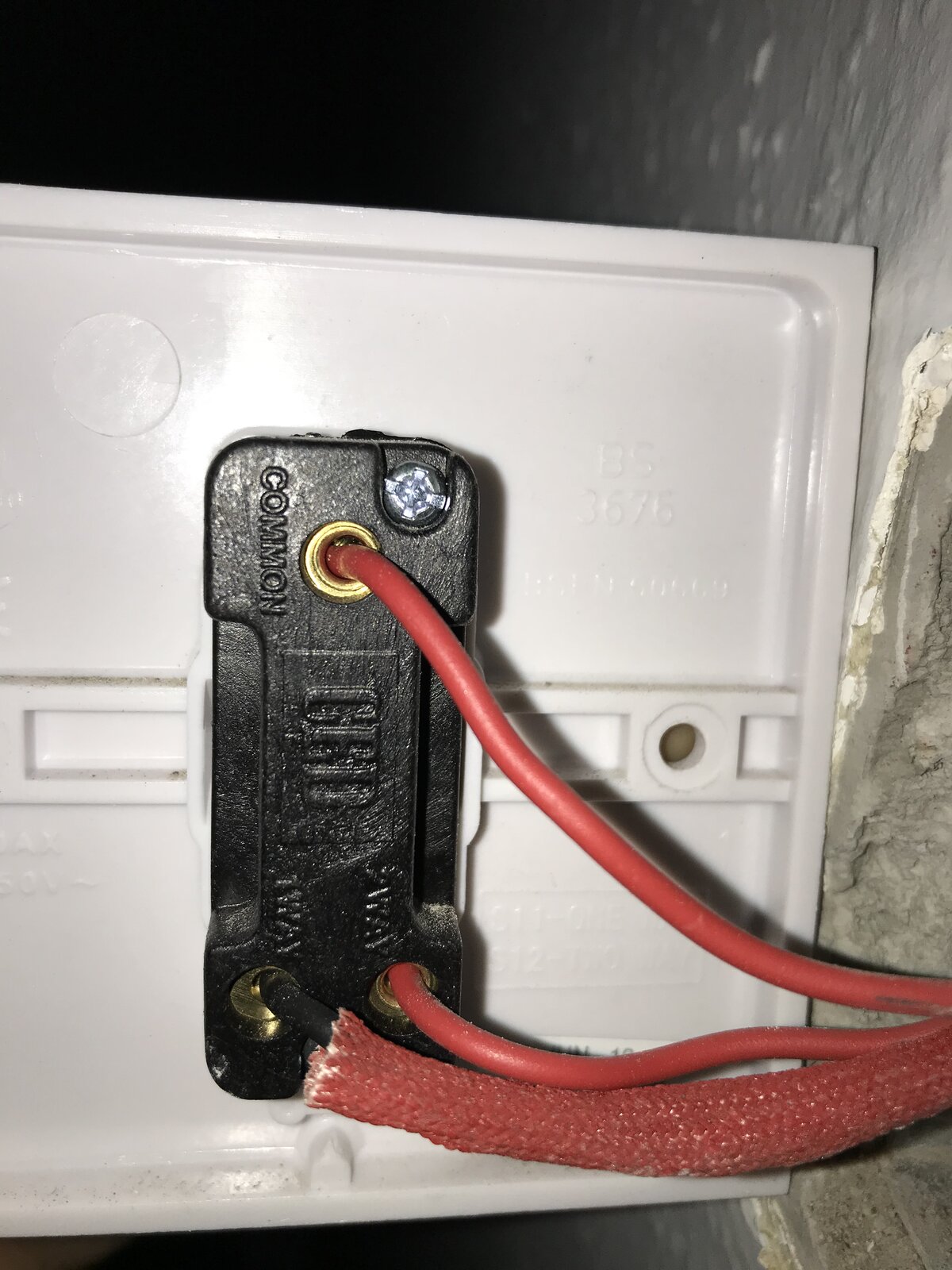

Below is the photo of the 2 way switch 2:

If we had pics at a different angle which included the wires going into the grey sheeth we maybe able to spot the problem.
Basically a red and black next to each other should go into the same grey sheath.
Ok, basically the red and black coming from the same sheath plug into pin 1 and 2 of the 2-way switch, then the remaining "standalone" wire connects into the Common pin, is that right?
To make it less complicated do away with the intermediate for now, join red to red and also join black to black, then you have just 2 way, get that working first then refit the intermediate later.
Andy & EFL, you were spot on, had to swap the red wires around from the single 2 way switch, now the red and black from the same sheath are connected to 1 and 2 of the switch.
