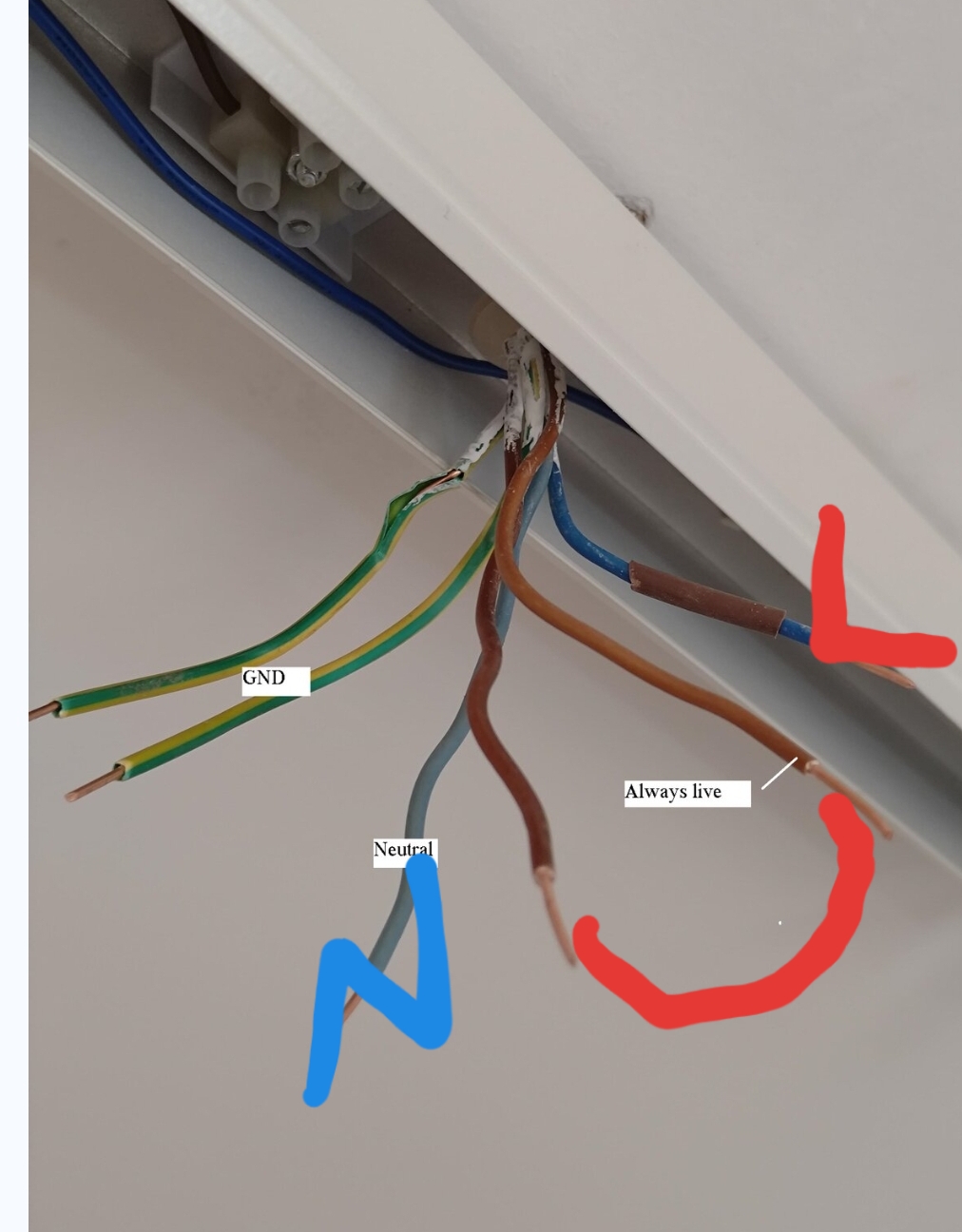

Hi,
I've redecorated my kitchen, and changed the light fitting from Fluorescent to led.
The new fitting connection box has 3x connections Live Neutral and GND.
It's been a long time in between, and I'm not 100% sure how to connect.
The fitting is controlled by a 2x way switch, and when testing, I found one brown wire live, and a blue wire with a brown jacket.
Either switch didn't change anything on any of the wires, and I thought that it should do.

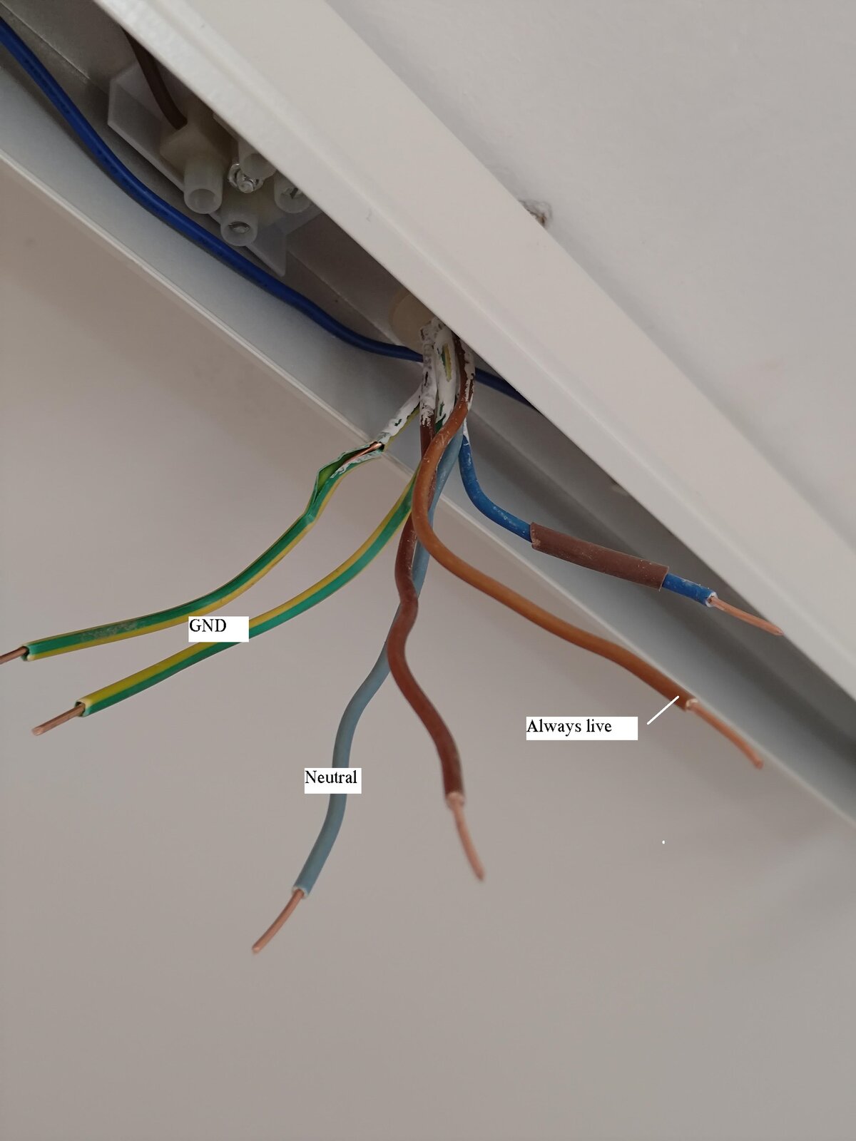

Here's a photo of the wires, can someone tell me which is which please?
Cheers, Camerart
Blue with brown sleeve to live (switched live)
Blue to neutral
Two browns joined together in a connector block and not to the light
2 x green and yellow to earth
Hi P,
I was being careful, and saw the Blue with brown jacket now switch with both switches.
Then I switched the mains off again to connect the blue/brown into the fitting, casually testing it with my screwdriver light, and it came on.
My kitchen is in 2x halves, and uses 2x different mains fuses. Lucky I checked!!
Anyway, it's all working, thanks.
