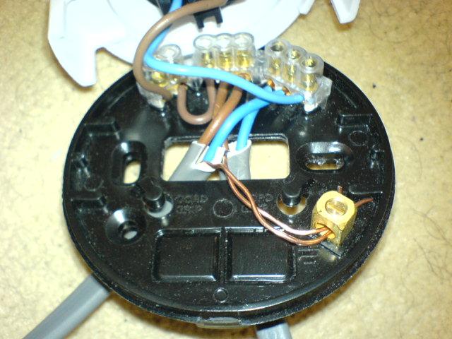

Can anyone please check my attached diagram to see if i have the right idea about wiring them correctly. I hope the diagram isnt too odd but it shows a cable coming from the fusebox to a switch then through each of the holders. This would only be a temporary wiring setup for the loft with 3 lamps (40w each) being switched on and off together from one end. I want to wire in parallel as opposed to series because i dont wish to add separate switches to each lamp. Also it means if the first lamp dies the other two will still light up. Would this work and should i make any changes? thanks

Thanks for the responses.
Ive tried the wiring out with some t&e as a test run. Not in the loft just on a bench at the moment and its working. Can anyone have a look at my earthing for the socket below. Ive just connected both earth wires to the terminal. I want to make sure they would be safe before i begin installation in the loft just in case anyone touches the lamps when they are on. Is this ok apart from the earthing sleeve (I will get some for the final install)? thanks
The wiring will work. How do you propose to wire the switch, which will have a COM and L1 terminal?
You MUST sleeve the cpc / earths.
Look at the Wiki- Electrics- Uk - Lighting for the nice basic diagrams for wiring lights with the switch shown.
