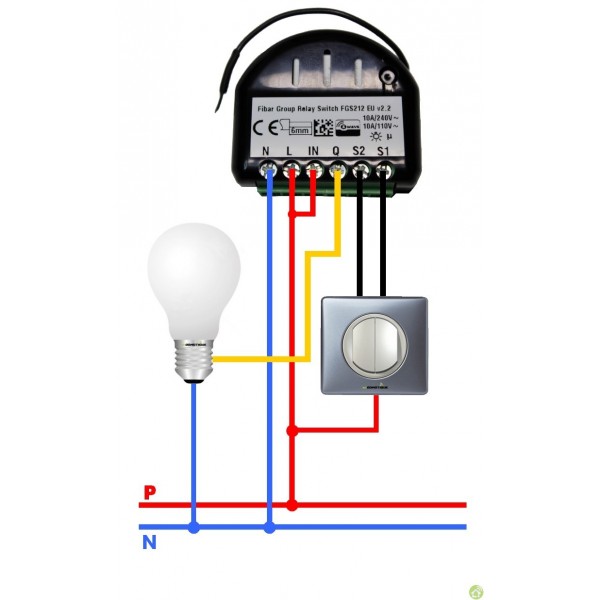

I'm on the verge of sending this back as I am convinced its faulty, however I just wanted to check this through with anyone else who may have used these.
Below are the instructions from the manual:
As you can see below, I have wired this in the correct way (im 99% sure)

I am a bit baffled on how to hook this up now as obviously the Fibaro module is not a BG Momentary switch. The way it works is:
L & N - Live for the module
IN - Live feed for the pump
Q - Live feed to the pump
S1 - Switch control
Basically it allows you to control the appliance (pump) remotely from your phone or via a momentary switch.
Has anyone got any suggestions, or maybe something for me to look at if I have wired it up wrong?
The instructions for the BG switches are irrelevant for this application.
The external switch is just a momentary switch connected between S1 and L. Momentary as in you press it to operate, and it returns to the open position when you remove your finger from it. Often have 'PRESS' printed on the front of them and may also be called retractive switches.
Other than the wiring as shown in the diagram for the device, you will also need to connect it to the network etc. before it will work.

Its the FGS-212 Relay Switch Module. The way it is currently works is that when the button is pushed, it disconnects.
There are 2 push button, momentary or retractive switches so ypou will need to change the switch.
It is very probable that the fgs212 act on change of state of the switch ( from ON to OFF or from OFF to ON ) and not the steady state so momentary switches are necessary.
Pressing one switch will switch Q to Live (ON ) and pressing the other switch will turn Q OFF
OK so its "working"
I seem to have to push the switch numerous times to get it to toggle. Nothing wrong with the connections as have tested and works each time. Likely something up with the module itself then! Gah
