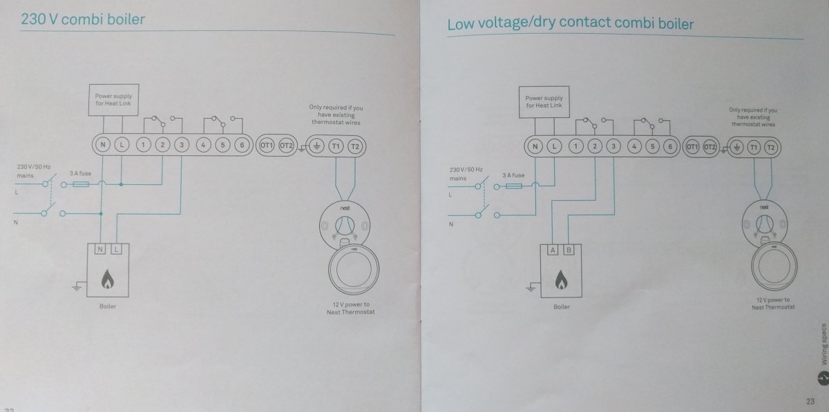

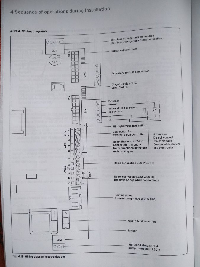

Basically I need to wire a 3rd generation Nest Heatlink to a Vaillant EcoTEC 937. Could someone please relate the Nest instructions to the boiler wiring diagram for me? I'm not sure which Nest instructions I should be following, the left (230v combi) or the right (low voltage combi).

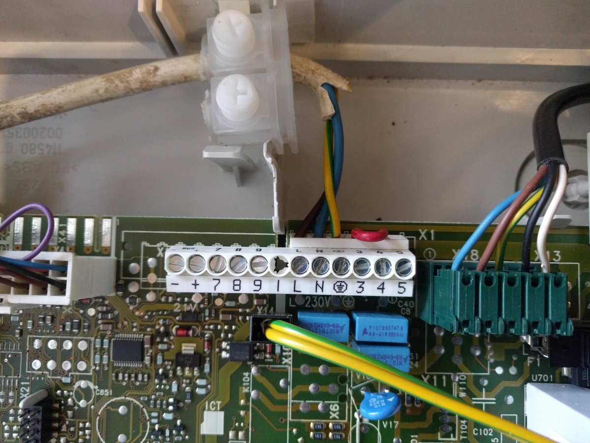

Also when wiring in the power to the Nest unit is it ok to run it from the power cable connection off the circuit board?
