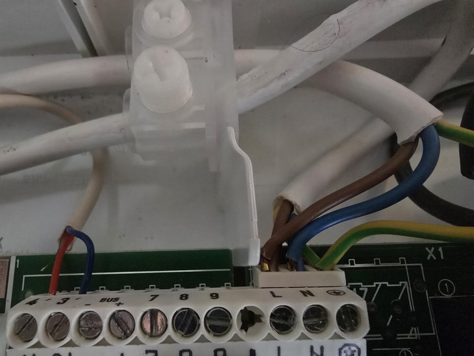

I'm trying to connect it to the Vaillant ThermoCOMPACT VCW 255/4 E VR Combiketel 12,8 - 24,4 kW CW3 closed Manual: https://www.vaillant.nl/pdf-neu/thermocompact-vcw-255-4-en-cwk-245-4-144564.pdf

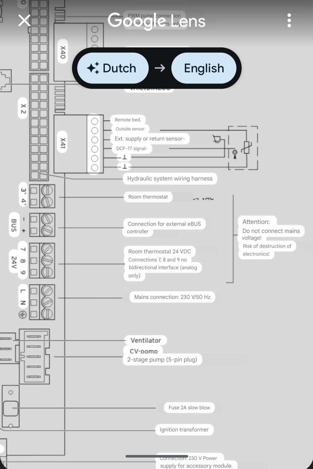

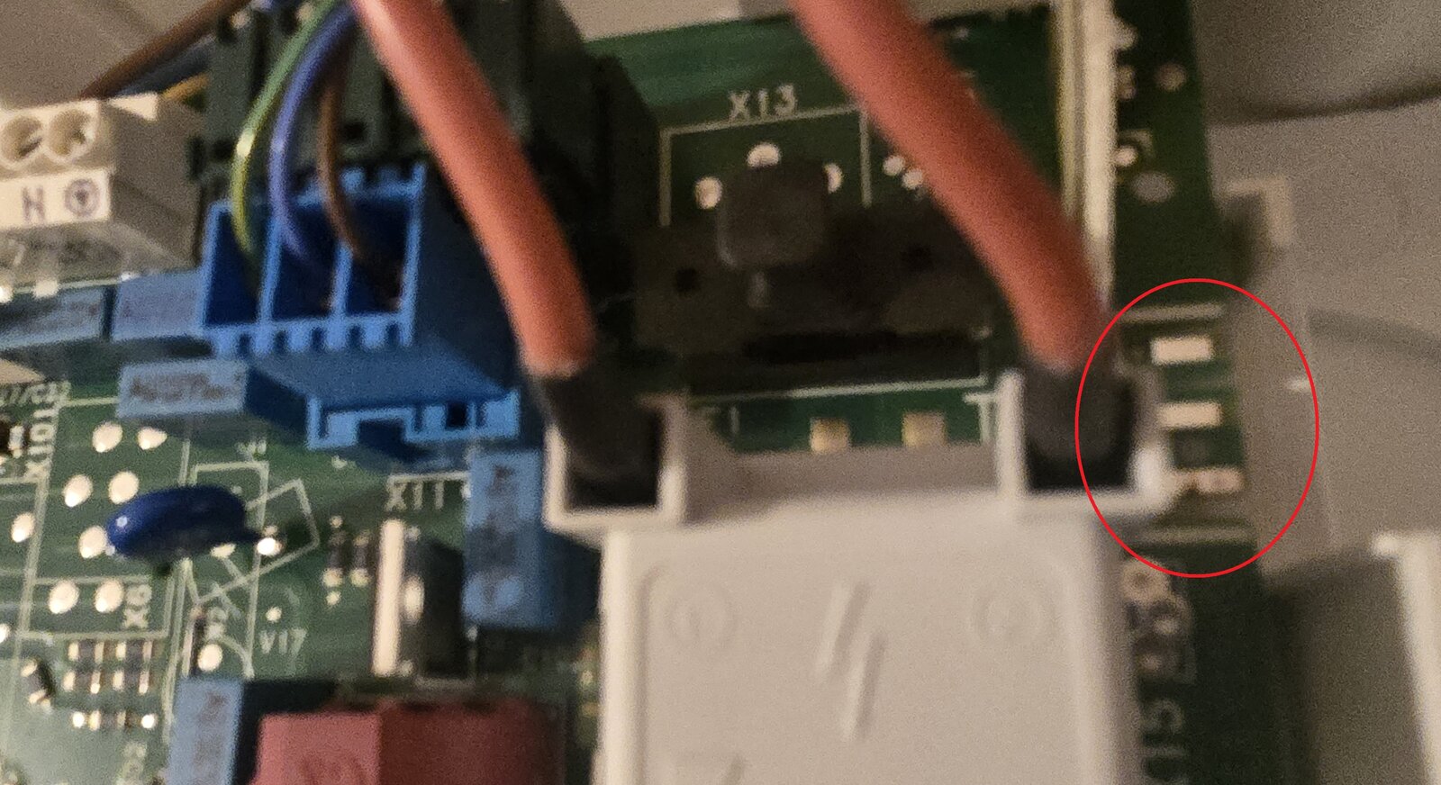

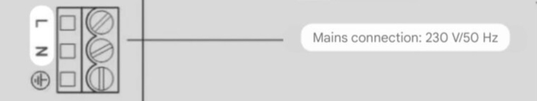

First thing that goes wrong is that there are no 230V L/N connections on the boiler panel. No RT connections either. Only 24VDC room thermostat connections at the numbers 7, 8 and 9, and 24VAC room thermostat connections at 3' and 4'. There is an 230V X12 at the bottom for "an added module" but it would require soldering.:
Thermostat connections:
I did my best attempt at wiring it, however, in the way it makes most sense. I wonder if it's just not compatible at all.
Here is my attempts:
Boiler unit, left to right.
REDWIRE1 connected to 4'
BLUEWIRE1 connected to 3'
BLUEWIRE2 connected to 7(24V)
REDWIRE2 connected to 8(24V)

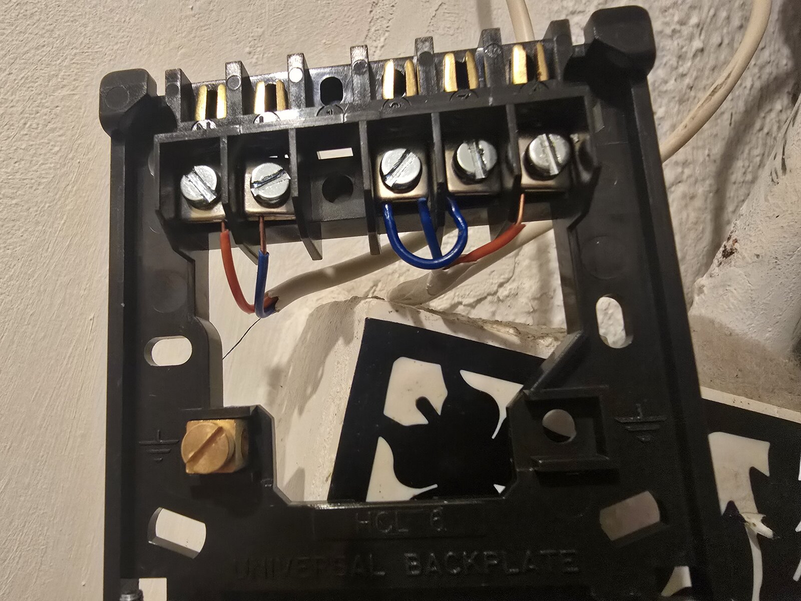

Thermostat unit, left to right.
REDWIRE2 connected to N,
BLUEWIRE2 connected to L,
BLUEWIRE3 bridged between 2 and 3
BLUEWIRE1 connected to 2

Your wiring is partially correct.
Terminals 3' and 4' on your boiler would connect to the volt free terminals 2 and 4 on the HRT4.
There shouldn't be a bridge wire - leave this out.

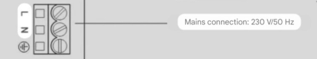

The HRT4 is designed to run from an AC power supply of between 50V and 230V. It may not operate correctly, when supplied with only 24V DC.
You do have 230V on the panel - it should be possible to connect another cable, with wires joining into the existing L, N and E terminals....
Although I would add that the wires you are using, appear slimmer than I would like, to carry 230V - a 0.5mm2, or 0.75mm2 three core flex, would be far better for powering the HRT4.
Please ensure that the mains voltage wiring is kept apart from the 24V wiring, or an expensive repair to the boiler PCB may be required!
The amount of bare copper showing on the wires going into the HRT4 backplate terminals, should also be minimised.

Okay, this is the end result. Can you double check if it's safe to turn on to check if it works?
