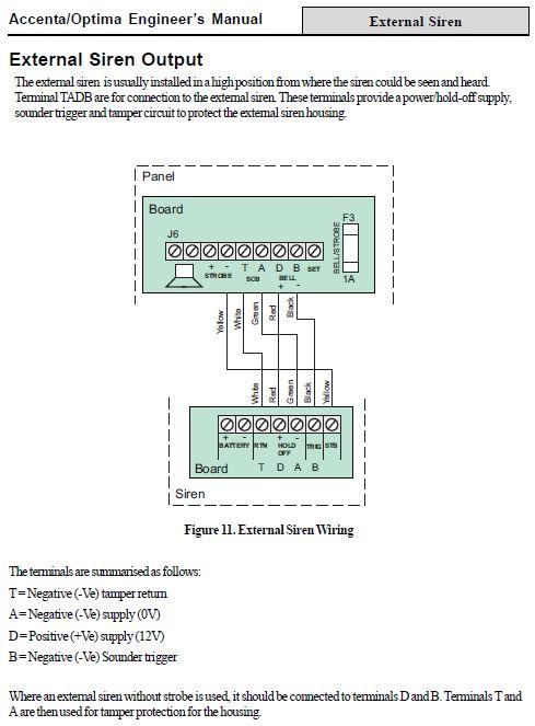

I'm having problems wiring the Honeywell Internal Siren MS=N to the Accenta panel. The installation guide shows how to connect an external siren, but my Internal Siren has different markings on the terminals...
Please see attached images.
Any help would be much appreciated. Please note, I'll be using the Internal Siren as the only Siren, NOT in addition to an external one.
Taking a guess, but assuming they are -ve applied triggers...
Tamp...T
Tamp..A
+...D
HI..B
Leave Lo unconnected.

Based on the diagram, would I be able to have both the External and Internal Siren? How would this affect the Strobe terminals being used for the tamper functionality...?
Two external ones would be probably easier.
Errrrr the strobes have nothing to do with the tampers.
If you cannot read the wiring diagram concerning strobes you should not be wiring them as they contain high voltages if misused.
Sorry, maybe I wasn't clear enough. I was refering to the manual (see above) which states "Where an external siren without strobe <or internal as in my case> is used, it should be connected to terminals D and B. Terminals T and A are then used for tamper protection for the housing."
So my question is can I have both an internal siren without strobe and an external one with strobe connected at the same time?
Thank you for any advice.
Wire the "external" as shown, even if you use the wireless converter.
Then use the panel tamper for the internal sounder.
Also for the internal use the D for the + and the B for the high.
Forget the byeline at the bottom of the diagram.
Yes, then you know for sure if you have a bell tamper or an internal one. If you get one.
Thank you both, josh451 & Alarm for all your help. Thanks to your help my alarm is up and running as of today. Will add the external siren in the near future.
