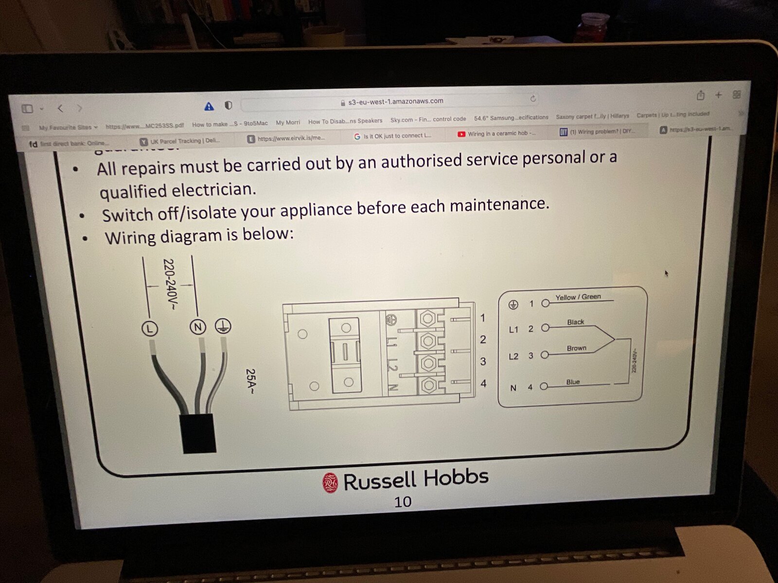

Hi Guys: Just about to replace a Stoves ceramic hob with a Russell Hobbs version. Both are NON-INDUCTION.
I see on the wiring diagram for the new unit that there are 4 connections - L1, L2, N and E. The N and E are easy enough but the only time I have come across L1 and L2 has been in. lighting wiring. The instructions show brown wire to L2 and black to L1. I am pretty sure (before disconnecting the old Stoves model) that there are only the three wires - brown, blue and green/yellow on the existing feed cable. Will it be in order to just connect brown to L2, blue to N and yellow/green to Earth.
Your comment would be most welcome. TIA
Show us the wiring diagram. You may need to link the two live terminals ,but we need more information, preferably pics of the actual terminal block in the hob .
What kilowatt rating is your new hob ?
I would suggest L1 and L2 go together, that is normal for UK use. In EU they have 16A circuits hence the two lives, one per 16A circuit.
Do you have 2 wires for neutral as well?
Hob is 6Kw

No wiring diagram and no pics ,but duplicated info.
I've taken a photo of it but still cannot get it to add in to my post. New Hob arrives tomorrow. I will photograph and post then.
L1 & L2 need to be linked. There is very often a " U" shaped piece of copper supplied with the hob ,that you fit into those two terminals, sometimes it's already in place. Hence the request for a pic of the actual terminal block.
terry plumb: Many thanks. I will post a photo of terminal block when the hob arrives today.
Hi Guys. Hob arrived today. No 'Terminal Block' as such. Cable attached with four connections - brown & black, Blue and green. Simply connected to a junction box with existing wire (which is connected to 'Big Red Switch' and all working fine.
Many thanks for your input. As ever, much appreciated.
Sounds straightforward enough.
Join the black and brown from the hob flex to the red (or brown) from the switch.
Join the blue from the hob flex to the black (or blue) from the switch.
Join the green and yellow from the hob flex to the green and yellow (or green) from the switch.
Worth checking that the junction box is heavy duty enough for the current (needs to be capable of handling 6mm cable, and 32 Amp rated. Post a picture if dubious.
