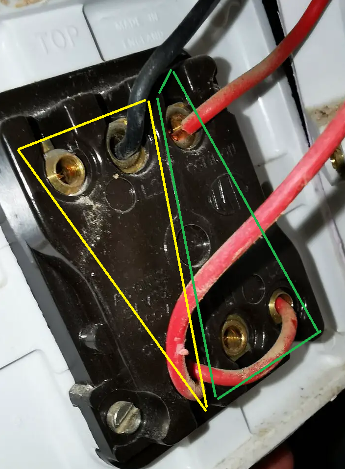

Wiring question
For an on/off switch it does not matter if permanent line is com or L1 the same with switched line, either way around will work. Selecting L1 or L2 will change if switch up or down for on.
The terminals of the two switches are arranged as two triangles and not as two straight lines
