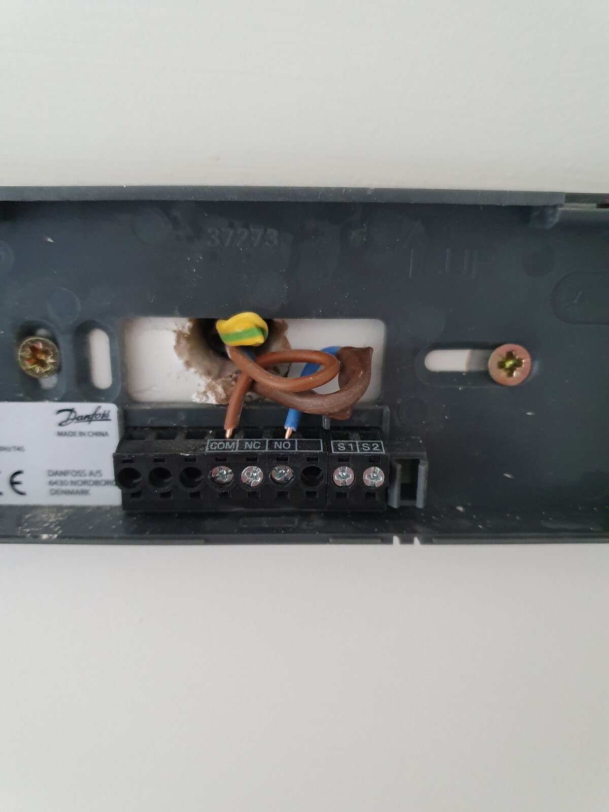

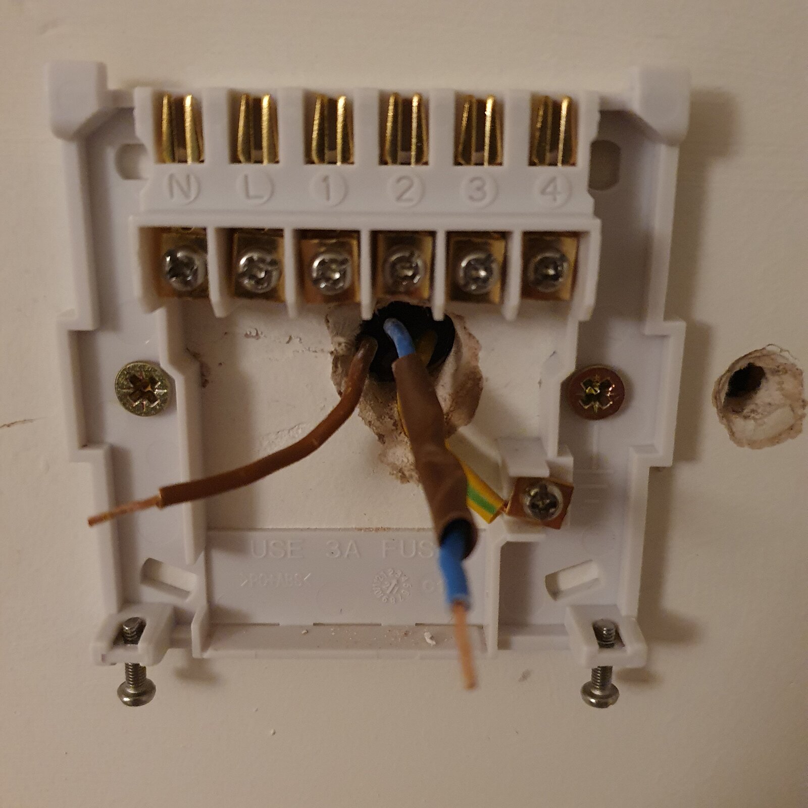

My mate and I successfully installed a two channel Hive for hot water and heating but he's gone off on hols! Now I need to install the upstairs single channel Hive for controlling just the heating but I'm a little confused on the wiring. I'm replacing a Danfoss TPone-B with the new single channel Hive but cannot for the life of me work out the wiring. I've only got three wires connected to the Danfoss, blue, brown (live) and earth. I've attached a photo of the Danfoss so could someone help with the wiring for the Hive?

You do not put it upstairs in place of the thermostat.
You fit it near the boiler or wiring centre and do away with the thermostat and its cable

You've lost me. This Hive single channel receiver and separate thermostat is replacing the Danfoss which currently controls Zone 2 of our heating, i.e upstairs.
Because it’s zoned, the receiver for the thermostat connects to the zone valve via the wiring center, the existing Danfoss wiring will be connected to the wiring center too, which will be easier for decommissioning.
Yes, but the Danfoss is just the thermostat part, which, for the Hive, is remote.
You must have the control mechanism and wiring for the zone valve somewhere else.

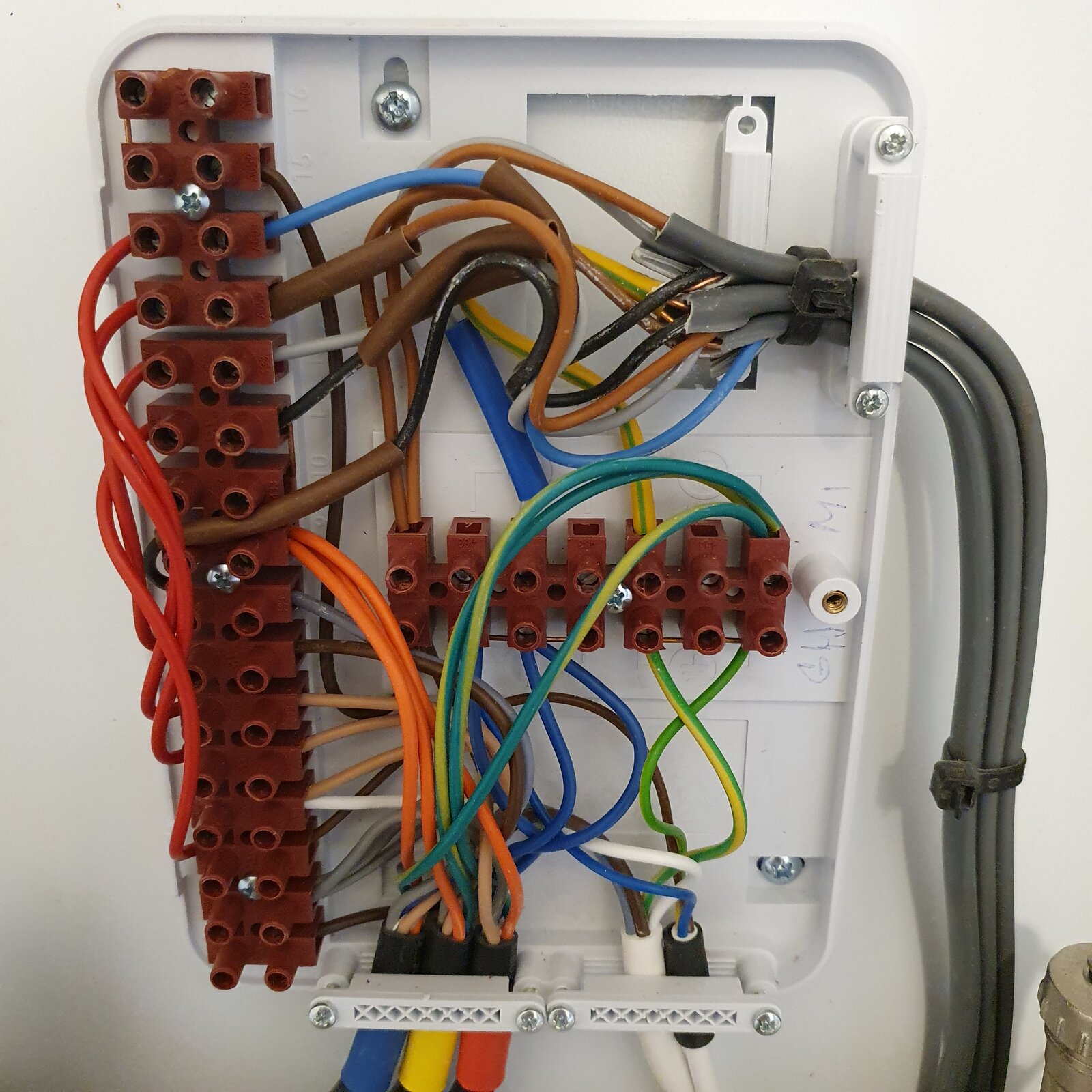

No problem locating the wiring centre, but the innards look like spaghetti junction. I wouldn't know where to start. Time to call in the experts methinks.
Not a bad move, but if you posted a photo of inside wiring center, someone (or me - my wiring knowledge isn’t the best) could help you.

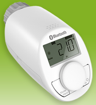

There are thermostats like EPH which can work a zone valve and turn boiler up/down set as master and slave, but in the main we simply don't use zone valves but use TRV control instead. Bit of a compromise, as the TRV shown is expensive, so we select key rooms for the linked TRV head, and use not linked 61dmtMm13BL.jpg in other rooms to keep the price down. The linked head with Hive sends a "demand of heat" to wall thermostat to keep the boiler running, so with a couple of linked TRV heads the boiler will run when required, and the cheaper terrier i30 or eQ-3 (shown) heads work the rest of the radiators.

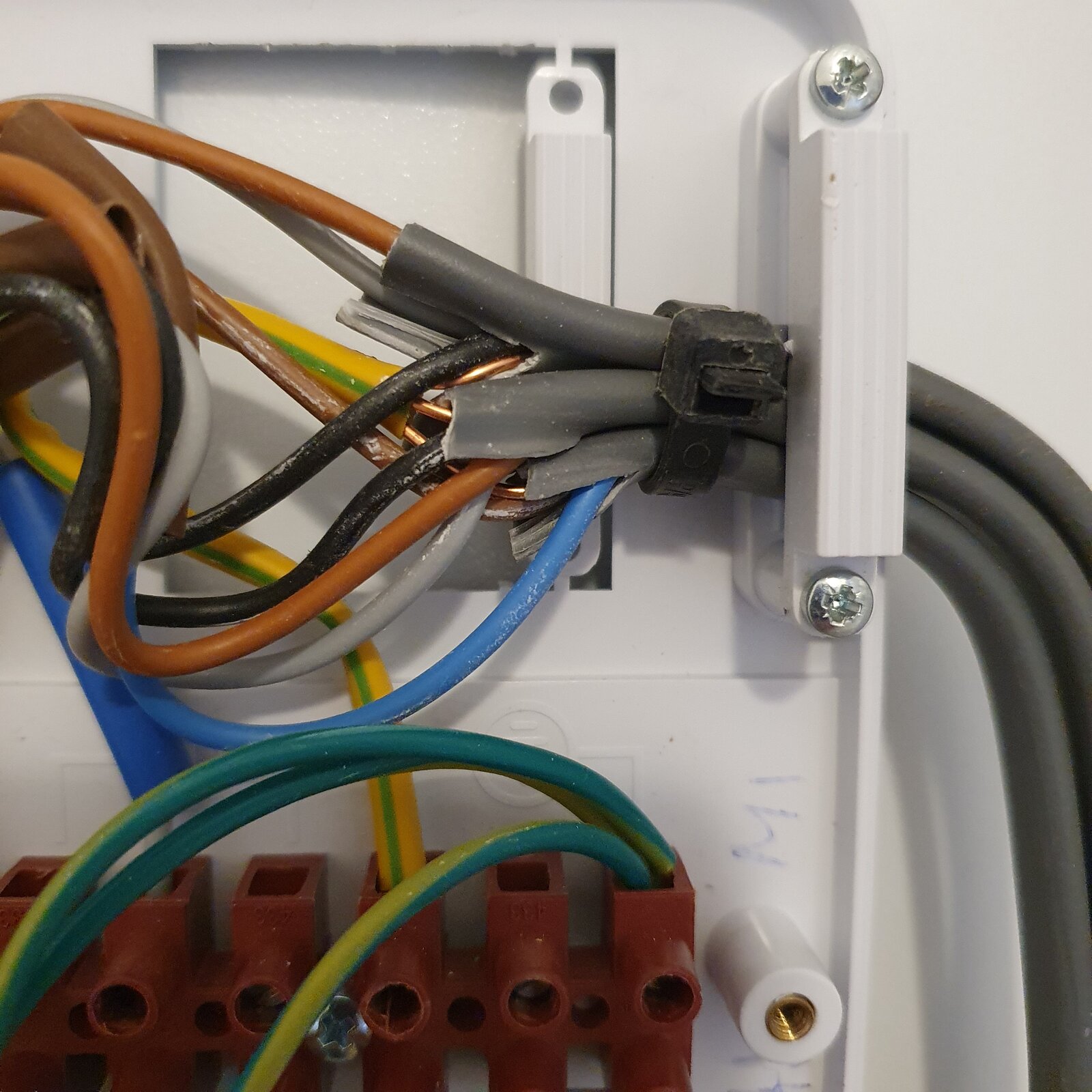

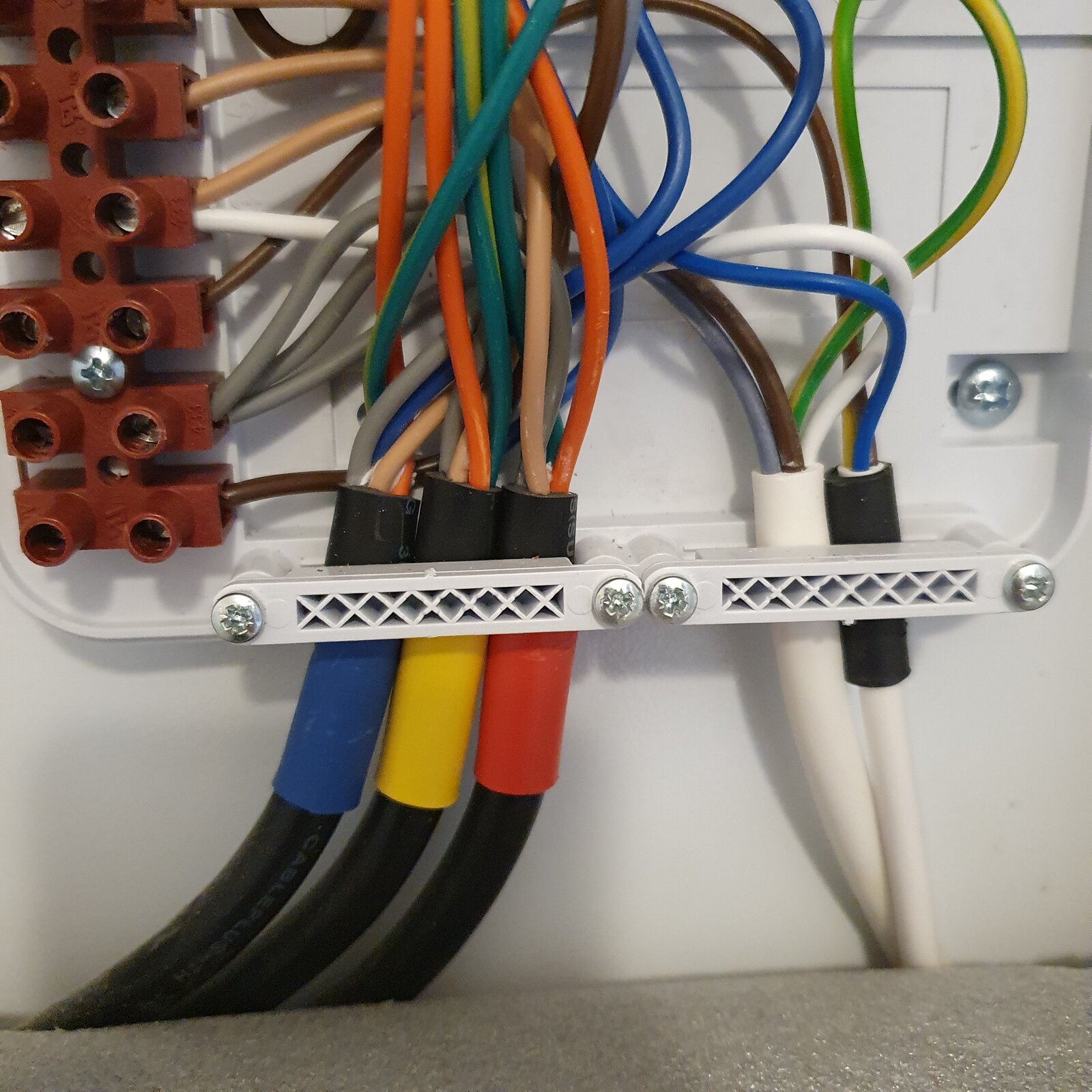

I've attached a photo of the zone valve (upstairs one is yellow coded) and it's route into the wiring centre. I've also attached a close up of a cable with brown/blue wires entering the centre, might this be the same cable that's connected to the Danfoss stat in the bedroom?
Over to you chaps, any assistance you can provide to enable me to connect the new Hive receiver would be appreciated, but I fully accept this may need the professionals in
