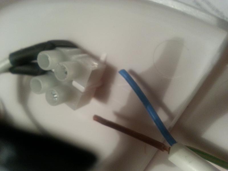

Hi. I am putting a downright in my conservatory. I am wiring it into a plug which will obviously go in the mains socket.
Is it a simple case of connecting the live and neutral wires (there is no section for earth wire on the light unit) to the appropriate part of the plug and light unit.
Please see pictures
You really should use 2-core flex if the appliance doesn't require an earth, or alternatively terminate the earth wire in an individual section of terminal strip. I note that you've damaged the insulation on the live wire when you removed the outer sheath. You will have to cut these ends off to give you suitable lengths of undamaged tails.
What means is provided for clamping the cable.

Thanks for the reply
By clamping down the cable, what do you mean? I will just put the ends into the plastic bit and screw down to hold it in place? Sorry if I misunderstand
Thanks for your help
If there is no clamp to hold the flex in place and the flex gets pulled, the leads could pull out of the terminations. These are not designed to act as pull-out restraints.
On the basis that you intend to wire the light via a flex to a 13A plug implies that the cable cannot be considered a "fixed" installation and as such a means of cable anchoring within the appliance is required.
Make sure the fuse in the plug is no more than 3amp.

You really should use 2-core flex if the appliance doesn't require an earth.
411.3.1.1 A circuit protective conductor shall be run to and terminated at each point in wiring and at each accessory except a lampholder having no exposed-conductive-parts and suspended from such a point.

Regardless of what you think of Ban, his advice here is correct.
But it is not great catastrophe, because marky has 3 core any way.
All he need do is remove the damaged portions of conductor, connect the cpc into a spare choc block, find a way to fit strain relief onto the flex, protect the flex appropriately with the correct BS1362 fuse, make sure the flex is adequately protected and supported on its route back to the socket and he's away.
