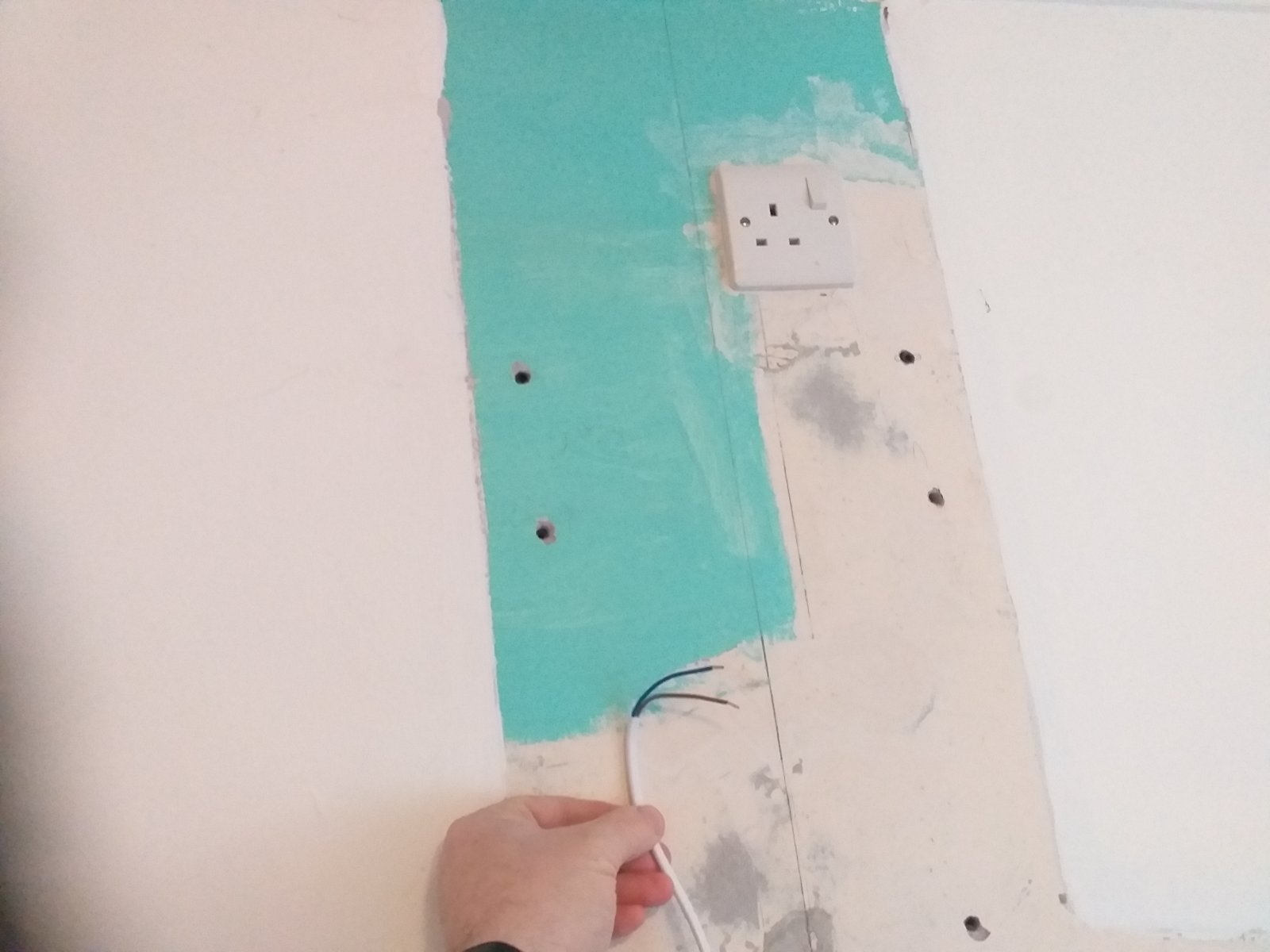

My previous extractor fan had a plug on it. This new one has no earth and they're talking about a double pole switched fused spur outlet in the instructions.
Can I just stick a plug on the live and neutral wires and ignore the earth and off I go?

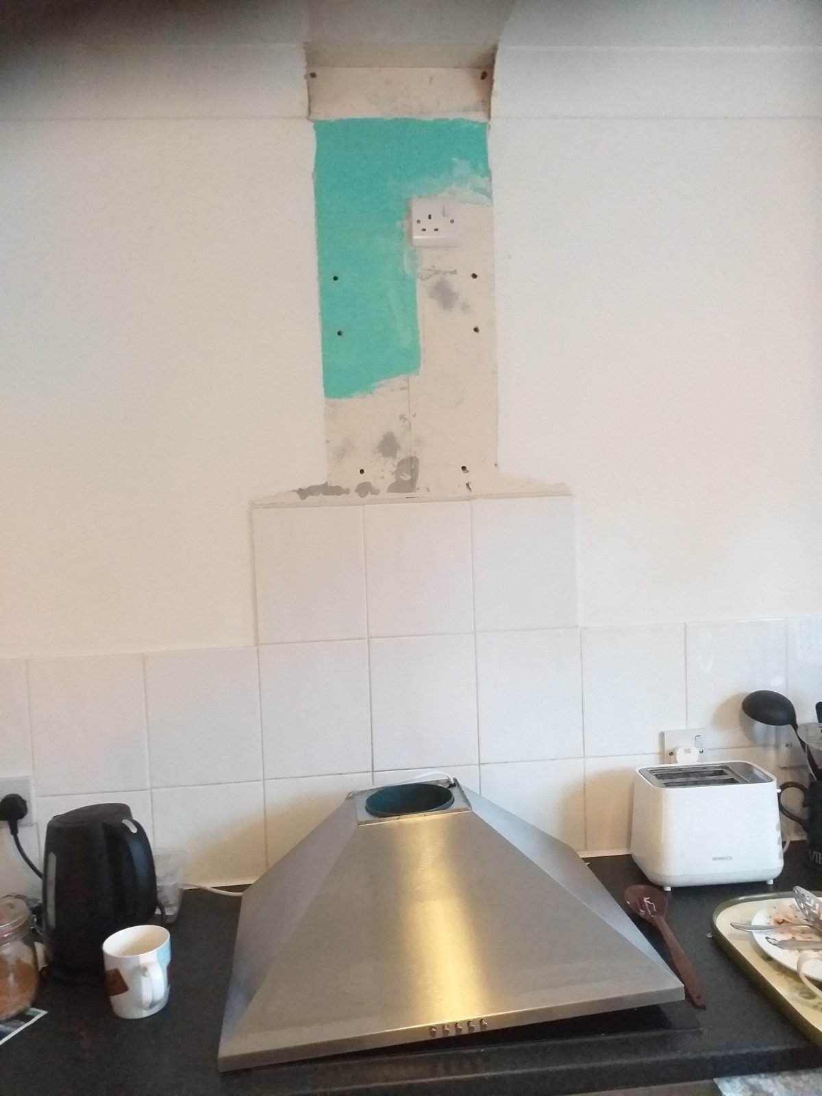

Ok so called screwfix and girl said we cant just use a plug. She was reading off the script and doesn't understand anything. She asked someone else and they said it's better to be hardwired. But clearly they dont know anything. Last extractor was just a plug.

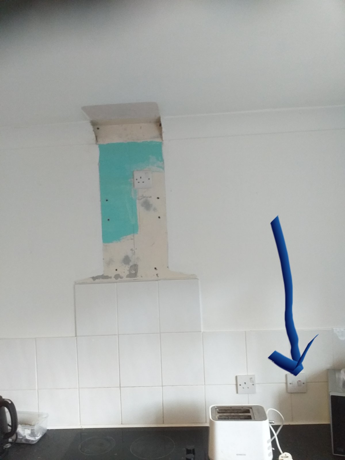

I looked in my kitchen and this thing under arrow (in photo)looks just like the double pole switched fuse spur outlet stated in instructions. It controls the socket for extractor, toaster and microwave ( i tested it.) It has a 13 amp fuse.
Does this mean it's ok to just put a plug with 3 amp fuse onto extractor into wall above stove?

"Does this mean it's ok to just put a plug with 3 amp fuse onto extractor into wall above stove?"
Yes that is ok and will work perfectly.
It meets the instructed requirements of the fan (double pole switch, 13A fuse, double pole switch on removal of plug from socket, 3A fuse), and will be safe.
And matches with what EFLImpudence and Taylortwocities said earlier.
