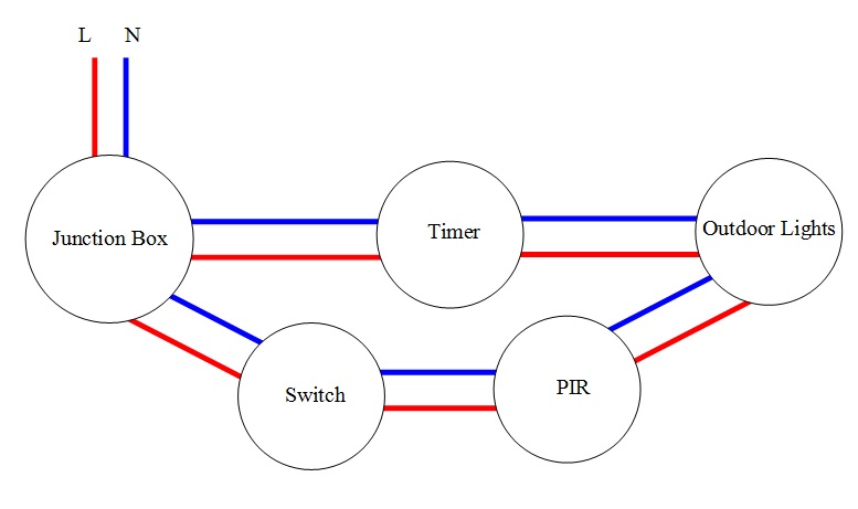

I have outdoor recessed downlights installed currently running off a timer and i'm looking to add a PIR sensor to them so when the lights go off on the timer at night, the PIR is still active and the lights will come on should there be any movement in the garden.
I've attached a picture of how the lights are installed and have added a switch and PIR to the drawing, would be grateful if anybody could have a look and let me know if this is how you wire up the PIR to the system.
That looks fine to me (and is similar to some arrangements I have in my house). The PIR will obvioulsy remain 'powered up' during the day if its switch is 'on', but I imagine that you will use a PIR which has an inbuilt light sensor which 'disables' its operation during daylight.
The switch you have added is not really essential, unless you want to be able to manually disable the PIR (even at night). Was there a reason?

Thanks for your quick response, the timer I have is a bit of a faff to turn the lights on outside permanently, I plan on getting a PIR which has the light sensor and also one that when you double flick the switch it turns the outside light on

Fair enough. That would leave just manually turning off the lights when the timer had turned them on (should you ever wish to) - can that be done (if required) fairly easily with the timer?
Is that junction box permanently live? If so, I would suggest that you consider installing a double-pole switch 'upstream' of it (i.e. in the feed to it), to enable you to completely isolate the whole lot. Outside lights have a habit of suffering from water ingress and if you cannot isolate them (and, sometimes, even if you have a single-pole switch), water in the lights can trip an RCD and hence prevent use of all sorts of lights and other things in the house until the problem is rectified.

Thats a great idea with the switch, yes the junction box is permanently live and it would be very easy to stick a double pole switch before it.
I don't imagine having to switch the lights off when on the timer but there is a setting on the timer to do that.

Not sure, but either I've misinterpreted what you're trying to do, or you've got this the wrong way round. Lights would normally be on when it's dark, but a PIR will only activate them when someone comes near, so in many ways, you either want them on permanently, or only PIR activated when it's dark.

As I understand it, the time switch switches the light on for a period during the evening, and the OP wants the PIR to put them on if they detect movement during the period of darkness after the timer has switched them off. During daylight, the PIR would be disabled by it's own light sensing.
What he is proposing will achieve all that.

Put a switch in parallel with the timer, or a 2-way switch after it to allow you to select between timer and permanent.
