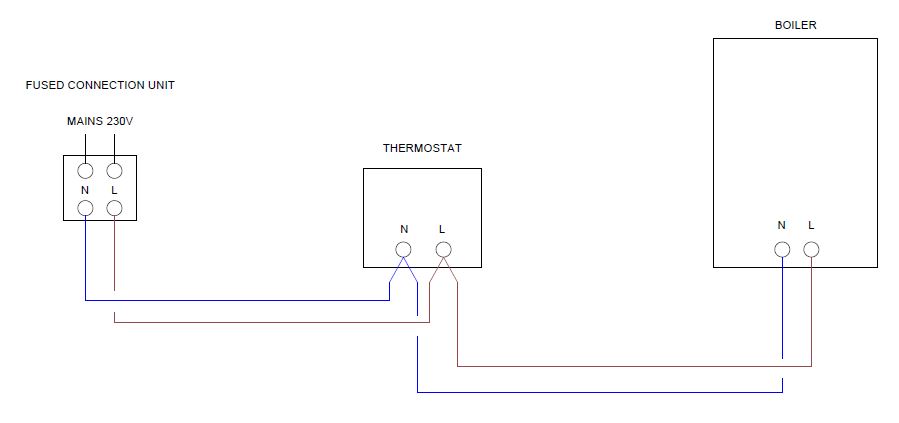

If I read your post correctly, your concern is with the 230V supply and as I understand it from your description, that the mains power supply is wired as per my sketch below. If so, that's fine because the same fused connection unit will isolate the entire heating system. It doesn't matter if the L & N is introduced at the thermostat or boiler. Electrically speaking it's exactly the same thing.
My only comment would be that if the FCU isn't physically near the boiler, then a separate isolator should really be installed adjacent to the boiler for isolation during maintenance.
If I have misunderstood your description please post back.

You got it spot on what I was trying to say. The FCU is near the boiler as is the Wireless Receiver, so all very handy. Really appreciate he time you took to respond. Many thanks

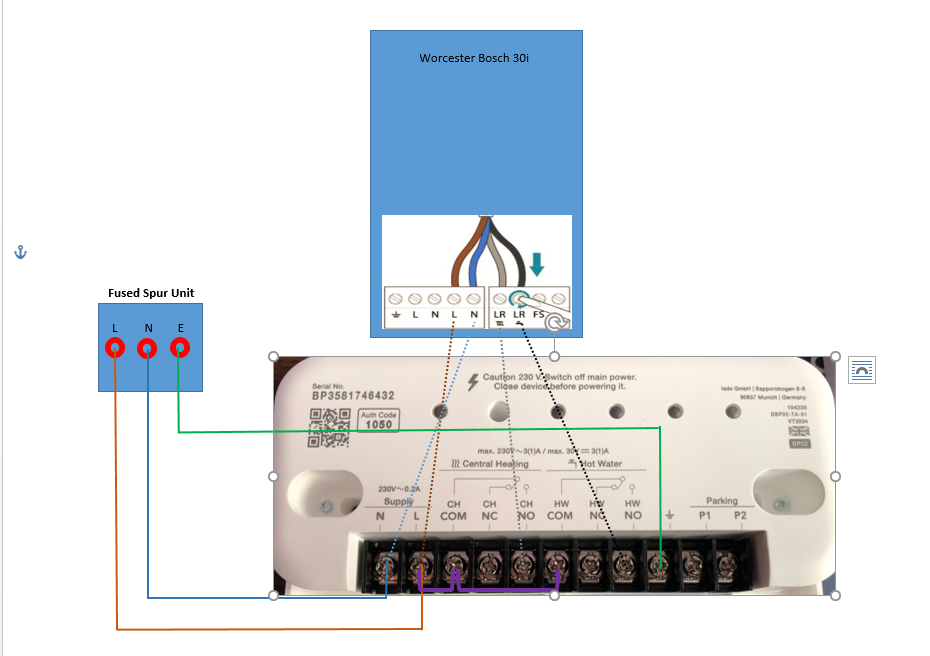

Below is the pic as to how see it, and I am hoping I have wired up everything as it should be:
I have seen video's of 2 different installs to the Worcester 30i with the Tado Wireless controller, and both had different wiring variations, hence the confusion about it all.

you mean I actually got something correct........ Very unusual for me, more down to lack of confidence than anything else. Many thanks to you both for responding to the request, very much appreciated.
