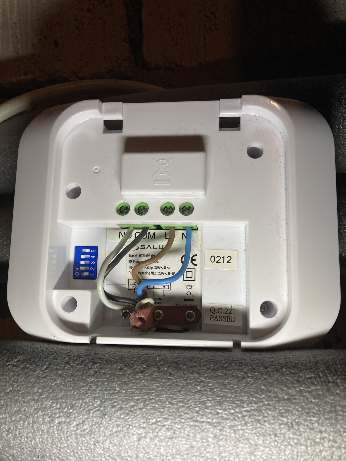

Hi, another Wiser wiring question, sorry.

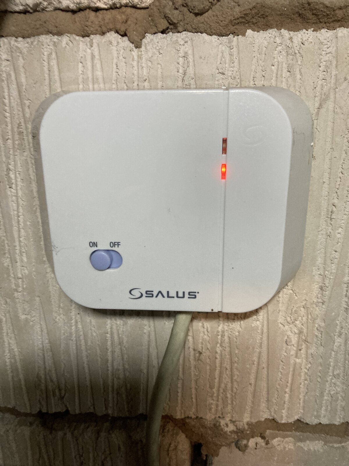

Current controller is a Salus and has 4 connections as in photo below. I want to fit the Wiser controller backplate but don’t want to make a mistake on the wiring.
Boiler is a combi WB Greenstar 29cdi and the Wiser kit is single zone.
Can anyone check the two photos and advise please?
Many thanks, Ian.

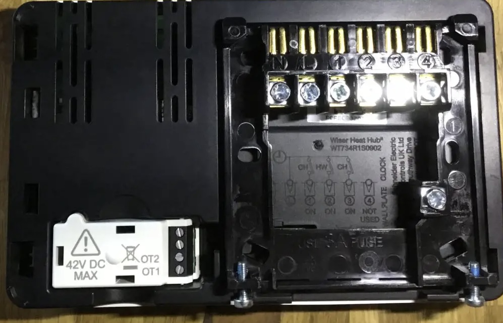

Well spotted! Sorry but I stole that photo from the internet knowing that all the back plates are the same. Here’s mine.
I finally got around to fitting the kit this weekend and it’s working perfectly after resetting the TRV’s (bought second hand), thanks for the help.
Should have done it before now.
