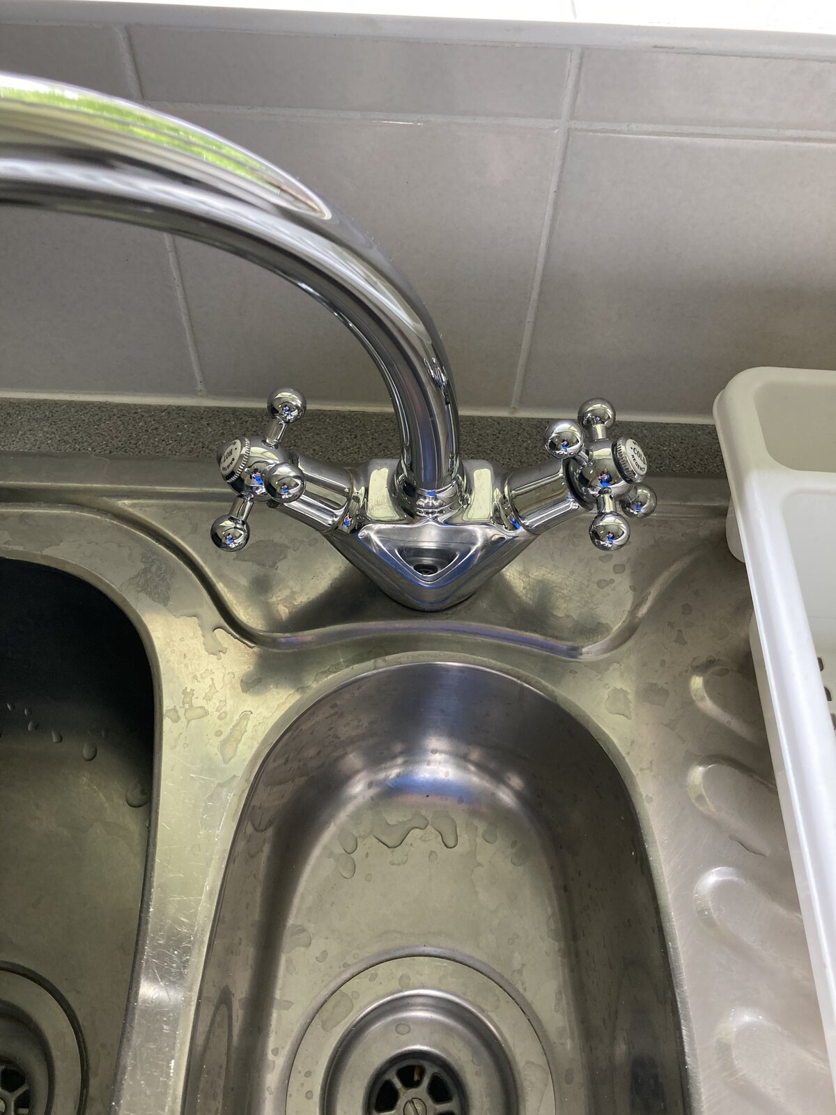

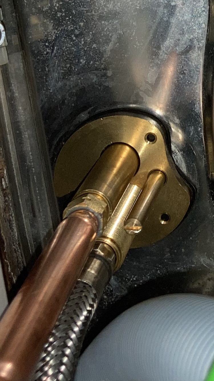

66051799-8C0D-4BC2-93A5-54F5FEB40BC9.jpeg C227A00A-68D2-4EBE-8F4B-4C0C71DC8EFD.png Hi, bit stuck trying to fix wobble my tap has developed. I have tried tightening the long brass screw underneath but it doesn’t move, not sure if this is because it’s already tight or I can’t get enough leverage due to awkward position. Any thoughts? Is there a specific tool to tighten without taking tabs off? Thanks!
Doesn’t look like a setup I’ve seen before, but it looks like it’s the thin brass screw that should tighten it up, with a screwdriver. Usually they have a threaded shank, and nut that gets tightened with a monobloc spanner.
They are a bit wobbly on a stainless steel sink, it helps if you make a plate to spread the weight further and if you fix the pipes somehow.
Elkato531 Has the answer ! its tightened from above the sink unit after taking the tap body off.
At around 1m 10 sec. the rest is bisgy speil.
If your doing it yourself, ensure when completing the job the tap body is firmly allen keyed down. Has been known they can leak (a lot).
