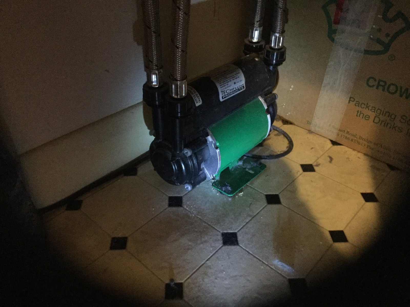

At 2oclock yesterday morning I was awakened by the sound of our shower pump running for a few seconds and then stopping. The only other person in the house was fast asleep but in any case there was no water on the floor of the shower tray. Exactly the same thing happened at just after 5am just as I was passing the airing cupboard which houses the shower pump and again it lasted for around 10 seconds. And again the shower tray was dry. Haven’t a clue what is happening so have switched off the pump. Any ideas anyone?
You may have a slight leak/drip in your pipework or at one of your taps or shower, that sometimes drops the pressure in the pipework just enough to activate the pump switch briefly. Is it a universal pump?
Not sure if it’s universal or not but hopefully the pic has been uploaded. If it is a leak, would that be anywhere in the system?
cant see if it has a small vessel or not and given it's position I don't think so though which means it's a positive head pump, if you can give the model that would help. It may be that the pump just needs serviced, flow switches/filters cleaned etc.
yes it could be anywhere in the system, it could also be down to pressure fluctuations in the mains and theres a faulty hot non return valve in a mixer tap/shower that the pump supplies.

  1. nope, could be upstream fluctuations triggering the switches too, service the pump and go from there.
  2. yes ... a plumber who has experience with shower pumps, tho not sure if bits for the techflow are still available so it may be just a case of stripping and cleaning and greasing.
  3. could biofilm interfere withthe flow sawitches, probably. Biofilm could be down to the cold water storage cistern, is it looked at regularly and kept clean/covered and insulted & make sure the hot water is set to at least 60Deg

Getting a plumber is out of the question with a round trip of 150+ miles. Will have a look at the pump myself and if I get lost will simply replace the pump.

Decided to have a look at the pump myself and found guidance at Plumbworlds “Shower Pump Care and Maintainence” here:https://www.plumbworld.co.uk/blog/showerpumpcareandmaintenance However, was a bit puzzled when part of the advice given states:
“......make sure that the water temperature from the hot water cylinder does not exceed 60C. Water that is excessively hot can cause damage to the pump during prolonged use, draw air into the system and invalidate its warranty”.
Our HW cylinder thermostat is set at 67 degrees.
Yeah, 55-60 Deg at the cylinder, max 50Deg at the outlet, that's the optimum HW temp. 67deg is a bit high but if you like it hotter then fair enough.
Yup, lots of plastic and rubber in the pump that doesn't like it too hot, keeps expansion at a min too and extends the life of the seals, too hot can eventually harden them.
Is that your issue though .... don't think so.

Thanks Madrab, I really fancy having a go at that. And while I’m doing it, I’ll connect the feeds to the pump to those to the shower so that we can at least have a gravity fed shower. That is if I can find threaded connectors to join the 2 sets of flexible pipes.
Obviously they are using a dead monsoon but the theory's the same for most ST pumps. The Techflo were a little different though, they may not be as easily accessible/serviceable as the others are, just the way they made them I think as they are ST's budget pump.
The area (and easiest) place you want to look at first if you can get to it is the float switch + non return valves. There may also be a coupe of inline strainers/filters, give them a clean too. There definitely isn't any leaks or dripping taps that could be letting air in?
Don't connect the flexi's directly like that ....you'd put the flexi's under too much bending strain, you'd need to create a loop out of pipe and a few couplers but not sure how good a shower it would give you under gravity.
