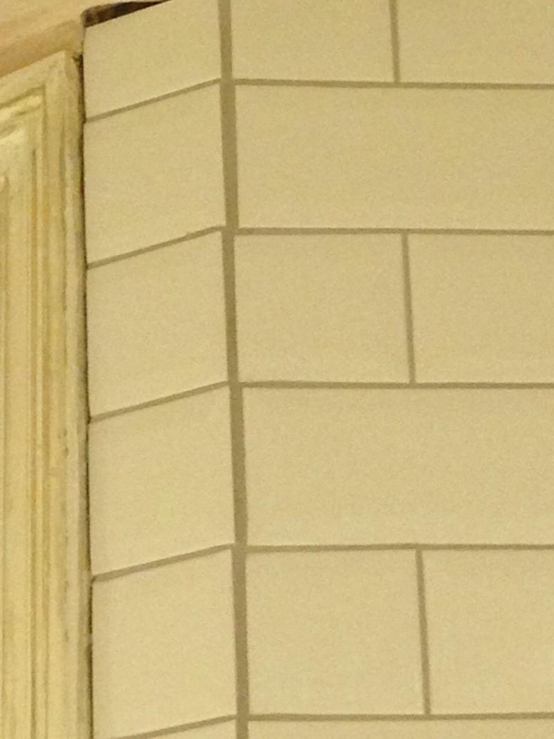

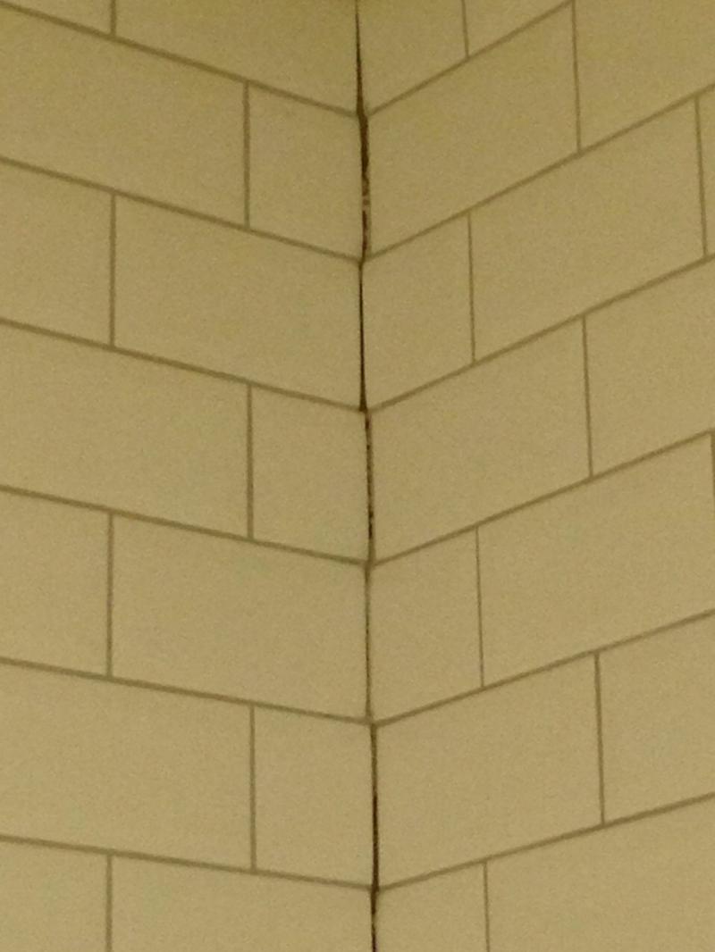

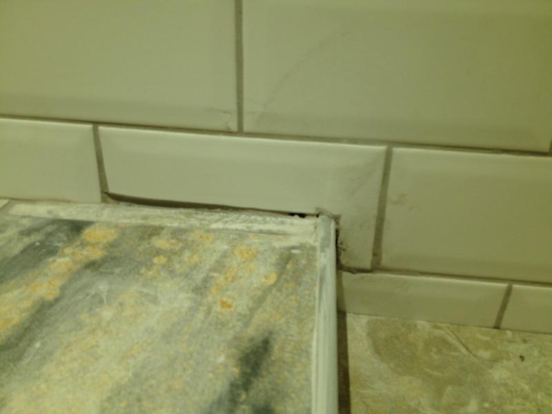

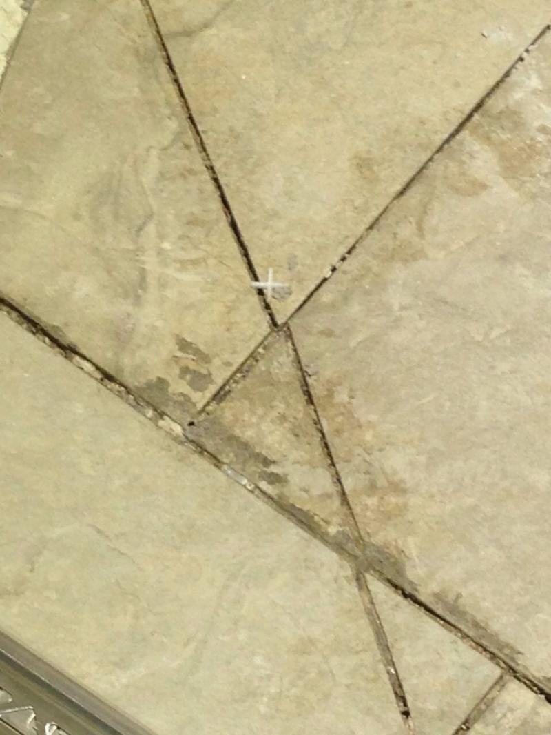

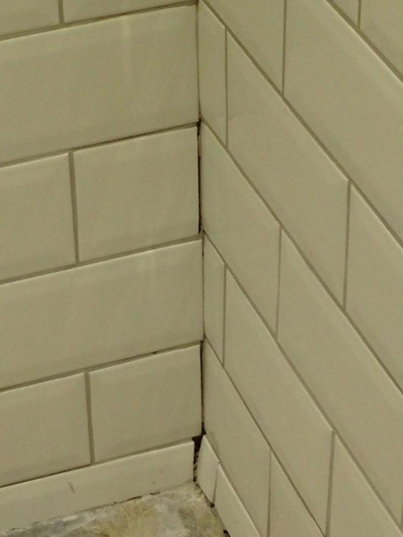

Hi everybody,
I am posting pictures of some of the tiles which my plumber has put into my new bathroom. He is charging me £200 a day and has so far amassed labour costs of around £4,000 with probably another £1,000 left to go.
He says he will put silicone seal along the corners and that the outer corner is wider at the top like that because it's an old and uneven house
Is this normal?
Shocking, wonder what his plumbing skills are like. Hope they're better than his tiling.
Totally unacceptable workmanship
The guy does not have a clue.

Yes, he has taken out the old bathroom, and plumbed for the new one. The tiling was looking OK until we got to the corners and the grouting stage.

The tiling might look half decent with nice thick, taped-off silicone edges. A bodge though. The man's not a tiler. And still don't think its 20 days work full time to do all the above. Providing there's no requirement for the bathroom to remain operational throughout and the bathroom isnt too big here's my non-professional fag packet calcs for timings:
