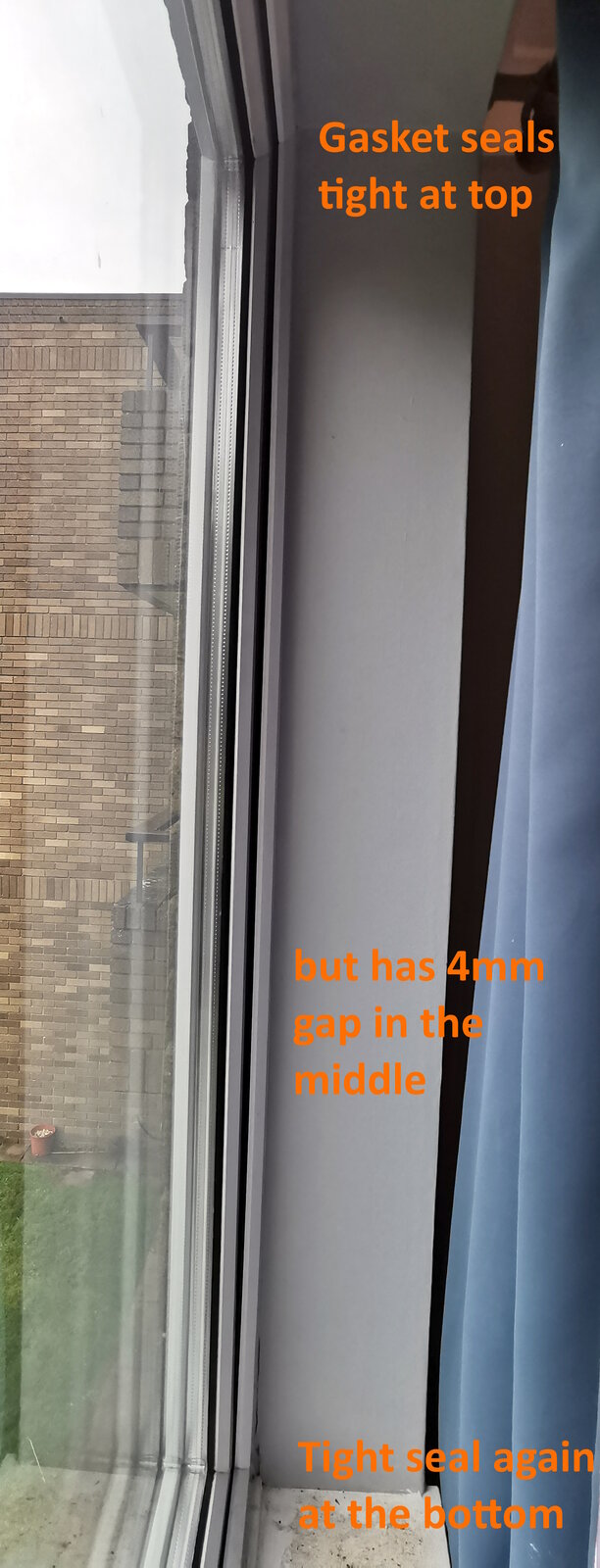

Hi all
I have seen this topic discussed very briefly in various forums but no real solution ever being offered.
I own a flat in a late 70s block. The windows would originally have been aluminium but were replaced at some stage (I'd estimate 10-15 years ago) with fairly decent quality upvc windows. They are top hung casement windows (awning windows) which are about 1.5m tall.

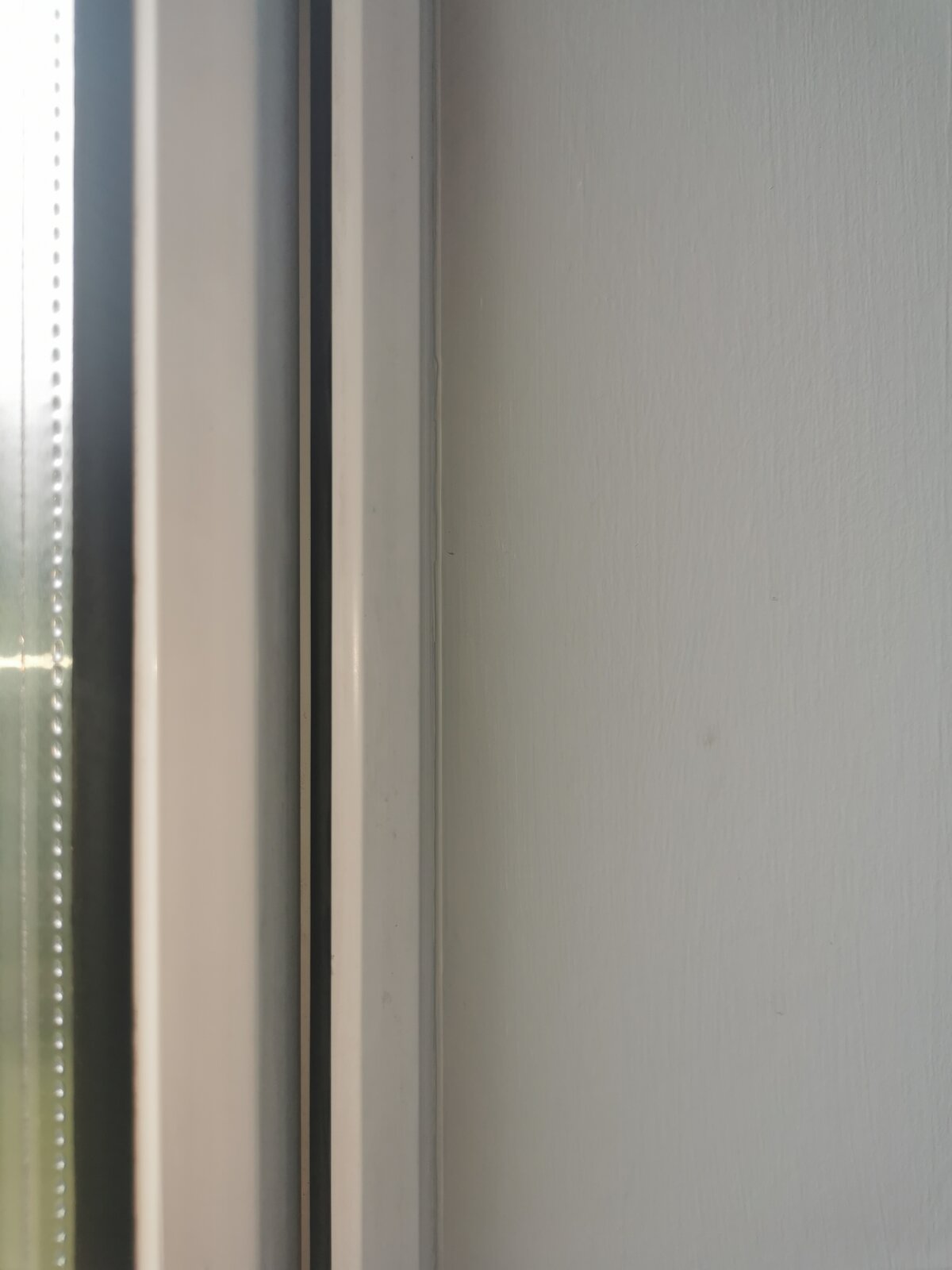

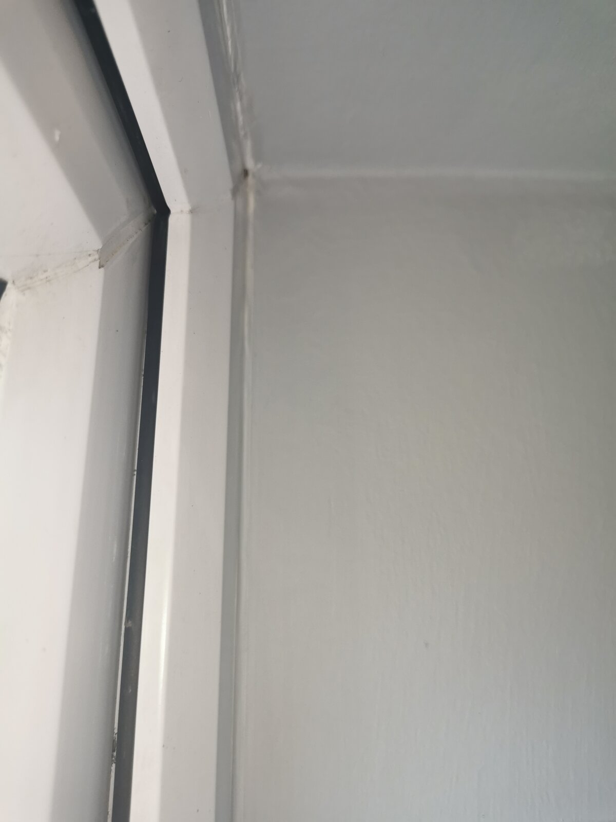

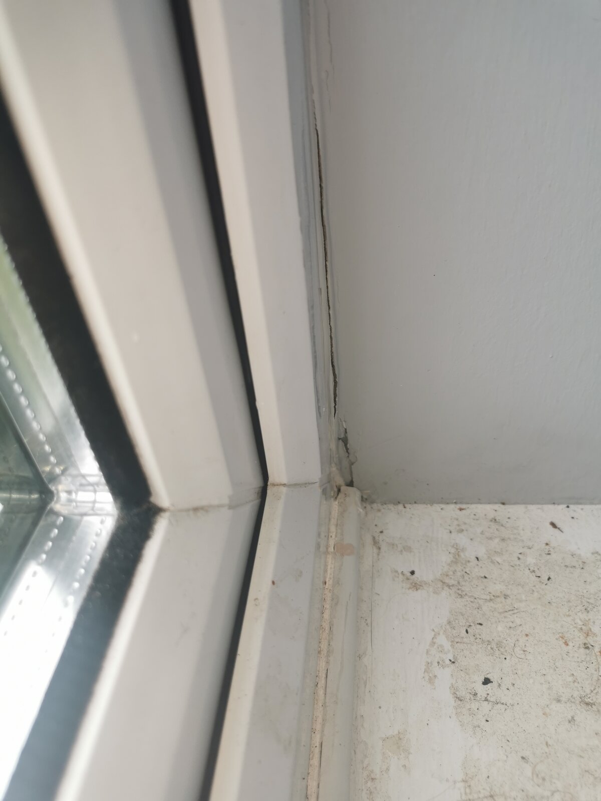

I recently replaced the gaskets on both the frame and the casement but noticed that both the casement and the frame (to a lesser extent) have bowed slightly top to bottom such that whilst the gaskets seal nice and tight at the top and bottom of the window, there is a c. 5mm gap between the gasket and the frame/casement halfway up, which lets in noise and air.
Previous discussions I have seen mainly went into why this has happened. I'm not particularly interested in this as I can't afford to replace the windows with new and remediate and building issues anyway. Is there any way to close that gap that is well worn? Options that come to mind are:
- I have used a 6mm bubble gasket. Could I just use a 10mm gasket instead (if I can find one) or would that exacerbate the issue long term?
- If I use a wider gasket just in the section of the window that has the gap, would that work in principle or would it cause more bending again?
- I have seen Nico sash compressors suggested - https://www.nico.co.uk/product/sash-compressor/ but that looks like a recipe for a stuck window to me. I am on the first floor so can't get easy access to the outside.
- I have also seen sash jammers suggested - https://www.toolstation.com/era-sash-jammer/p59335- but again imagine these would mark the frames in time and work their way loose if they are having to do too much "unbending" work. However they do seem like a realistic option overall.
Are there any other options out there that people know of or anyone with experience of the above to see what might work? Photos attached.
