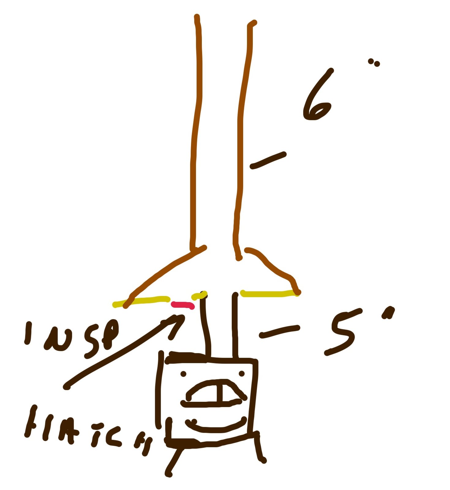

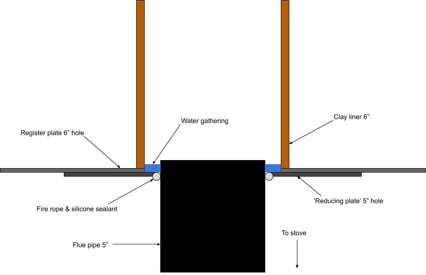

Personally, I think something is fundamentally wrong with the install and I’ve lost confidence in the fitter’s ability/desire to solve the problem. The diagram below shows what I mean:
This looks fundamentally flawed to me, there is always going to be a void where water/soot can gather due to the difference in size between the flue and the clay liner.
Can anyone offer advice on whether this is correct?
The bottom end of the install that you've shown is irrelevant for your problem. The problem isn't the water pooling, the problem is the volume of water getting down the flue.

Is your drawing correct, if you have an inspection plate it is to sweep the flue and remove debris so there should be a space between the two sizes of flue.

Yes, definitely correct, there's no hatch. Either side of the clay liner is brickwork, there's no chimney to sweep, the only thing to sweep is the clay liner and that's done through the stove.

I think you're right to a point, however, in mind there shouldn't be any point where material can gather, whether it be: water, soot or tar. I think this is why they say all flue connections should have the socket/male end facing up so that any deposits are passing into the next connection.
If the 6” length is free of bends and snots a 5” liner may fit but the stove would need to be 5kw or lower and defra exempt.
If you have 5” into. 6” then how will the top section be swept as a brush that can pass through the smaller section would be too loose in the top. It can be done with power whips which would require a pro though

I agree, but all that would happen is that the water coming down your flue would end up in the stove. Its the water ingress that you need to fix.
