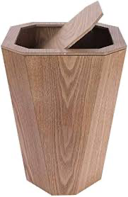

Here is a rough picture of what I plan… please note, it’s from a google search, but does not fully show my plans.

Do you not have a jigsaw that'll cut the wood at the required angle?
Yeah, I can do it on the table saw too, but just not confident that I can do this perfectly as my saw is not fully setup and getting the angle’s perfect is where I am truly concerned about myself doing it yet… with time being a big issue too.
Easy.
Set the table saw at 22.5⁰ angle and do all the lengthwise cuts.
Once joined they'll give you an octagonal shape.
What do you mean your table saw is not set up yet?
It takes very little time and that's the right tool for the job.
Easy.
Unfortunately the angle is not 22.5 deg, without knowing the taper It can’t be calculated.
It is 22.5 deg if you take a horizontal slice and look down on plan, but it’s not 22.5deg from the face of the board
Don't understand what you're saying.
I've made hundreds of octagonal ashtrays all with the same technique.
This is simple a longer piece of wood.
