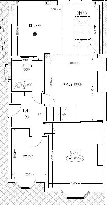

My problem as seen in the layout below is trying to avoid using 3 types of flooring (carpet/wood and tiles). Agreed that a carpet is warm and insulates. The issue is that I could use carpet in the lounge, ideally I want to use wood flooring in the hall area and also use tiles in the family + kitchen/diner. I would also consider using wood int he kitchen/dinning/family room area, only concern is water splashes from the kitchen and that ruining the wood flooring.
Thanks in advance.

The same flooring in the kitchen / diner would work well - I’d go for tiles here but tempted to go carpet in the family room area although floor tiles through will allow the space to flow and feel bigger. The only down side is the noise / echo.
Warmth wise “cold”is relative and they will certainly feel cooler than carpet but with the 8 dulati9n this cold shouldn’t be striking just less comfortable to bare feet as an example.
I’d view the hall flooring and lounge flooring as two separate areas and for the latter, definitely carpet IMO for all the reasons mentioned above.

I'm very surprised that you find wood cold, but tiles will be even colder, and would need insulation, electric UFH, and then the tiles, so would that raise the floor height too much. The upside of tiles, is that they'll help keep the room a little cooler in the summer. But trying to heat up those three areas could be expensive, and we hear a lot of cases where the cable or the thermostat goes, and you're buggered.
You didn't mention the depth of screed, but if you have tiles without any UFH, then they'll be damned cold in the winter, whereas I've fitted engineered wood on 5mm fibreboard, and it's been fine on it's own. I'd go with carpet in the lounge, and the engineered wood everywhere else. You can either go for lacquered, or brushed and oiled, but both will resist water.
