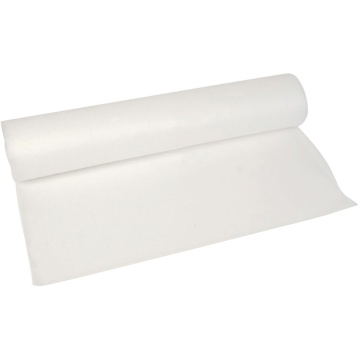

I would go with the 8 X 2 timbers but fit a sacrificial inner layer of cheap laminate underlay, the stuff on a roll...
Staple the underlay on and then cut panels of the Correx / T-Bord floor protection panels...
https://www.selcobw.com/catalogsearch/results/shop-by/q/correx to fit loose, not fixed, in front of the underlay.
If you do a double or even a triple skin of these cut to fit into each metre wide section then when they perish eventually you can just slide out the front one leaving layer 2 and 3 in place. The advantage of this is that you have a simple replacement panel already sat waiting and it will help with insulation of the heap and also keep seperation between the compost and the timbers.
Selco do a 2mm and a 4mm version and cheap enough to do a few layers.
Hadn't considered a lining approach - most interesting. I'll seriously consider that, thanks.
You don't want to make it too air-tight, compost heaps need air for good decomposition.
