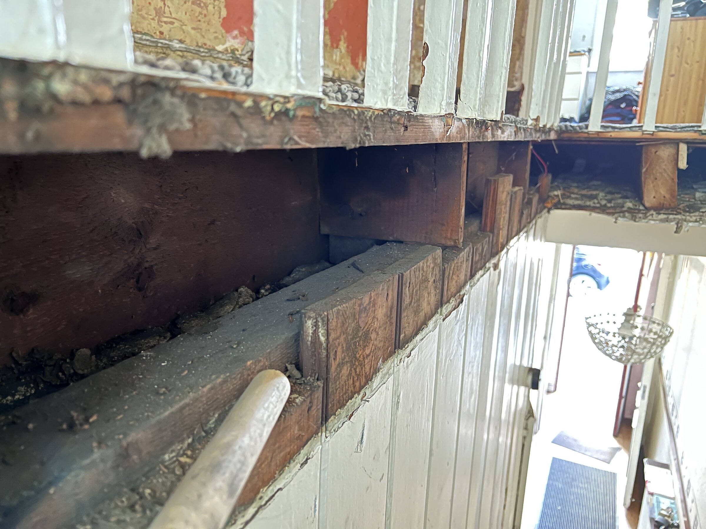

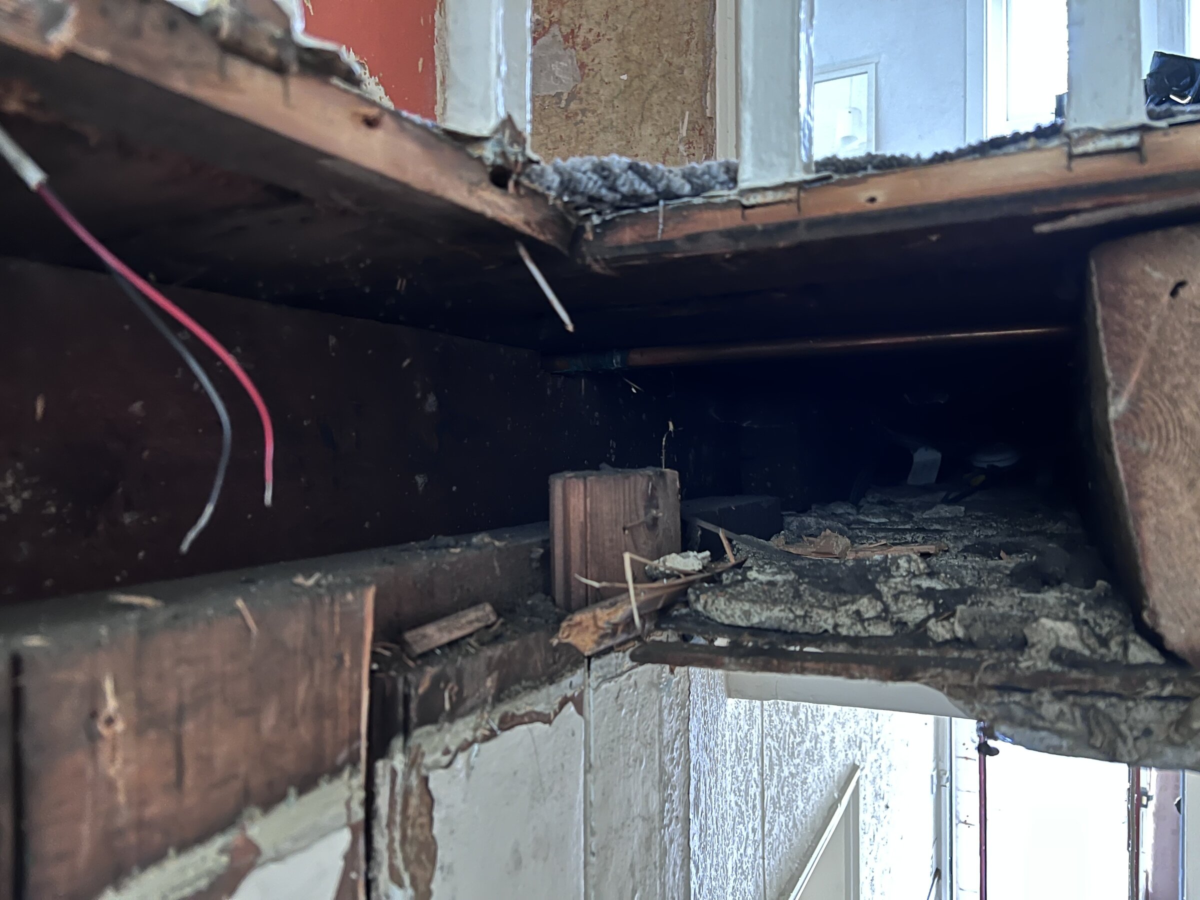

Hi all, first post here (many more to come as I’ve just started my first renovation) and a complete amateur.
I’ve recently purchased a Victorian terrace (built 1900) in need of renovation throughout. One of the first things I had planned to do was take down a wooden panel wall between the stairs and the dining room.

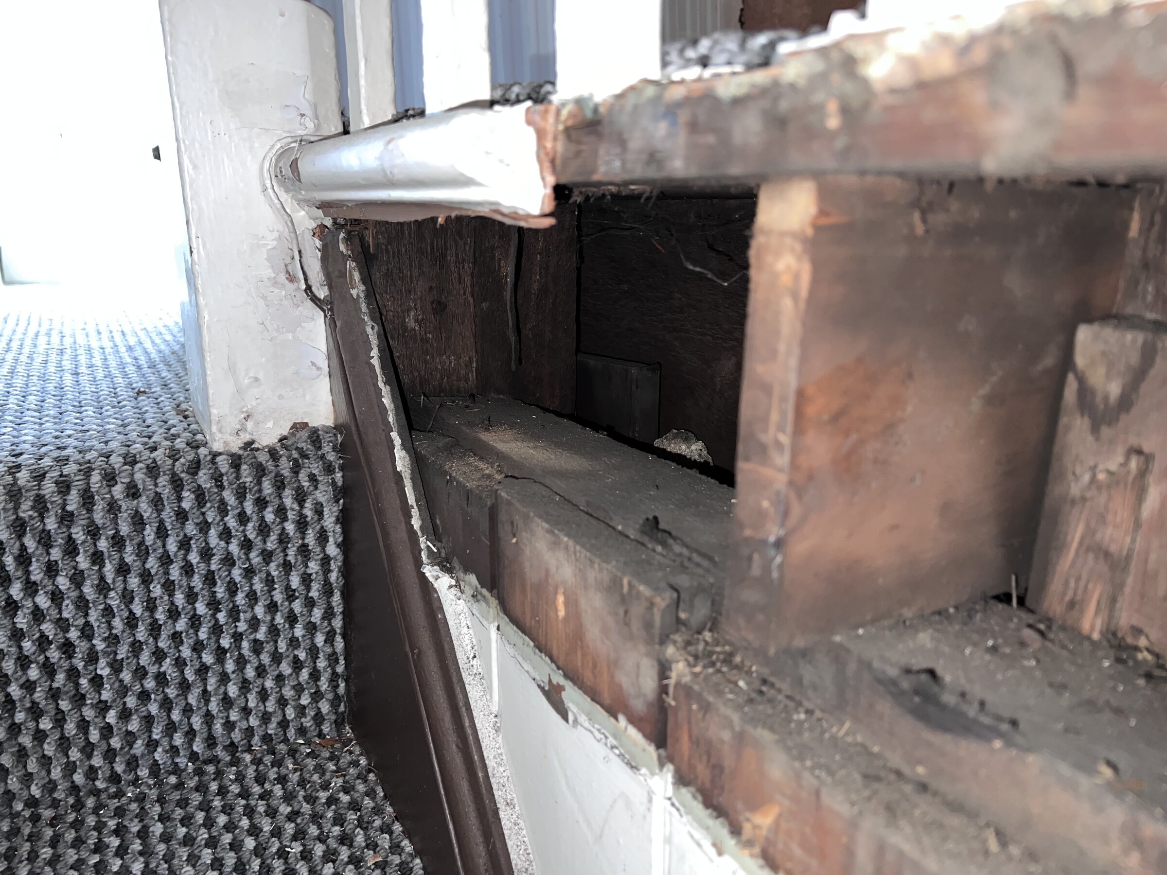

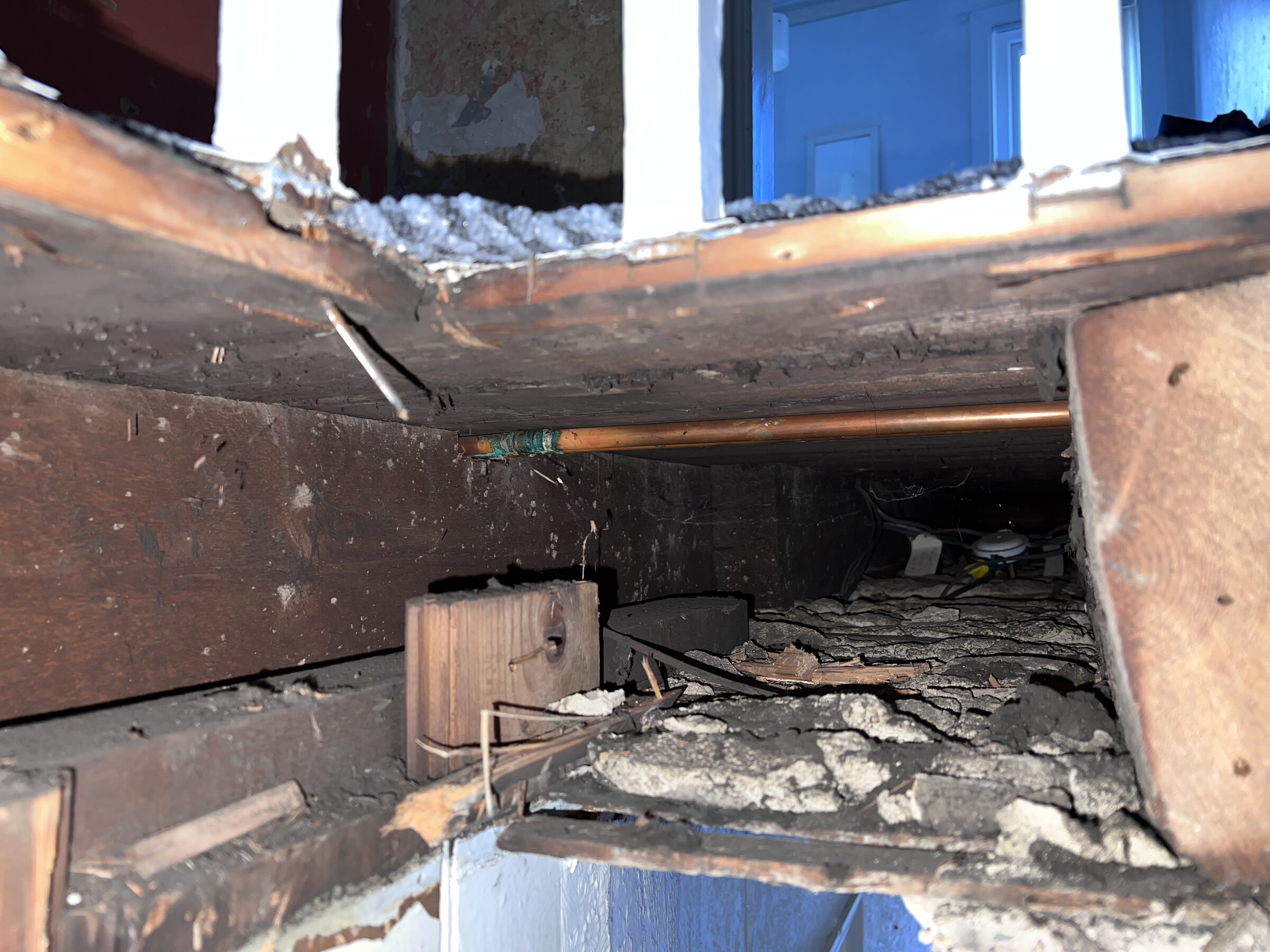

The panel wall is nailed into the floorboards at the bottom and at the top it’s nailed to a piece of 2x4. This piece of 2x4 doesn’t run between two load bearing walls, it’s supported entirely by the panel wall. The floor joist supporting the landing floor runs right down the middle of the floorboards, so by losing the wall and the 2x4 would I be losing support to the edges of the floorboards and the landing base plate? Pictures attached.
If so, what could I do to avoid losing support to the floorboard edges and landing base plate?
Cheers,
Tom
What concerns me most is that the short end of the stairwell opening has no trimmer, which needs to be there both to support the joists (which appear to just hang loose), tie the josit ends together and carry the edge of the floor.
AS A MATTER OF URGENCY YOU ABSOLUTELY MUST GET THAT AREA PROPPED ASAP. WITHOUT PROPPING THAT SECTION OF FLOOR MIGHT FAIL AT ANY TIME IF IT GETS HEAVILY LOADED. Ideally one or two Acrow props and a short scaffolding board one at top, screwed to the props, one at the bottom (ditto). Even a few lengths of 3 x 2 stud screwed together with a 2 to 3in thick piece of timber at the top (not 18mm ply) should suffice
Once it is safely propped you will need to cut back the joists to be in line and install a timber trimmer - same cross section as the joists behind it, but doubled up. So if your joists are 7 x 2in. your trimmer will need to be 7 x 4in which made up. RH end (viewed from top of stairs) needs to be pocketed into the wall, LH goes onto a double joist hanger (nailed in place with twist nails)
On the long side if possible knock off those little "joists" (I think they are just noggins) and put a single 4 x 3in in fixed into the existing joist, then screwed through from the top through the floorboards
How is the top of the stairs carried? Cannot see a trimmer there, either.
TBH this matchboarding was probably not done by a carpenter at all - otherwise I'd have expected to see a trimmer in there at the end of the opening

Thanks for the reply Job&Knock - I have a couple of acrows so will get it propped up for now. Doesn’t look like there has ever been a trimmer there, no wall pocket and nail marks on the joists are from the apron being nailed directly to joists, so original carpenter must have botched it! Assuming the lack of a trimmer is behind the rotation in the joists?
Can the trimmer sit directly on the brick, or do I need padstone or to pack with slate? And assuming I’d need to wrap the end of the trimmer in dpc or felt or something if pocketing into the wall?
Not sure yet how the top of the stairs is carried, will be ripping the old carpet up over the next week or so, so will have a look then. But judging from the botch job on the short end, assuming it’ll be more of the same!

A structural engineer came over to provide some calcs for steel for a knock through and to assess some cracking in a brick wall. Whilst he was here I asked him about the panel wall, and as JobAndKnock suggested the match board wall can be removed and the edges of the floorboards supported by a piece of timber attached directly to the existing joist. Matchboard wall is now down and timber attached to existing joist is supporting floorboards fine, so that’s sorted.
Regarding the lack of a trimmer, the joists (around 8 by 3) actually span from the front of the house to a concrete lintel and what we see in that picture is about 1.0m of joist overhanging the lintel. The joist is approx 4.2m in length. Structural engineer said this level of cantilever is fine given joist length and thickness, so no real need for a trimmer!
