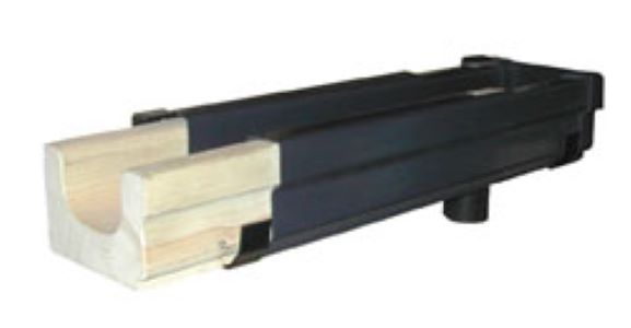

Hi,
I have a problem where an existing wooden gutter has been joined (not very well!!)to a neighbour's plastic rainwater gutter and is leaking.
My initial thoughts were to fibreglass over the joint, but I don't think the plastic gutter would adhere very well to the glass.
Is there a gutter sealant that would be better, I would guess that sealing to plastic is a bit of a problem.
Any ideas welcomed
Many thanks
Is this the traditional wooden troughing, and is your neighbour's gutter a compatible type of plastic troughing, such as the Twinplas type? If so it's normal to connect the plastic guttering to the wooden troughing using a half-lap connector, stainless steel screws and silicone. A photo might help

I think you have misunderstood what I was trying to get at. If you look at the profile of wooden troughing and the modern twin wall plastic troughing, the outside of the plastic troughing is the same shape as the timber troughing, i.e rectangular, whilst the profile of the gutter itself is half round:
When joining plastic to plastic sections a slide on sleeve piece like this is used:
This is slid onto the end of a length of troughing and the next piece of troughing is then slid into the end of the sleeve (the lighter=cpoloured area on the inside of the profile is a rubber sealing strip which is supplied loose with the component). The pieces are pilot drilled and screwed together using pan head stainless steel screws and all the joints are sealed with a coloured neutral cure silicone such as Dowsil 796.
When joining plastic to timber a different type of sleeve connector, called a half-lap connector, is used which slides over the end of the plastic troughing and is secured in place to that with stainless steel screws and silicone, as above. The half-round extension section should then sit inside the hollowed-out trough of the timber troughing and is siliconed and screwed in place to the timber, again as above. These half-lap connectors are handed, left hand and right hand (note the rubber seal):
When connecting into existing plastic troughing with new plastic troughing (such as in the middle of a terrace) it may be necessary to use a sleeve connector at one end (ideally the upper end on sloped runs) and a half-lap connector at the lower end
