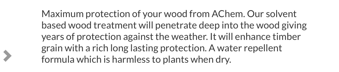

Thanks for the quick replies. The following is the product description from the site.
What I need is a replacement for that and it looks as though John D’s suggestion might just do the trick. Totally forgot about creosote but will give that a thought too.
Been on to tiger sheds and am told I need “an oil or solvent based preservative for smooth timber”.

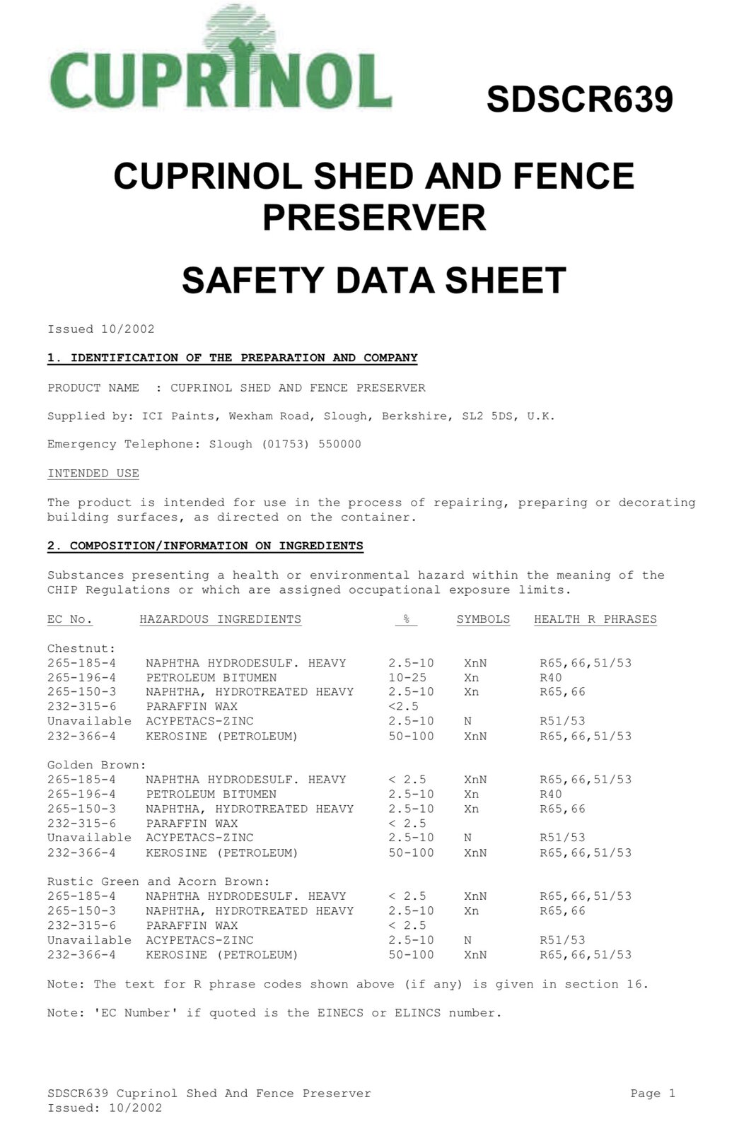

You'd have to read the specs. Look for the product safety doc.
I did and the following image is page 1 of a 9 page information sheet. I didn’t even know such things existed but I will read it through and follow any advice given. Thank so much for your input.
acypetacs-zinc is a fungicide to protect against rot. Paraffin wax leaves a water repellent coating. I can't see an insecticide listed to protect against woodworm. They usually contain Permethrin or similar. Maybe one is on a different page. The bitumen might be to add brown colour.
I think the other contents are solvents or diluents.
Wood preservers are intentionally poisonous, so the chemicals are usually listed on the container and safety documentation.
It helps you check you are not just buying a decorative stain.
