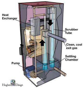

The main problem with solid fuel is one can't simply switch it off. So it must be able to work even with no electric at least until fuel burning has been used up, I saw this Hughes Condensing Stove 2 small.jpgsolid fuel unit, but when I wrote asking what happens in a power cut, I got no replies. So basic a ticking time bomb.
