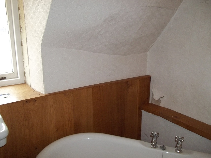

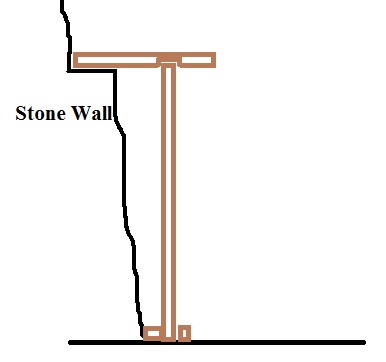

Provided the cavity behind the panelling is ventilated and the humidity in the room is kept under control then timber panelling should not present a problem. My panelling is American Oak oiled frint and back with Danish oil. 200mm wide and 10mm thick. Loose fitted into a slot under the shelf and retained by beading on the floor. Not shown are small spacers under the panels to raise them into the slot under the shelf. Using spacers was easier than cutting each panel to be an exact fit.
( wall yet to be re-decorated )

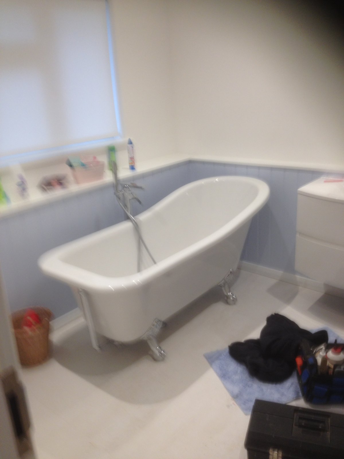

Most of the pre primed t+g mdf you can get is moisture resistant mdf, so as long as it's not sitting in puddles of water it's fine to use.
The light blue panelling in the picture is t+g mr mdf from a job I did about 4years ago, still do a lot of work for the customer and the panelling looks as good as the day it was fitted (the bathroom is in a 10yr olds onsuite)
