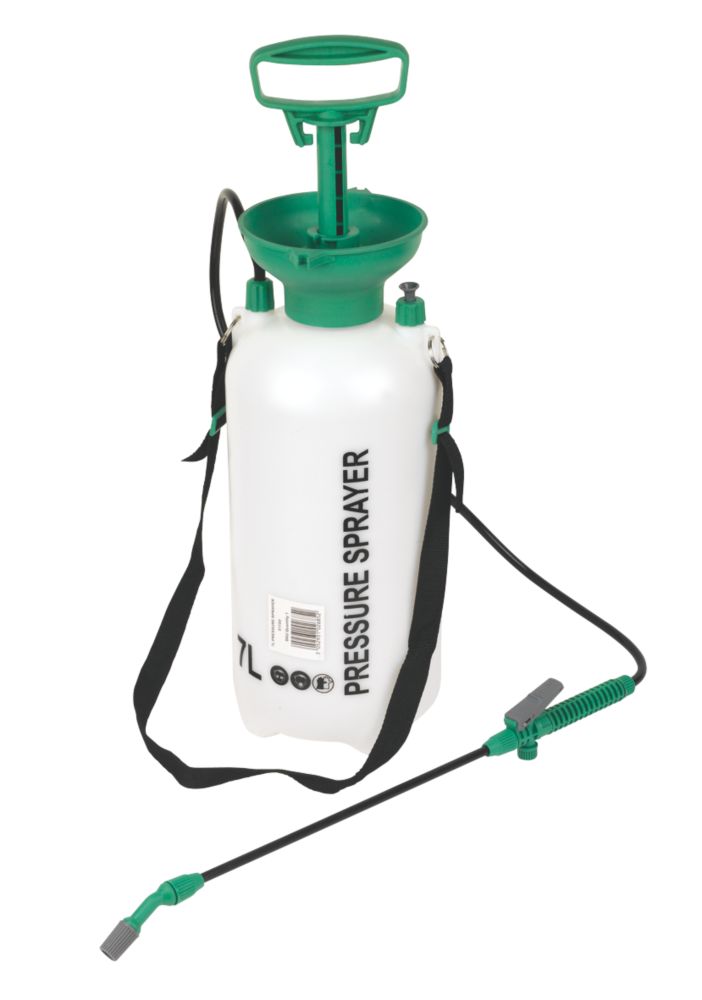

Thanks gregers for your helpful advice. I know you said that the ebay stuff could be water, but it's from a reputable company that has a 100% of over 27000 feedbacks from customers, so I guess I'll take my chances and have ordered a 5Ltr gallon to cover the whole loft. I've also ordered FFP3 respirator masks, so that I don't breath in the fumes. I plan to remove all the old insulation, then sweep the whole roof timbers down. Only once this is complete, will I start spraying. FYI, my friend has this sprayer, which I'll be borrowing:-
