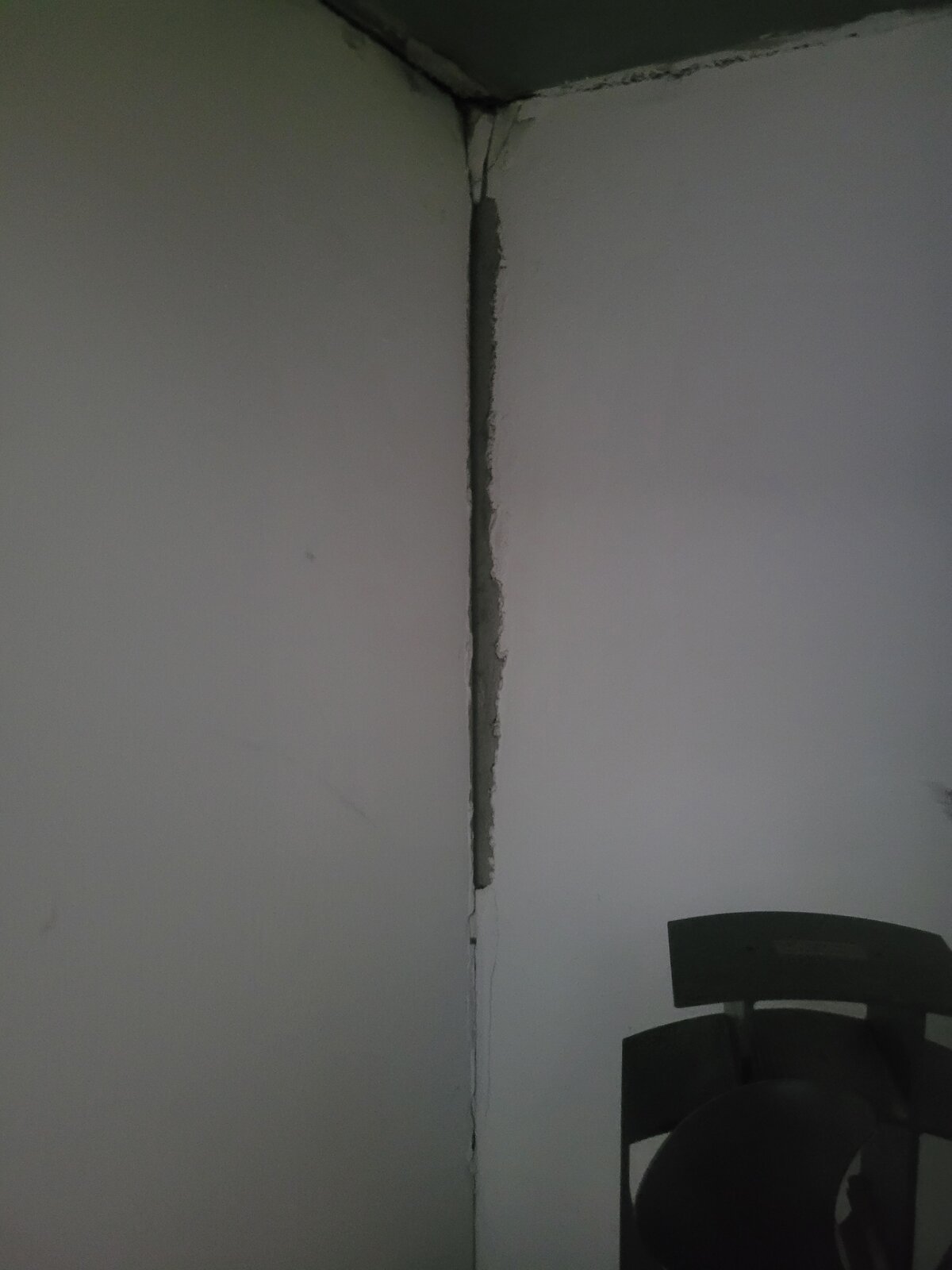

I'm needing some advice on our woodburner surround, the sealant around the backboard/side walls has cracked and some has come away completely (see photos) I suspect the incorrect material was used when the previous owners installed it.
What is the best sealant/filler to use? Or would it be best to take a different approach? We have limited funds at the moment but want to do a good job.

Remove the incorrect materiels and fit the correct materials.
Thanks Bonni, I'm planning on doing that and asking for recommendations for the correct materials to use. I've never had a wood burner before or fixed a fire surround before.

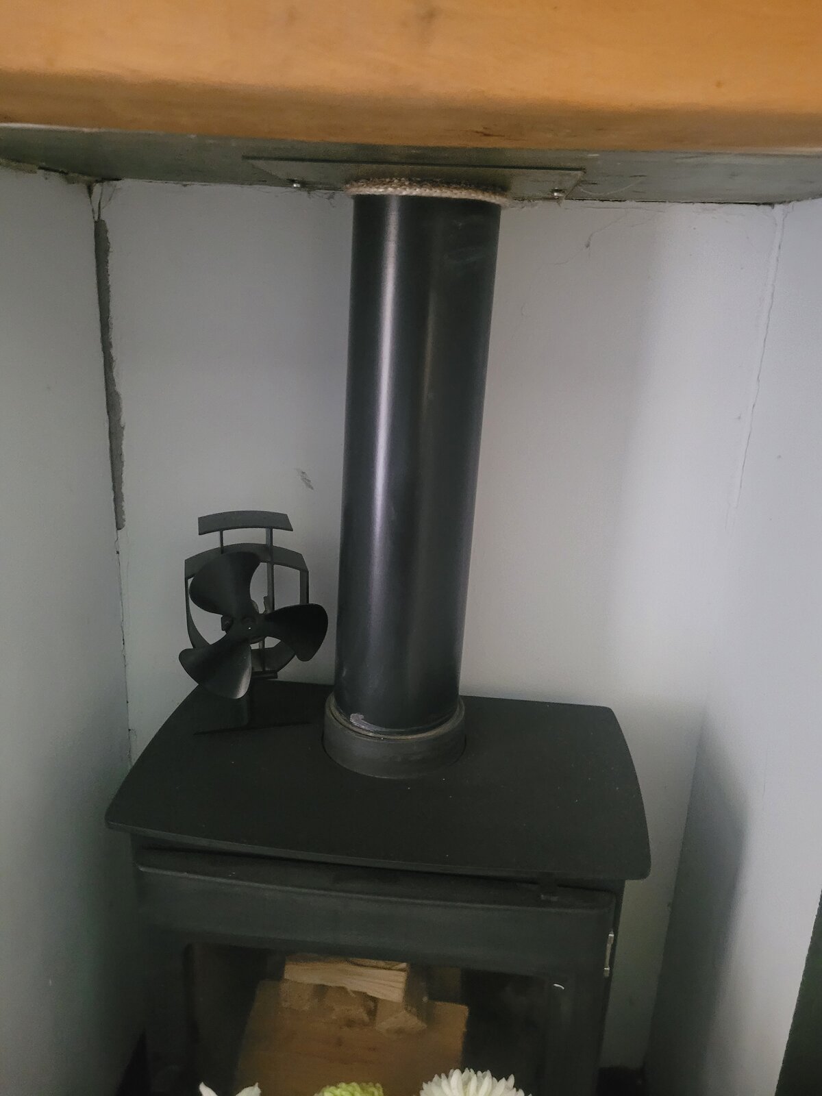

It's Wood

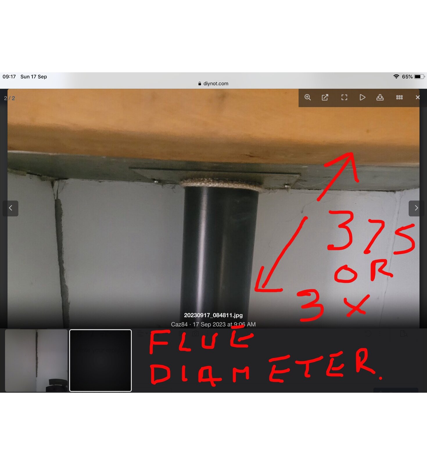

Then unfortunately it doesn't conform to building regs if that bothers you,which states that the flue pipe should be 3 x its diameter from combustibles, yours looks like a 125mm one

Looking at the OP's photo's, the gap between the heater and top board looks a lot more than 375mm.
Maybe the OP could take a measurement to check?

Its if any part of a single skin flue pipe is in the line of sight distance from the beam, with my own I had to extend the twin wall lower to give 450mm, 3 x 150mm, clearance from the beam or fit a heat shield to it
