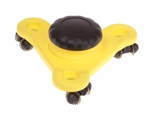

My house was built circa 1974. Almost every visible wall and ceiling has woodchip wallpaper on it. Plus they`ve probably been painted a few times to boot.
Ideally I`d like to be rid of it from ceilings and walls. It is a five bedroom property, so a fair amount of rooms would need stripping.
Unfortunately they`ve papered it directly on to the plasterboard. ARGGH!
I`m aware of various techniques to get woodchip paper off of plaster eg soaking, scraping, scoring, elbow grease. However, on the few test patchs we`ve done, the paper of the plaster board is also coming away places.
So, any good advice for when you`ve not got plaster underneath, just plasterboard?
Wallpaper scorer and steam stripper.
ae235
I think those are exactly the scorers and heat steamer that we have!! Problem is, it's soaking and scoring the paper on the plasterboard underneath too..
I don't think you have an easy way out of this am afraid. Polycell's SmoothOver springs to mind, but it doesn't get good reviews, and is very expensive. Probably cheaper to get a plasterer around and do one room up properly at a time. Sorry you moved into a house where folk had bad taste!
Yes I agree this is probably going to be a long term expensive and messy project. I think they may have had good taste back in the 70s...possibly. They just committed themselves to it for the next 40years! You never know, maybe it will come back in fashion...
When people on this forum have talked about overboarding, does this mean jus putting plasterboard on top of the woodchip? Or does it mean removing the old plasterboard and replacing? Not sure which would be easier but the former is going to cause probs with things like door surrounds I'm guessing?
Yep over boarding is going straight on top. You could try zinsser DIF and also try a garden pump sprayer to soak the walls, but really damage is unavoidable so as said above getting it skimmed once the papers off would be best. A coat of zinnser gardz over the damaged plaster board will seal and bind it and you can then fill if you want to go down that route.
