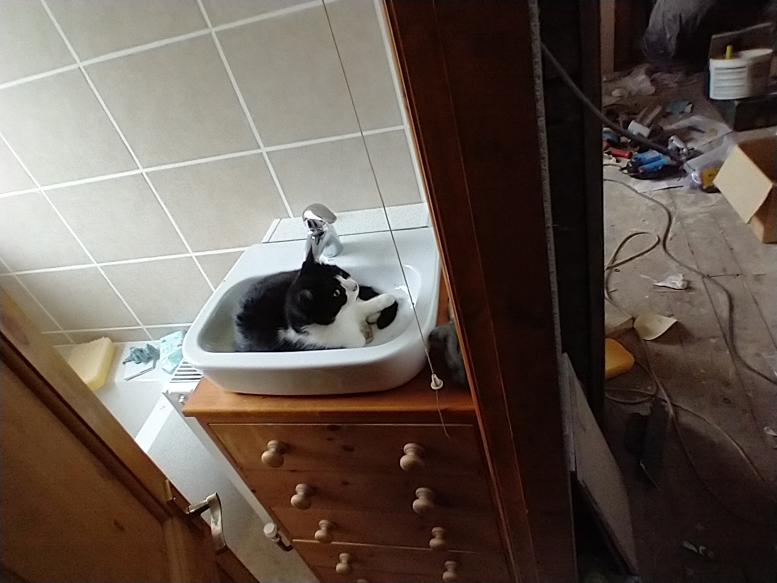

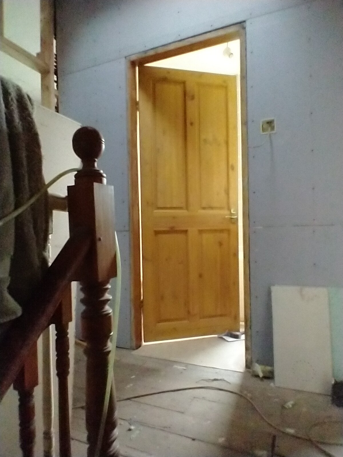

Mmm. Not sure about that...actually it's not as bad as I thought, there'd still be about 500 clearance to the newel. Have to leave the door ajar for madam ...

Open outwards for me :)
Although (especially as the wall is at plasterboard stage), you could go for a slightly narrower door?
open outwards.
