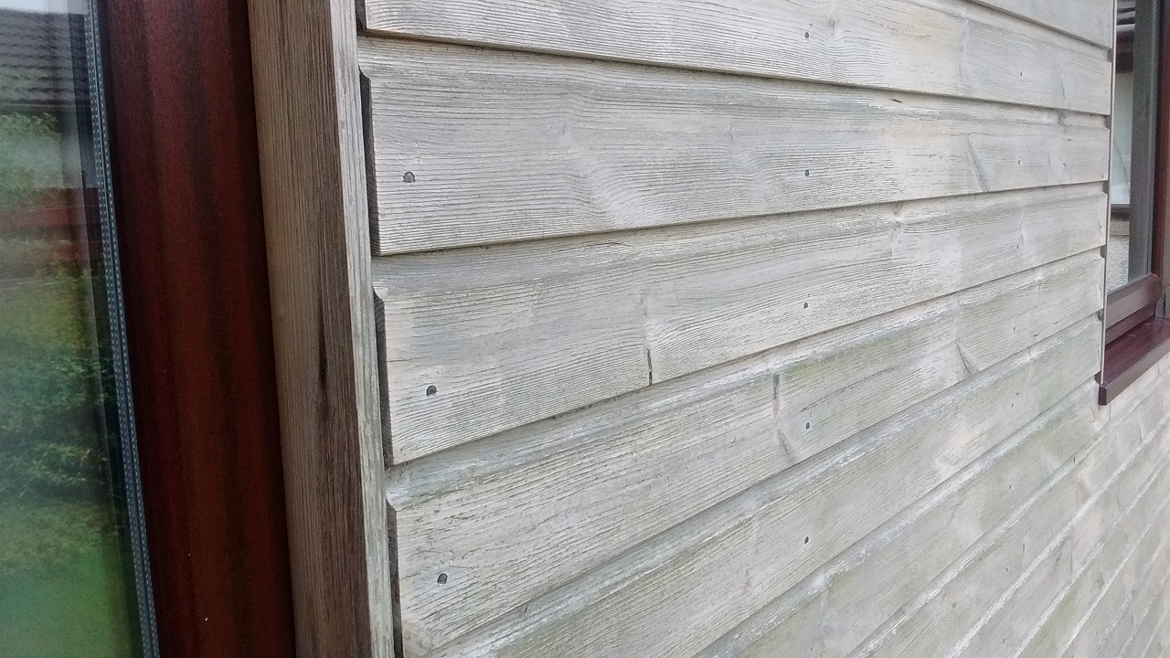

Hi. My extension was made with heat treated wood that's supposed to last for 20-25 years. It's now 11 years old and looking a bit dry. I'm not sure what's best to paint it with - hopefully just a water-based, clear, wood preserver. Any hints, tips and advice would be welcomed. Thank you.

Is my picture enough to allow anyone here to say whether I need a treatment or not? And if I do, any suggestions as to the best brand/type of stain?

you seem to have shiplap. On mine, I previously mostly used a water-based shed-and-fence stain, but I blasted that off a few years ago with a power washer, and treated with linseed oil which seems to be lasting well. I used a spirit-based wood dye first, to try to blend it in with nearby "mahogany" stained doors.
On sunny days, it smells pleasantly of cricket-bats. You have to apply it thinly and not let it lie on the surface. Rub off excess with a rag if it has not soaked in after ten minutes, or it will go gummy.

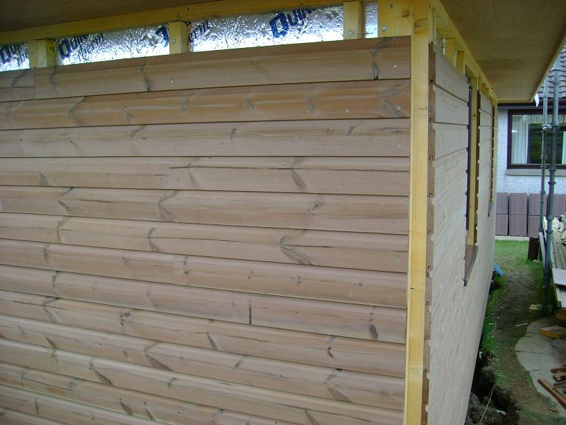

The end grain and knot formation suggests it is scandinavian redwood (pinus sylvestris).
It could well be thermowood -if it is then you could leave it natural weathered grey as it is.
UV from the sun kills off any lignin in the wood surface, so a stain is needed to provide new colour.
As John says avoid the cuprinol ducksback type stuff, it sits on the surface.
If you want to stain to put some co,our back in, I would recommend
Its sprirt based but pretty low odour.
https://www.barrettinepro.co.uk/25/266/nourish-and-protect-wood-protective-treatment
Also available from toolstation.
Certainly natural oils like linseed work, but they dont have UV protection so they tend to get burnt off quickly.
Another great reply - thanks, Notch. You know your wood, it seems, so if it helps to confirm what I've got, here's a pic of it when new:
