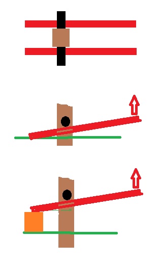

Hi all, have a 6"x 6" wooden gate post rotten at ground level and broke away. apart from removing old rotten post in ground are there any other ways to refix it so it can be used. The gate can be hung on the other side. Thanks for your time and input!!

You can pull it out by putting a big screw in the post that's left in the ground, then lever it out with a crow bar or similar.
A long drill bit will also help give you some more space
Quicker than trying to burn it out, and you do need to get rid of it for it to be useful again
If some of the post is above ground, you can drill a large hole in the side, insert a crowbar & lever it out, like a fulcrum
Two levers one each side of the post will give a near vertical lift.
Any sideways pressure will press the post against the sides of the hole and make extraction harder
Add blocks to keep the levers as close to horizontal, reduces sideways pressure on the post.
