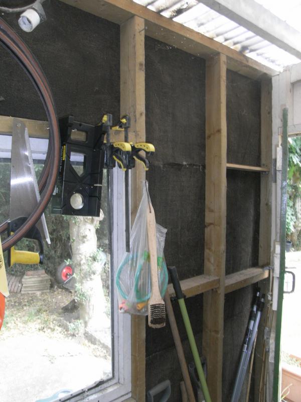

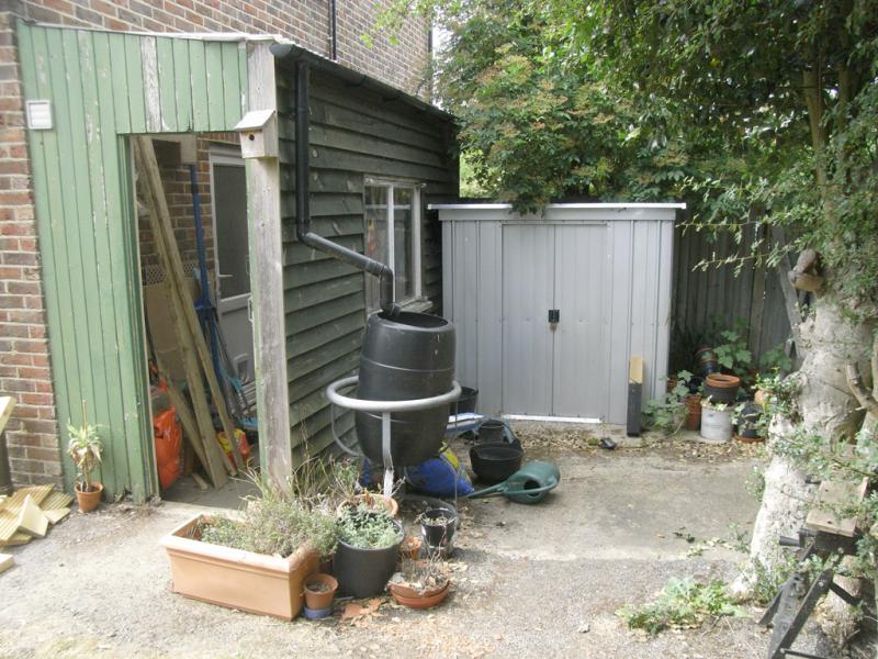

My house has a rather tatty wooden lean-to shed which I'm thinking about tidying up and extending as it doesn't currently offer much usable space.
It has been rather crudely constructed from 4x2 timber, roofing felt and corrugated plastic roof panels.
My plan is to dismantle the current arrangement and move the front wall back by a couple of metres, past the line of the metal storage box (which will be removed)
There is already a thick base of concrete laid which was probably a garage floor in the past.

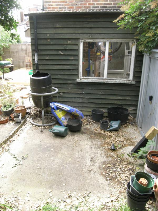

the bricks will keep the bottom of the wall out of the puddles..
since it's on a flat concrete area is it likely that water will pool in areas and not drain away?

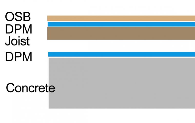

I have now cleared the concrete area and have drawn out some plans.
I'm wondering whether installing two layers of DPM is necessary - one will go directly on top of the concrete, and perhaps an additional one on top of the joists, underneath the OSB board - see the attached pic.
Is this overkill perhaps? As you can probably tell by this and my original post, I'm really keen to keep this shed dry and as rot-free as possible!
