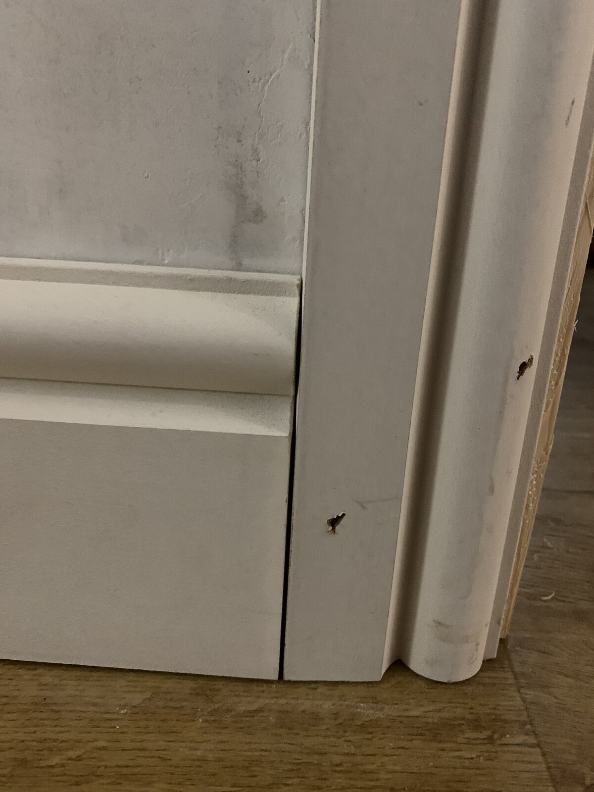

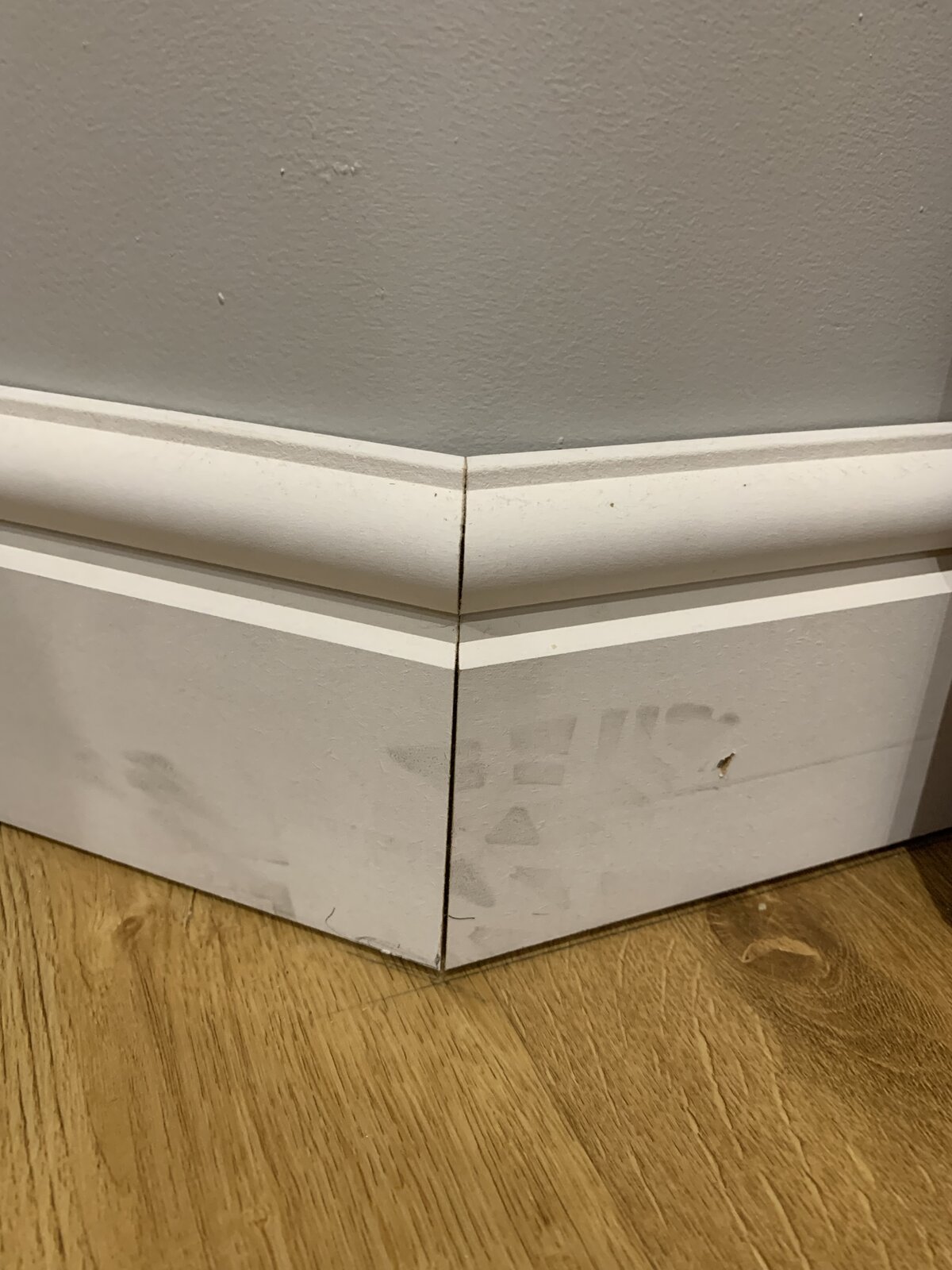

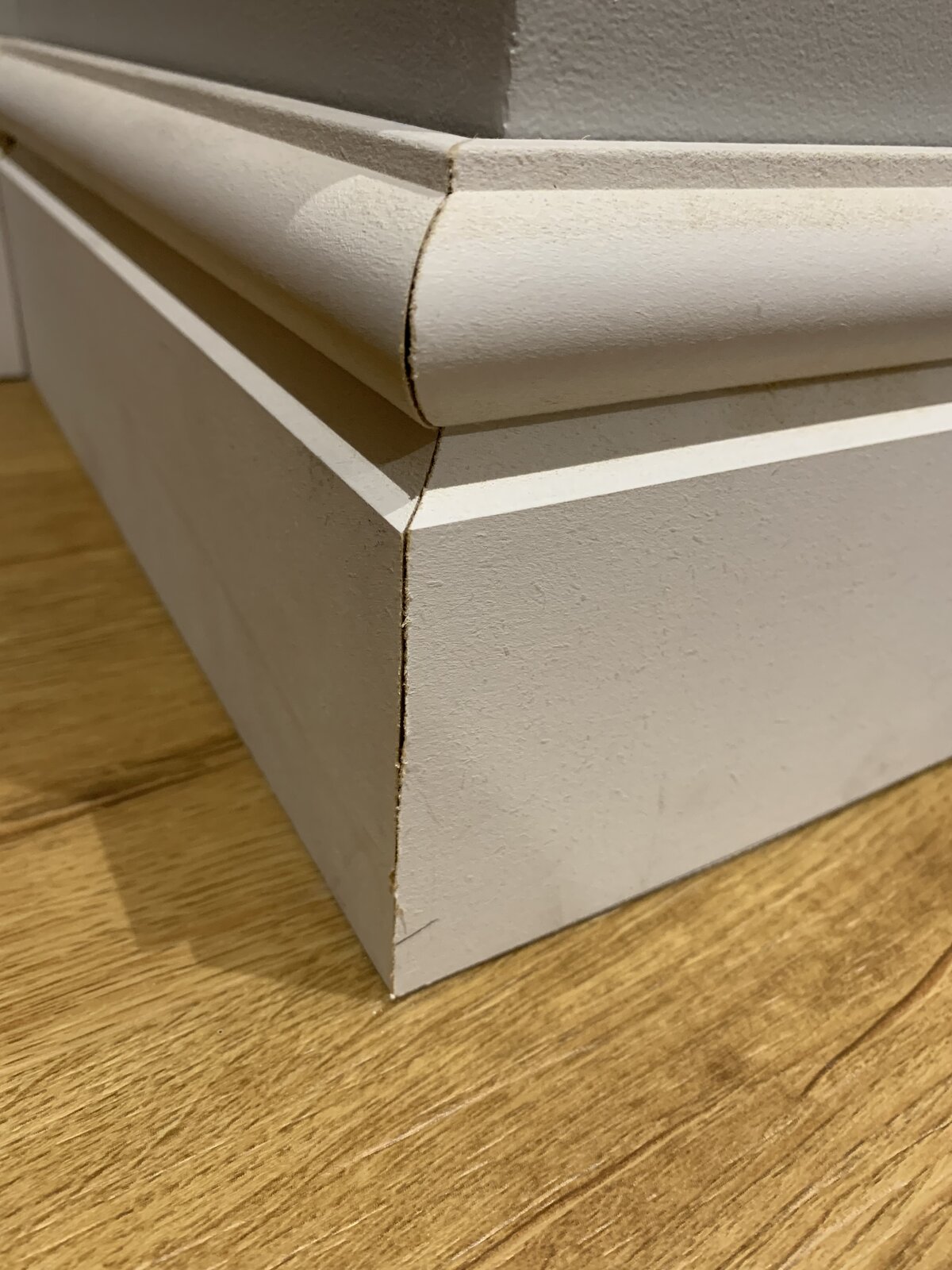

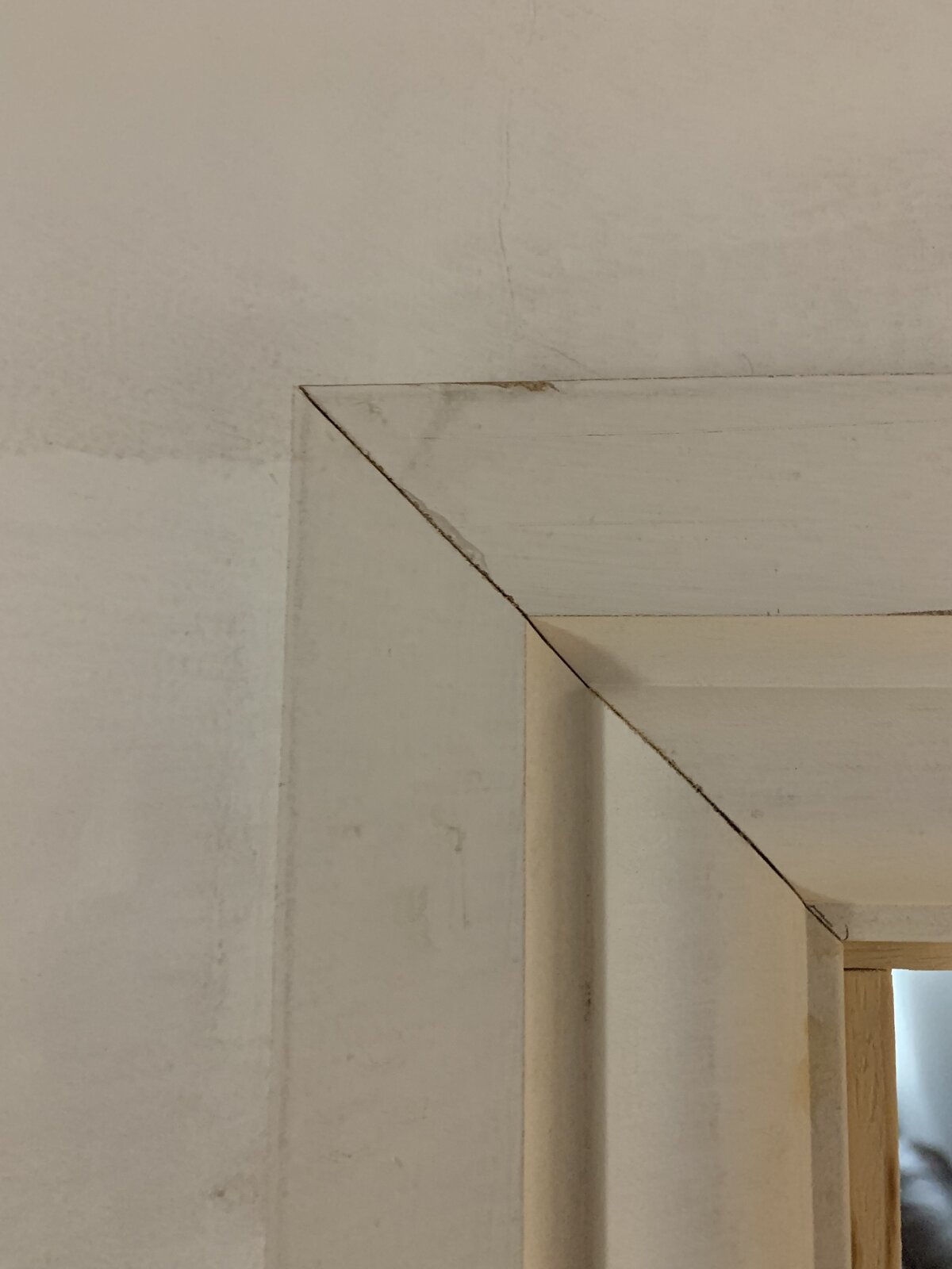

I am just wondering whats best to fill the join lines, just a line of Chaulk or wood filler, see attached.

I've seen a lot worse.
If my eyes are still functioning, that's mdf, so caulk is fine.
Use a good flexible one, geocel is my favourite.

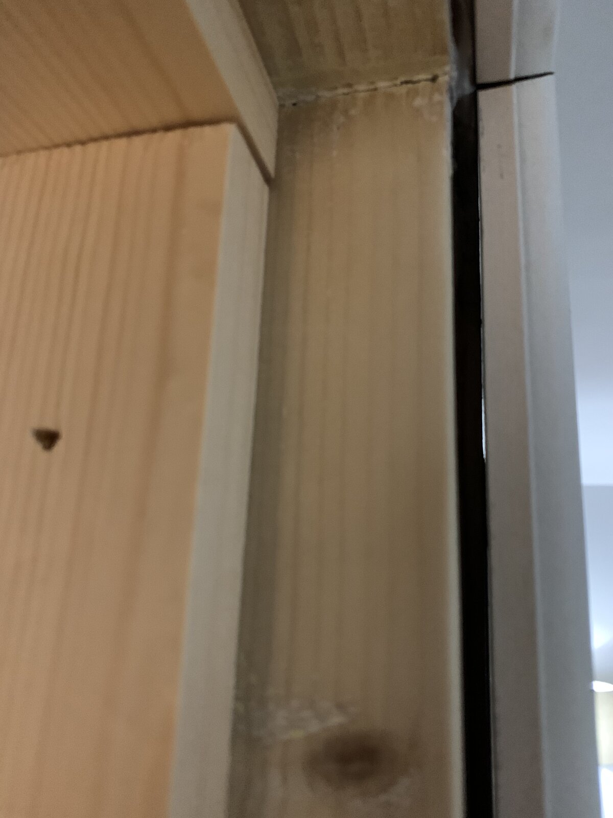

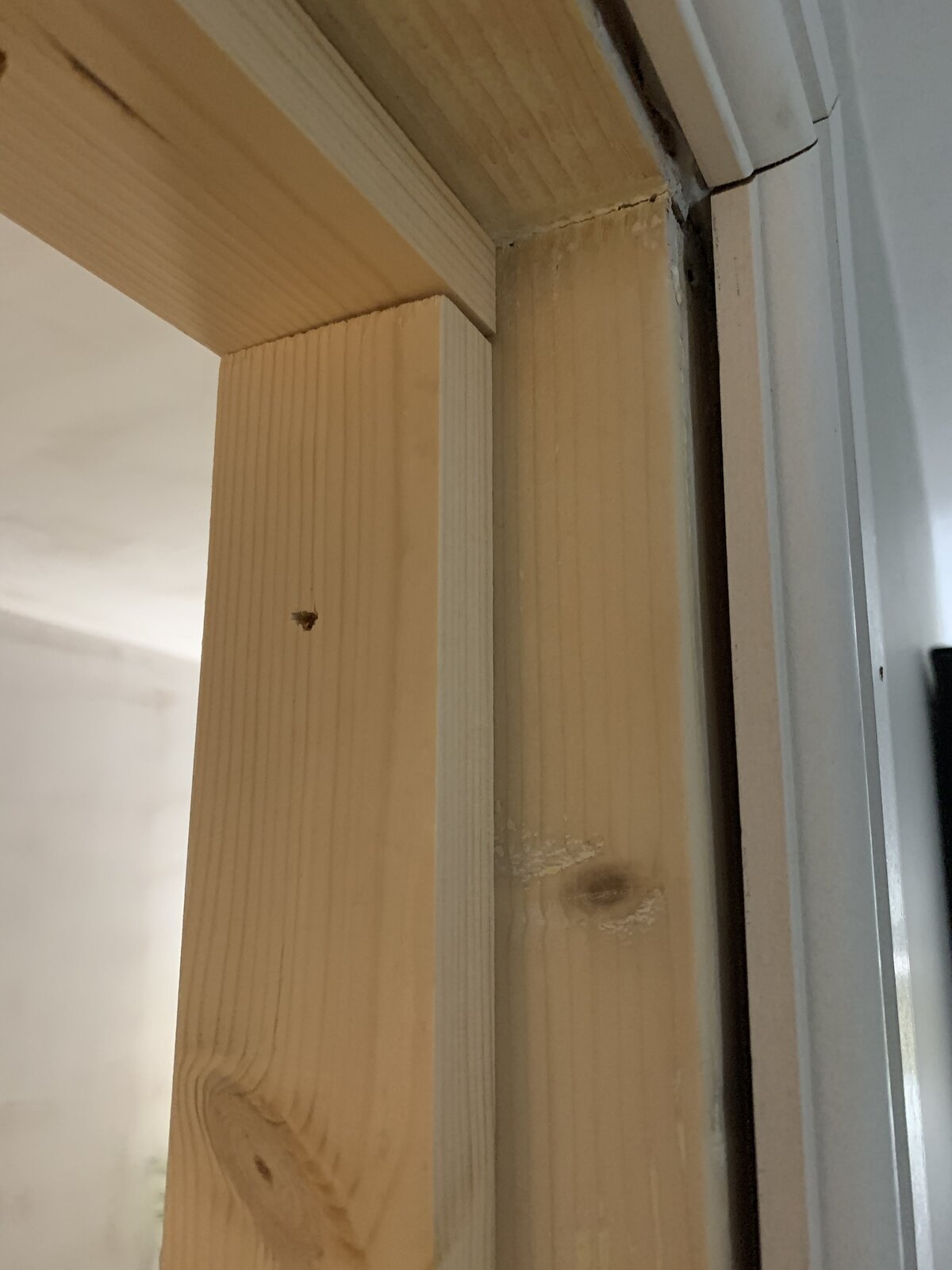

There is another couple areas around the architrave that have gaps, this was down to the old walls and the re plaster being a few mm’s over the old door frames
Any suggestions to fill these? The is by far the worse one.

Caulk for everything except the nail holes.
Prime bare wood before caulking.
The big gaps between the door lining and architrave - these are a bit on the big side. They should have fitted thin strips of wood to the lining before fitting the architrave. A big gap like that may keep opening up over the years unless there is some wood fitted as described above.
You could squeeze in some no nails as long as it doesn't protrude onto the edge of the frames.
Try and get your caulk nice and smooth when it's wet as it's quite difficult to sand down! You could use a wet sponge.

yes chauk on the skirtings, there will always be a bit of movement with expansion contraction.
